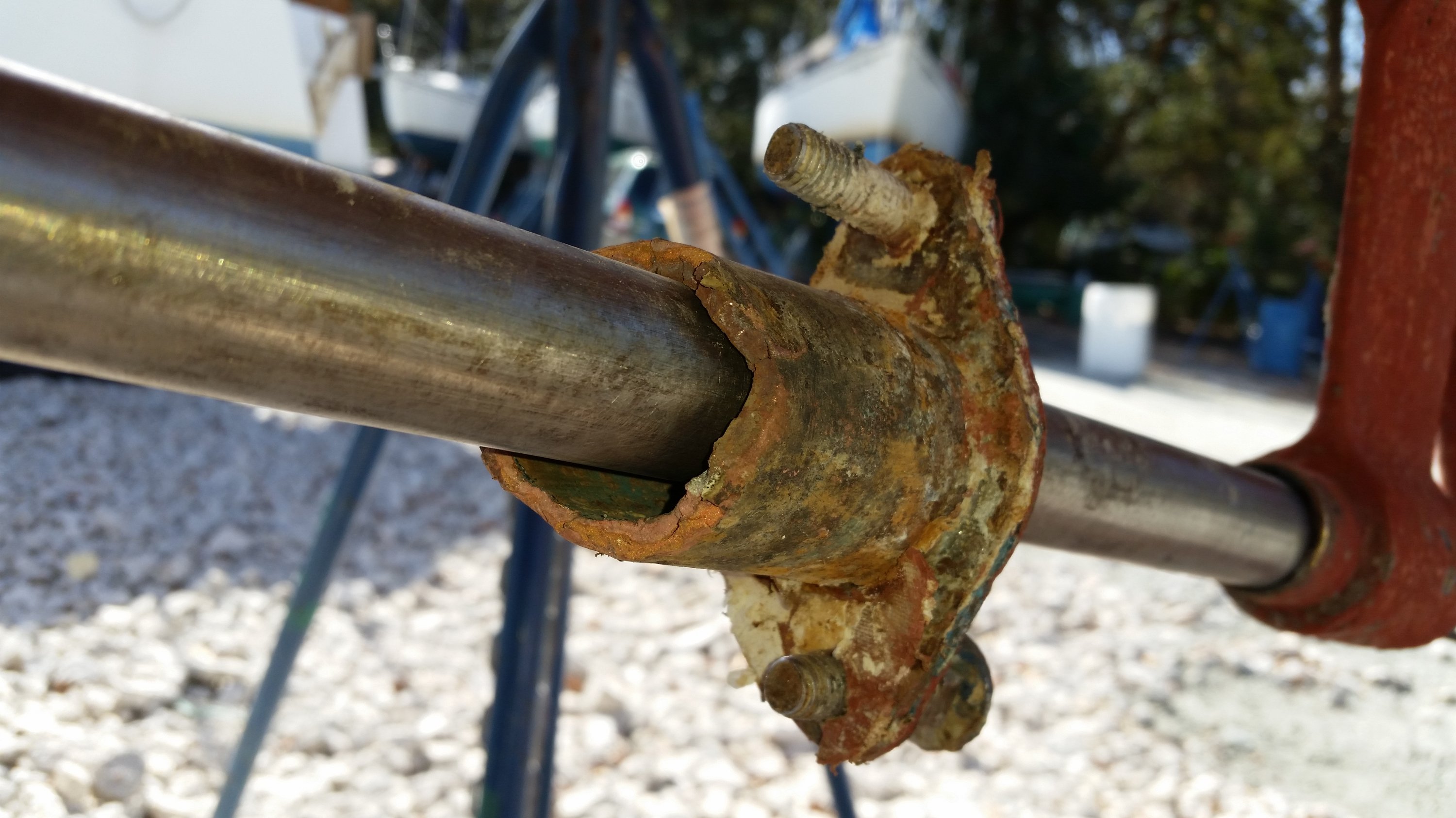

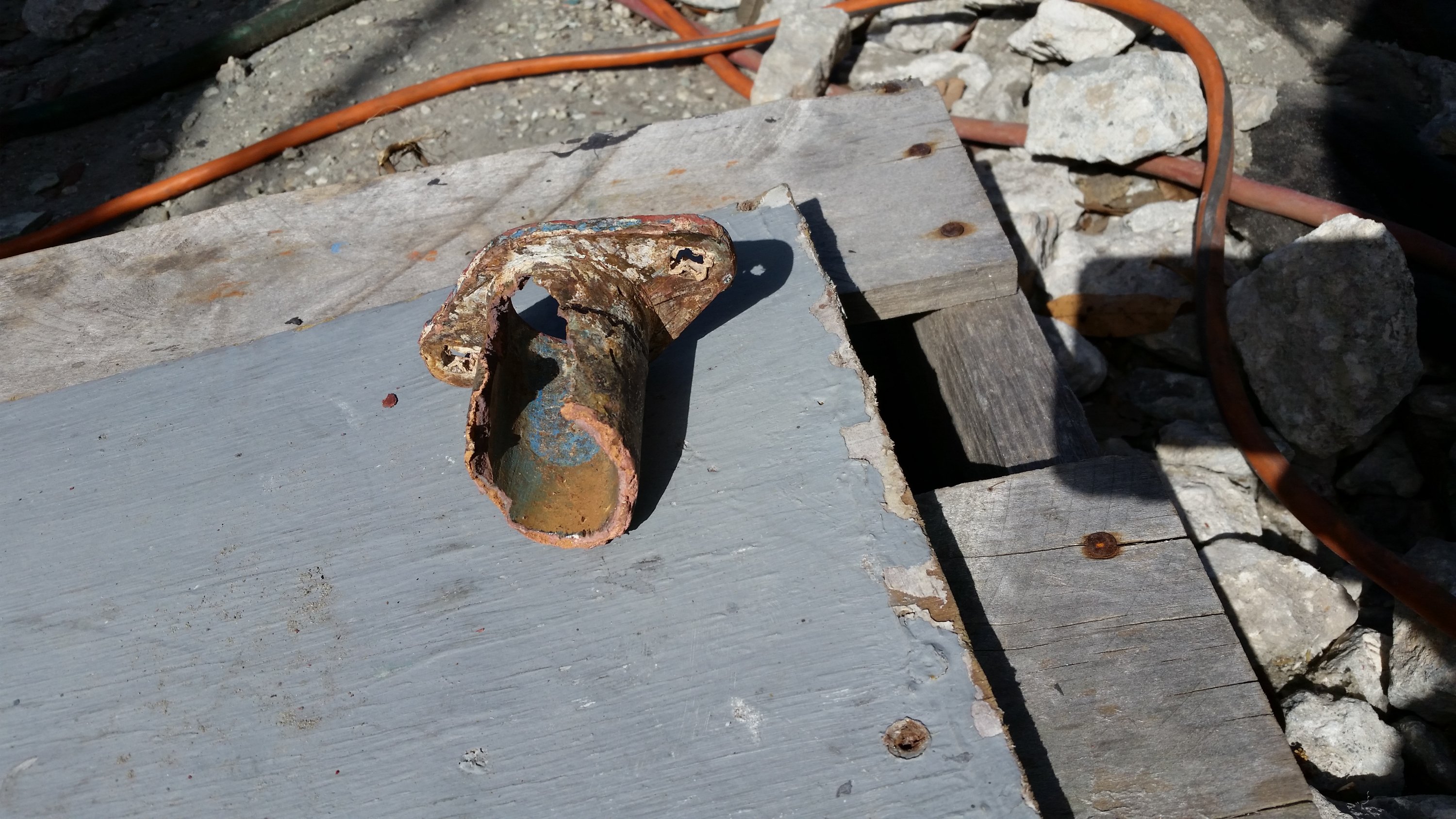

I hauled my Hunter 27 this spring to install a dripless seal and found that the shaft log needed replacing. So off comes the coupler and strut. Seemed easier than dropping the rudder. No problems getting the strut off. Rebedded with 5200. Here is a pic of the shaft log. Looks much the same as the one that Black Pearl posted. So I'm thinking that corrosion on the bottom side of bronze shaft logs of this era is not uncommon. Easy to check on your boat (when out of the water) by loosening the stuffing box friction nut and two hose clamps and pulling the hose
off the log. If you see any pink metal try taping that area and see if it chips off.
