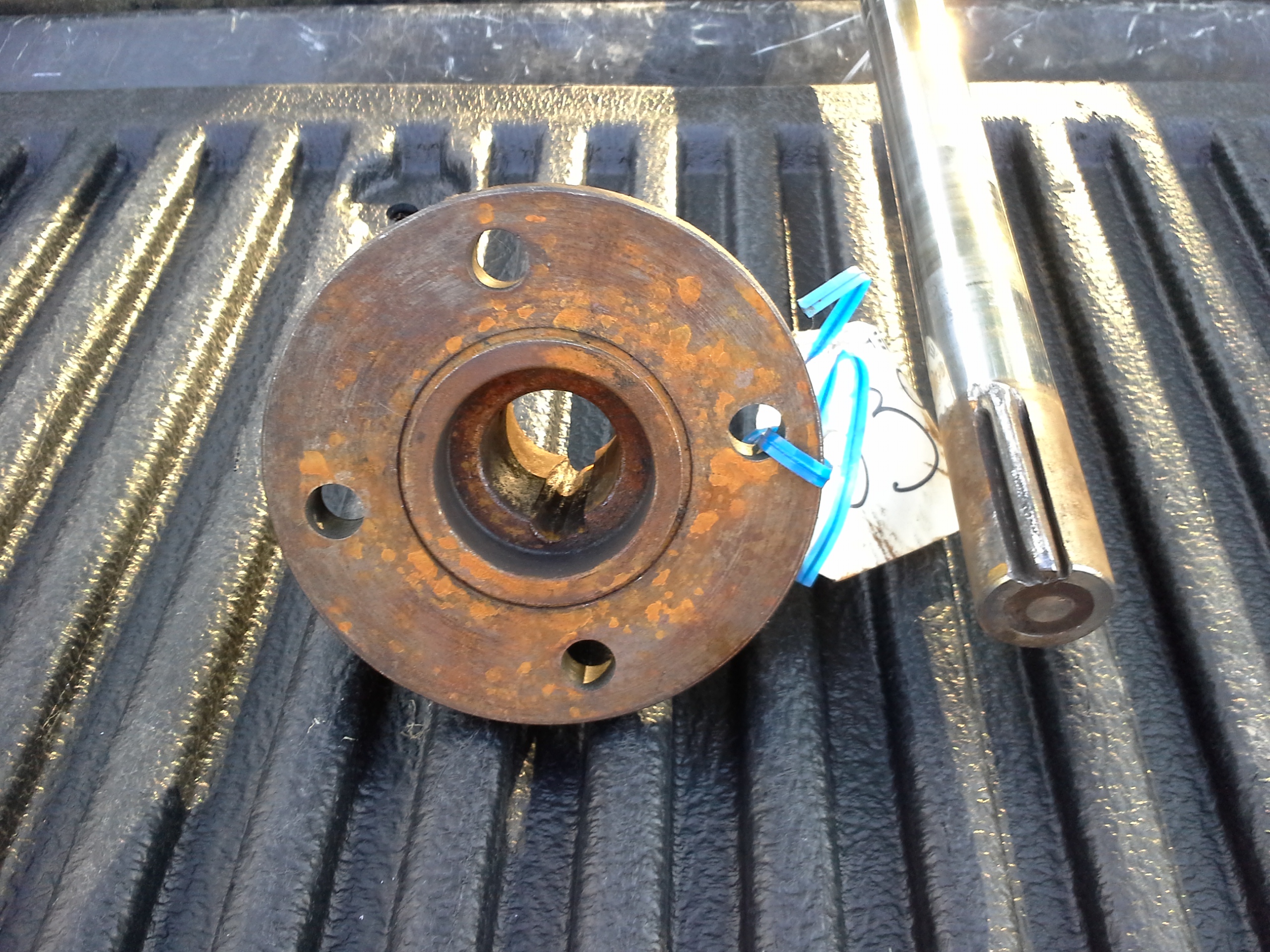

Thanks JW. That's another thing I'm concerned about. The possibility that the shaft is out of alignment driven by the fact that the cutlass is really very badly worn.... What do you look for to see if there is excessive wear at the coupler? I have not studied it yet but it looks like the prop shaft side of the coupling does not move in relation to the engine/tranny side of the coupling. I don't think there will be any wear here... But like I said, I did not study it and have no experience with these type of couplings.

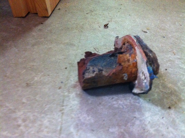

Here's a pic of excessive wear at the coupler. Note the hogged out keyways and what's left of the beat up key on the shaft. This came out of my boat this summer. The coupling loosened up, and after I tightened things up, I noticed a lot more vibration. When I rotated the shaft by hand you could literally see the engine move up and down more than an eight of an inch. The previous owner of our boat replaced the PSS seal on the boat without replacing the coupler with a new one. It was probably worn when he reused it. It's much smoother now, with a new shaft, coupler, and cutless bearing.
Thank you so much!

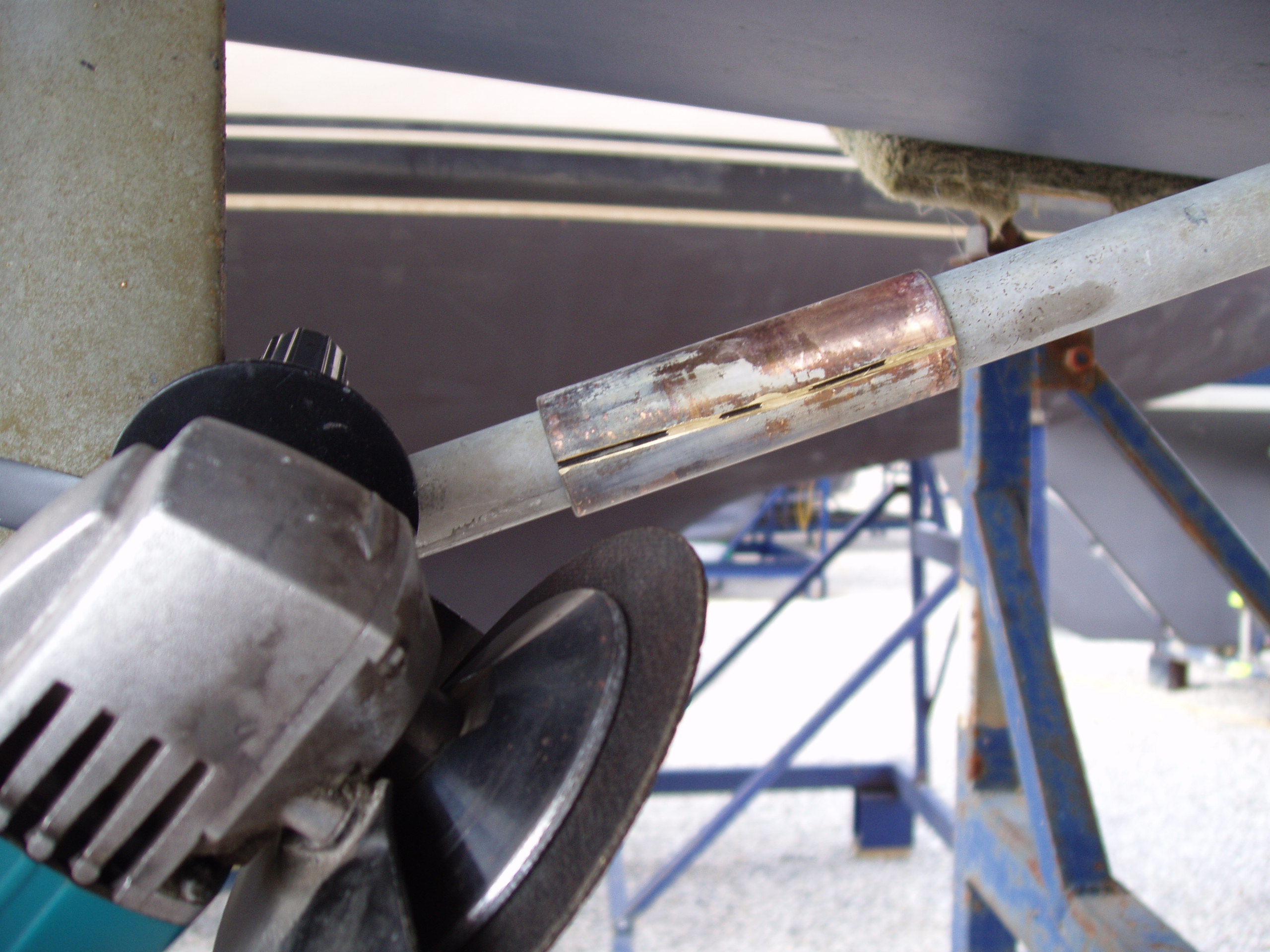

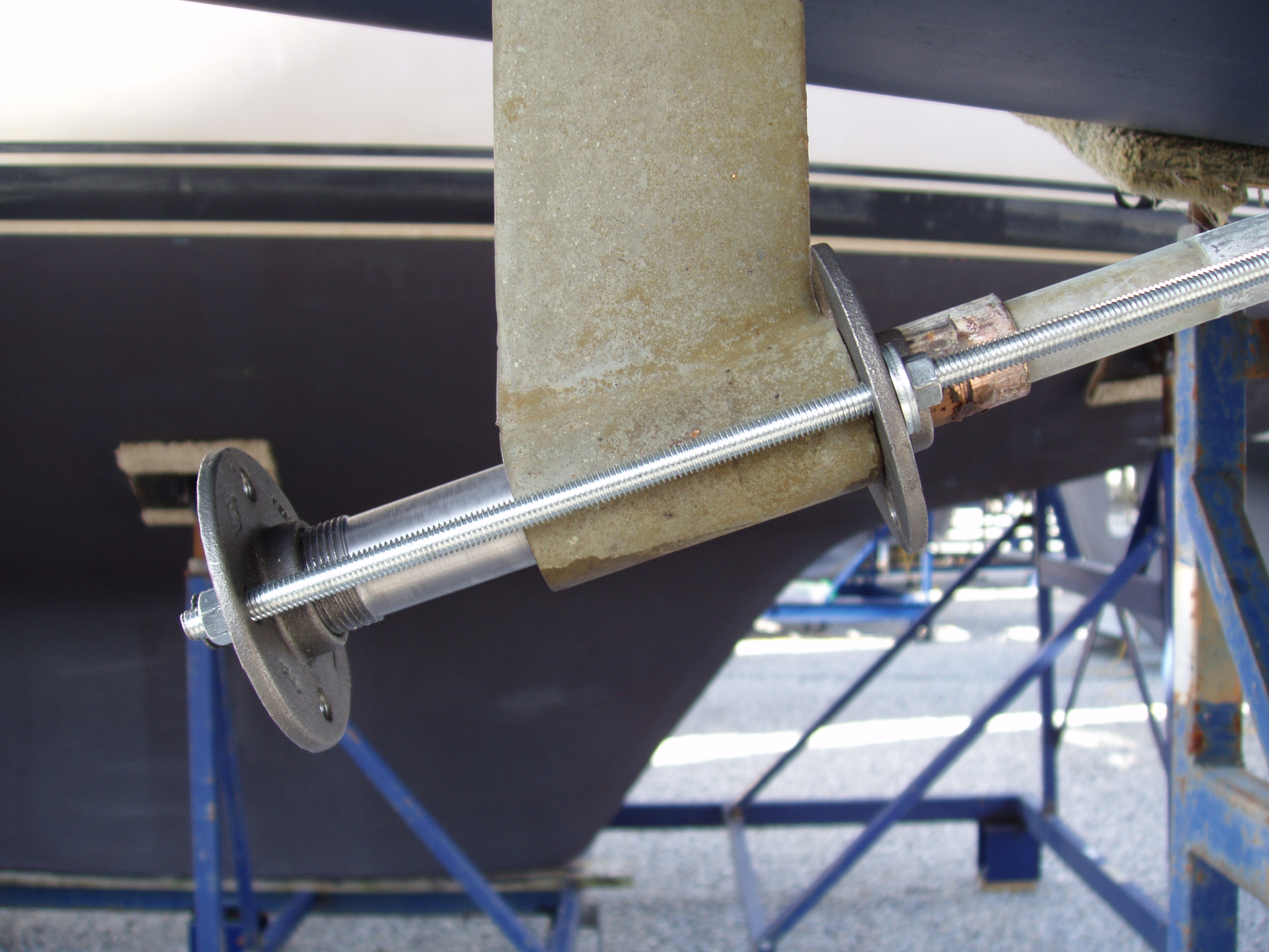

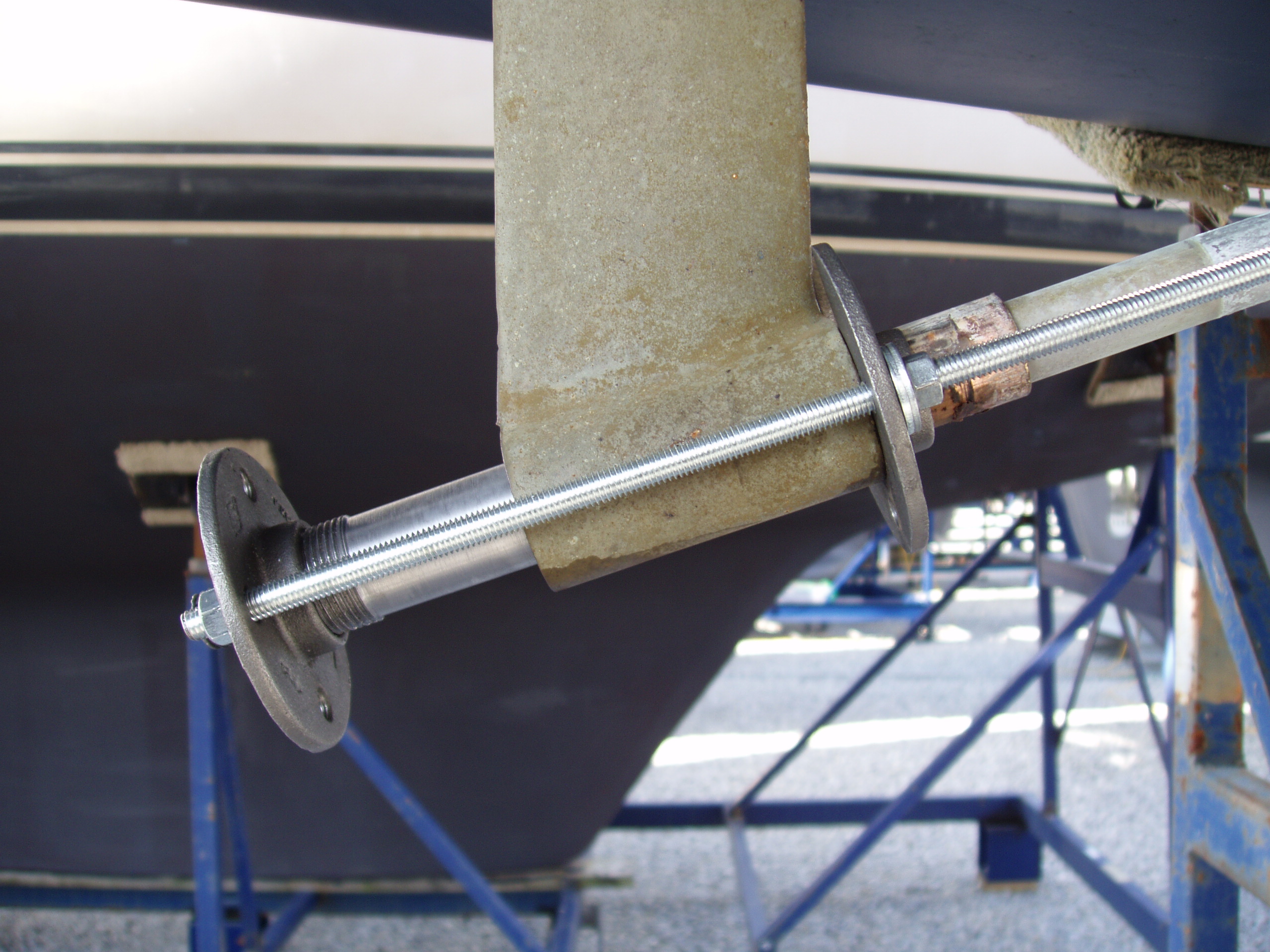

My major in college was Physics so 25.4 mm == 1 inch so both systems work, When in Rome do as the Romans do.
I had a piece of 1 inch ID water pipe turned down to about .030 under 1.25
with the prop off and a heavy cast iron fitting in front of the strut to take the impact just smacked the bushing/bearing out.
Installed a plastic bearing. No problems, vibration or leaks. The estimate for the yard just to remove the bearing was way too high.
Removing the strut just to replace the bearing seems like a very bad idea.
Sep 25, 2008
1,096
CS 30 Toronto

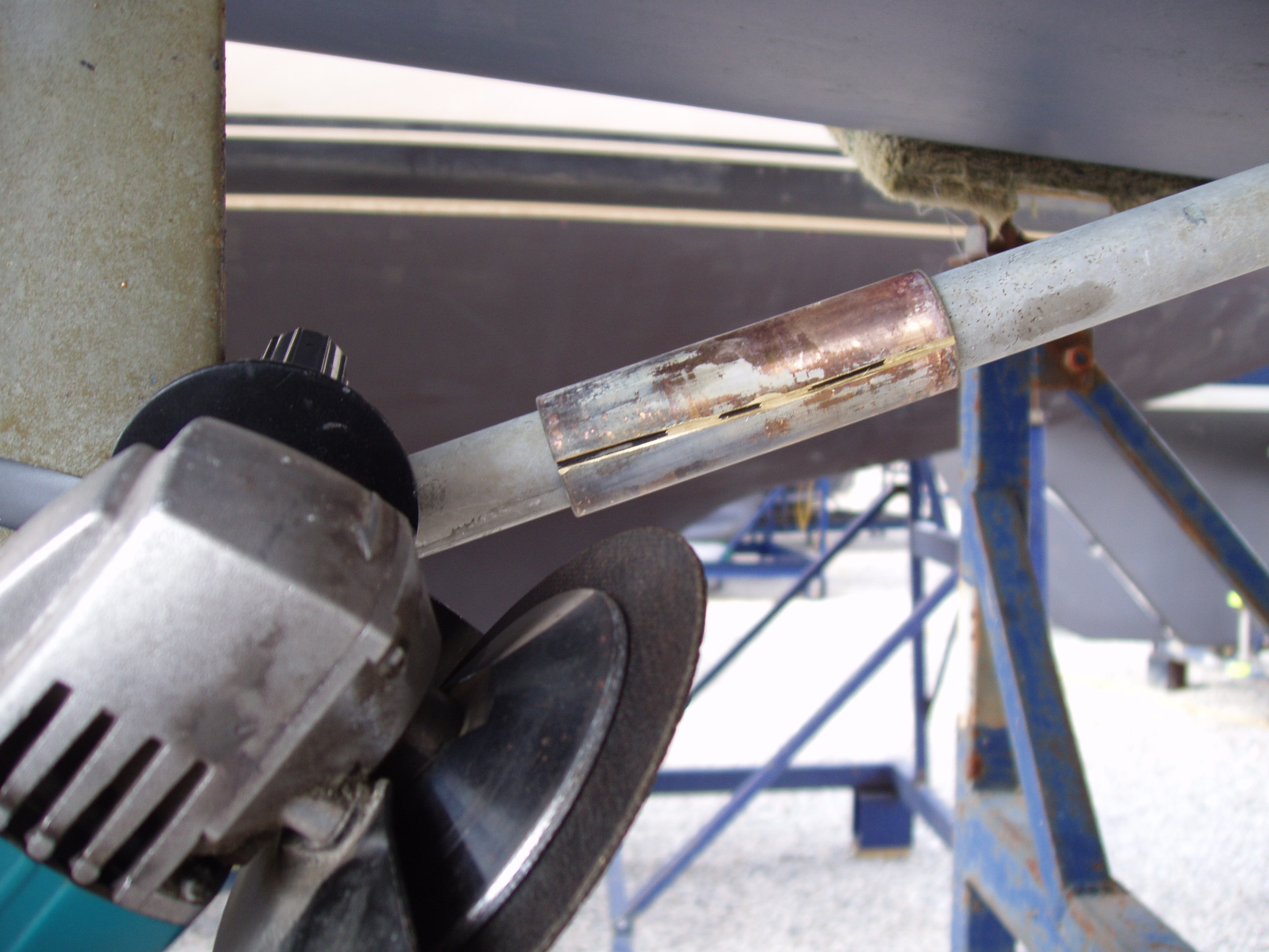

I did not slit the pipe. I just made a tool with black iron pipe and push the old bearing in. Then use a wheel grinder with cut off blade and slit the old cutless bearing apart.

View attachment 117387 View attachment 117388 I did not slit the pipe. I just made a tool with black iron pipe and push the old bearing in. Then use a wheel grinder with cut off blade and slit the old cutless bearing apart.
I was wondering if there is a reason why you cannot just push it forward... Seems there is none. Like your idea. Less parts, less chances of something going wrong. Thanks for the advice!

Alexco, Could you have pushed the bearing outboard instead of inboard to save you the trouble of cutting the bearing apart?
Likes: All U Get
Jan 7, 2011
6,002
Oday 322 East Chicago, IN
I don't think you can, unless you use the split collet...no way to get the "pusher" on the shaft in front of the strut if it is in one piece.
