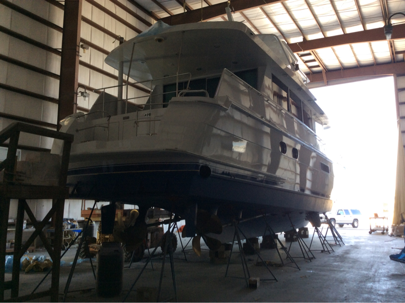

(My latest project)...

It gets worser. A couple of years ago, I was sweating, bleeding, hadn't eat all day, bustin my tail to finish a boat; with no need for a job anyway. I sent lovely bride a text saying something to the degree of "I MUST be pathologically insane!" She says, "yes dear...yes you are." (My latest project)... <img src="http://forums.sbo.sailboatowners.com/attachment.php?attachmentid=79860"/>
is that a Defever?

You know Jibes, it certainly does look like a Defever, the pointed bow, itty bitty forward windows, etc. but it's a Hatteras, with a weird camera angle. By gosh the picture looks it though..
This is a Miami Boat Show half price special. I think I remember it coming in at 2.7 or thereabouts. The final fit out, yea!!
