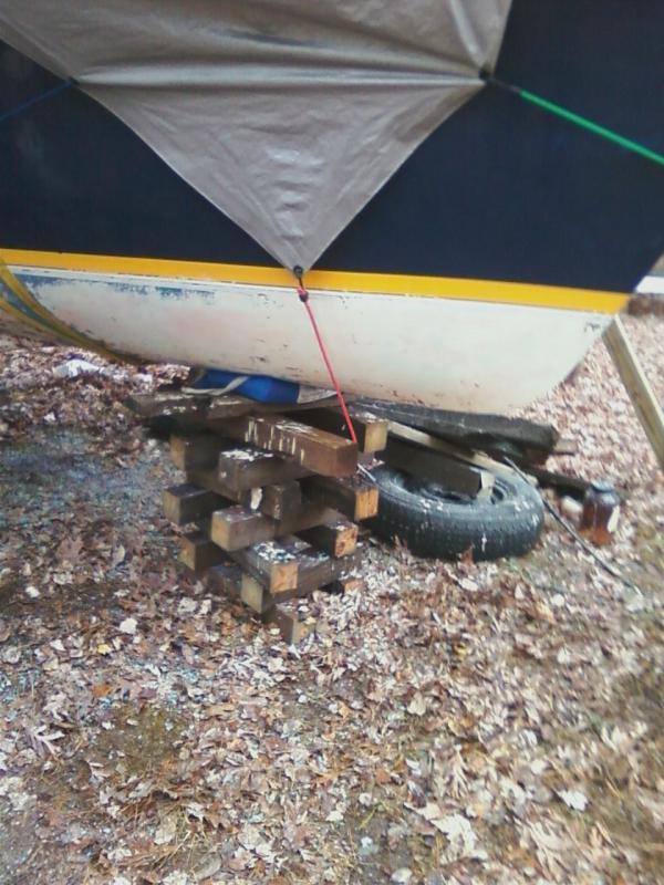

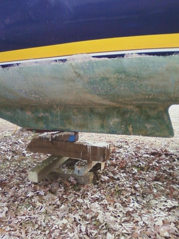

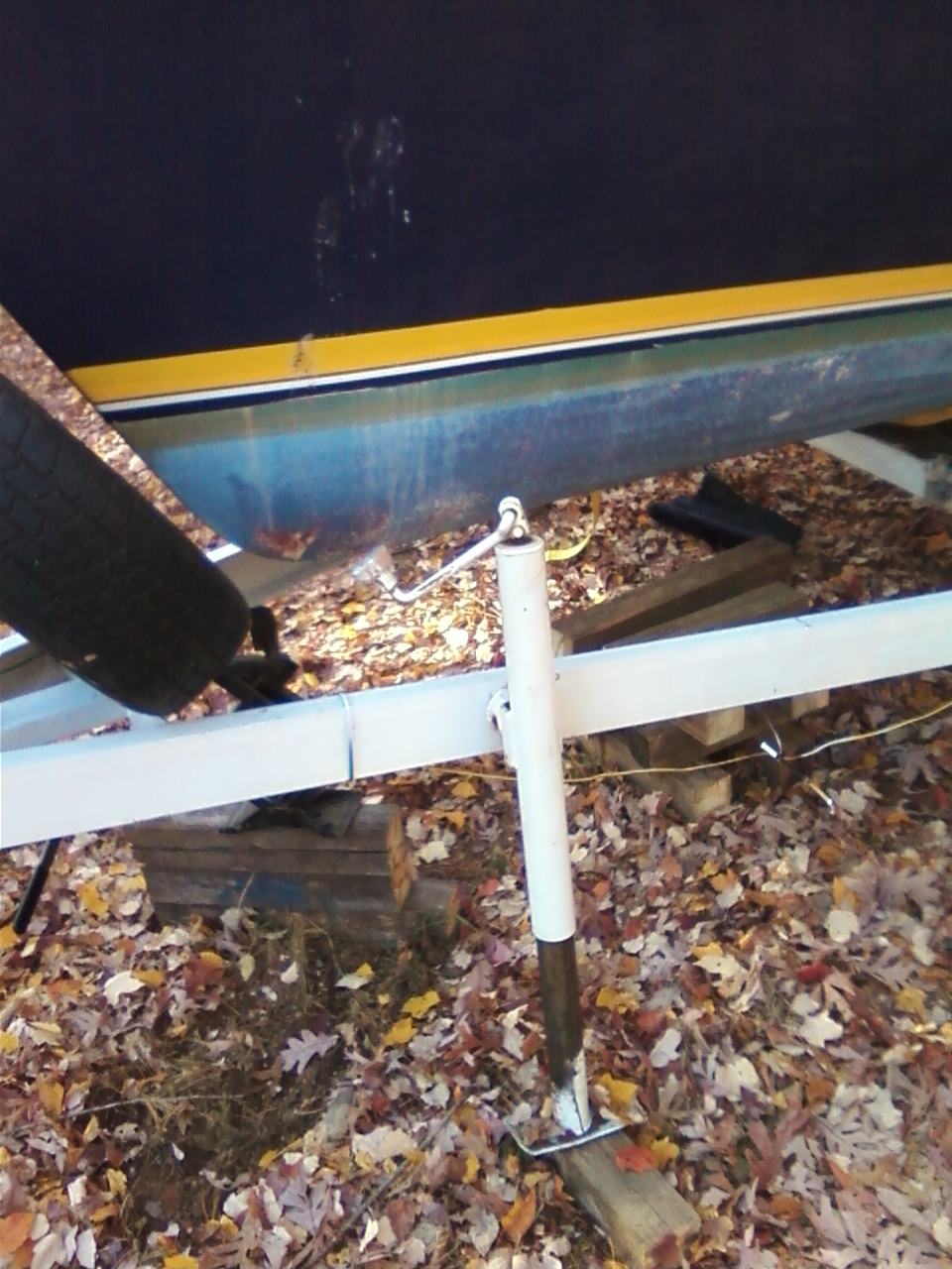

Here are three pics.... the first is the before... the second shows the dry paste on the hull... and the third is after a pressure wash. You can see a few spots that did not sluff off. I just did it a second time. Every now and again, you will end up with one or two spots that just "stick"... I hit those with a little citrus strip and use a putty knife edge to get the last bit off.
