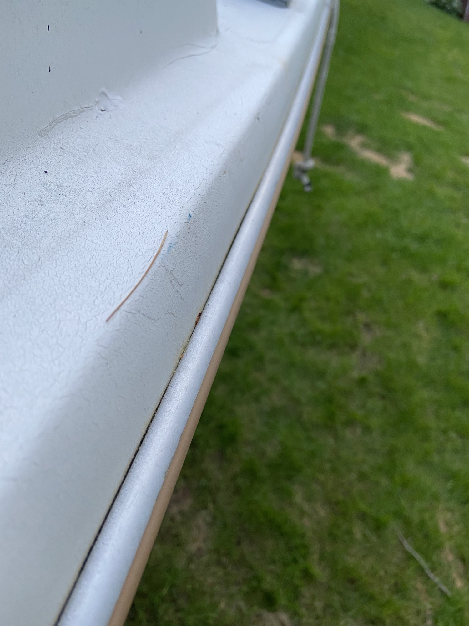

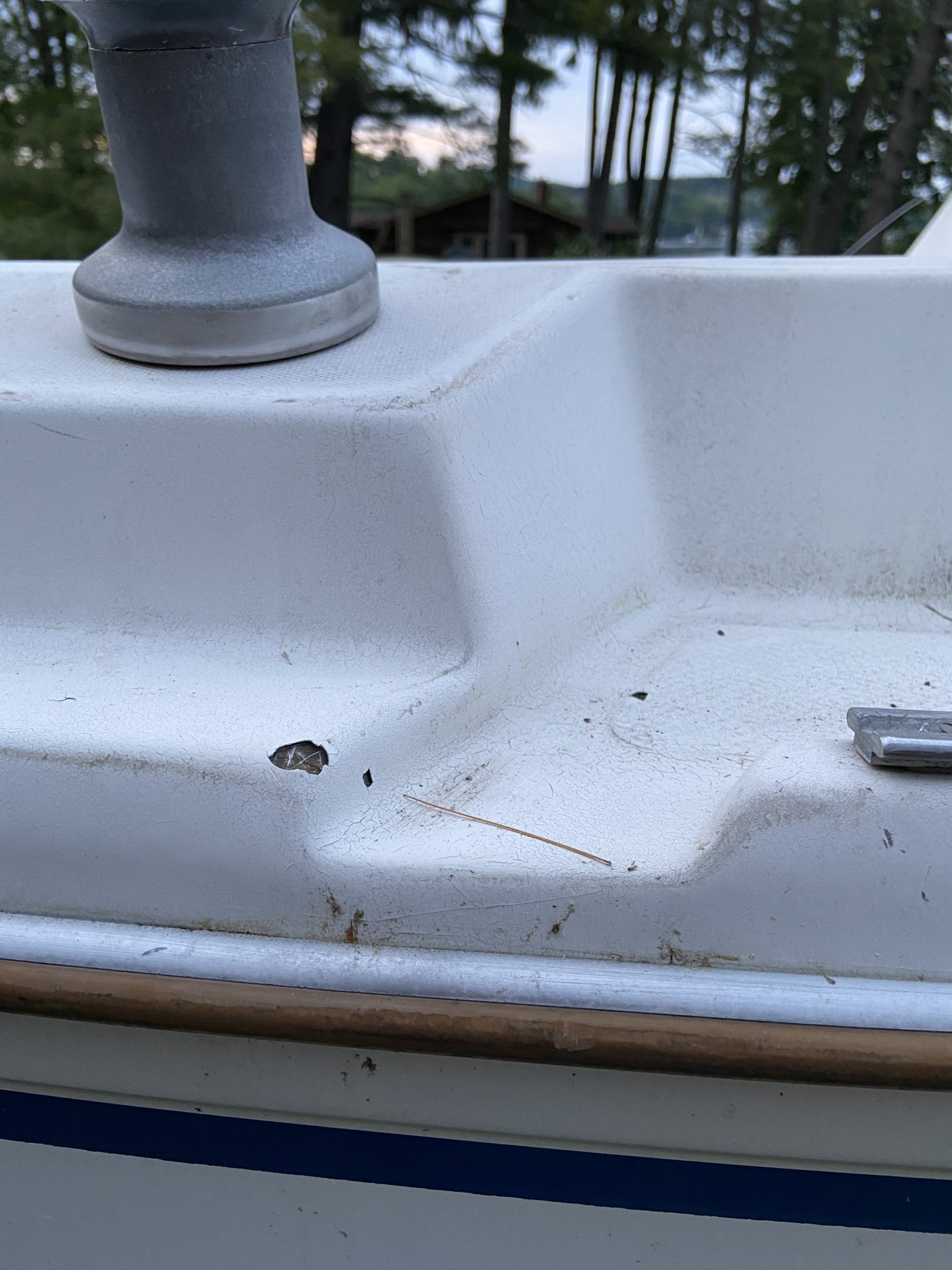

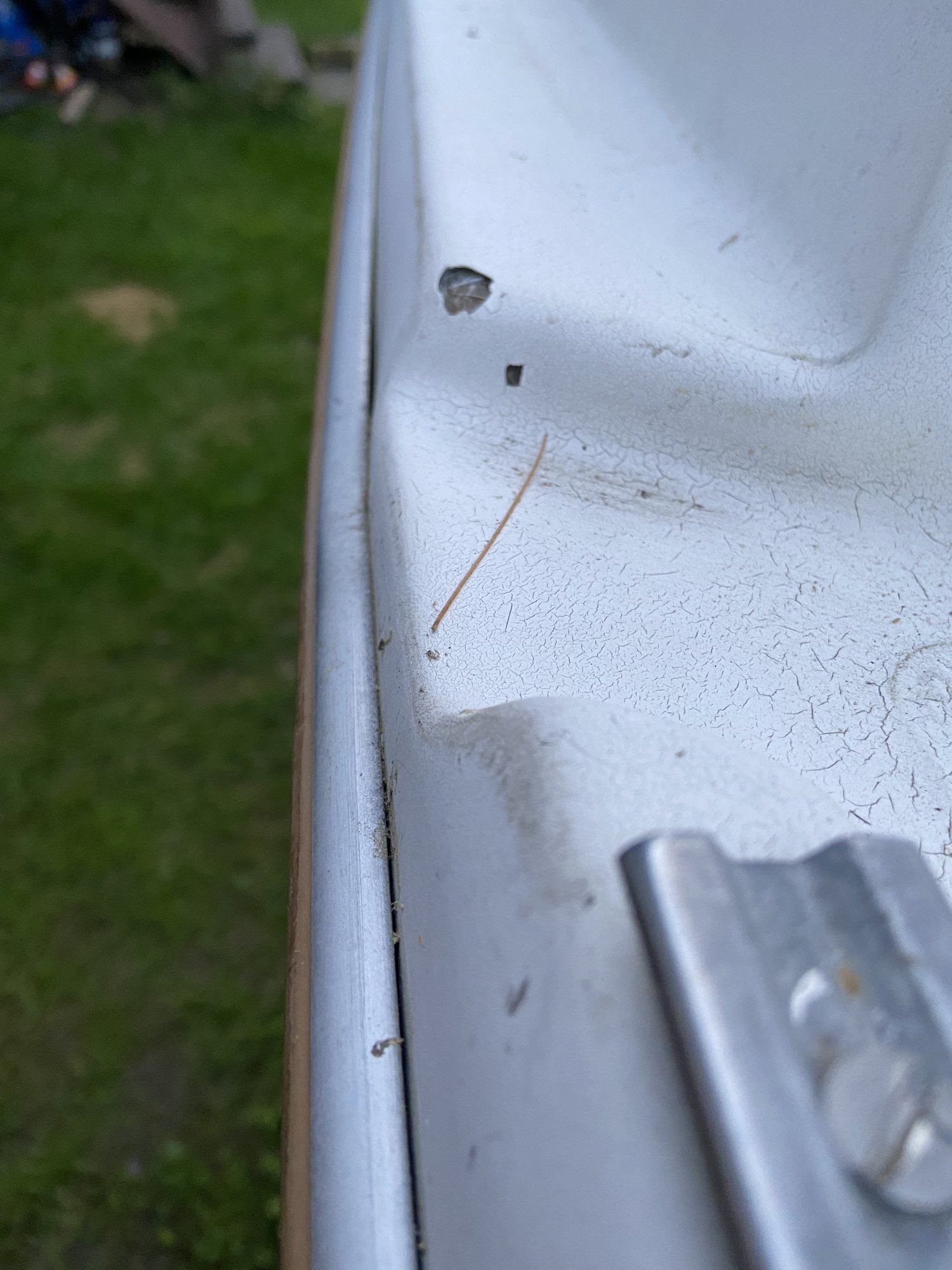

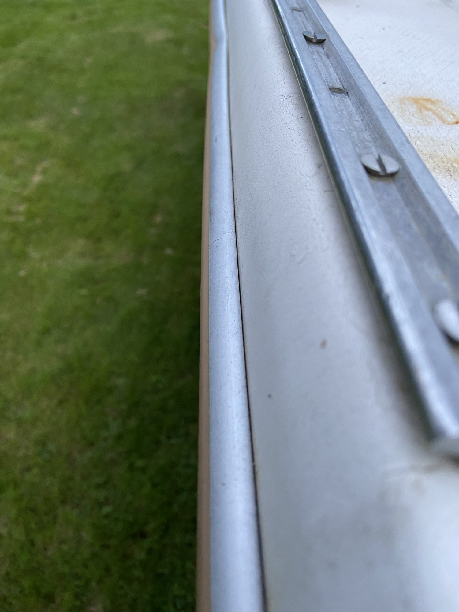

Rain stopped so I got some pics. Thanks to everyone because I think I know what's leaking now. The rub rail is bent in a few places causing water to get in. Short term solution is some marine sealant which I'll order tonight. Long term solution is to take the rub rail off and rebed the (hopefully) screws with countersunk holes and butyl tape. Thanks!!

Great detective work! Please post photos of the repairs when you make them. Welcome to the forums! :beer:
