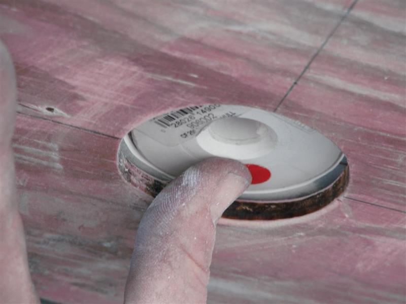

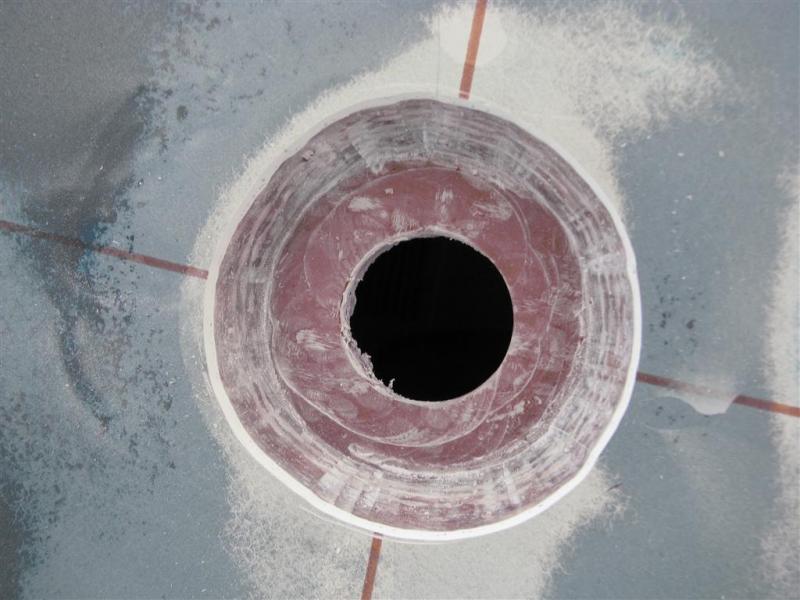

Removed from a '77 c27. When I tried to unscrew the gate valve, after limited resistance, the nipple broke loose and just turned in the hull. Essentially used the method you describe of flexing a sawsall blade to cut the inside near the top of the the built up hump, then cut through the nipple in three places from outside, and drove the pieces out from the inside. I installed a flush through hull to keep that nice smooth bottom that those high dollar close nipples provided. Similar Pics from install of flush thru hull on my 310
