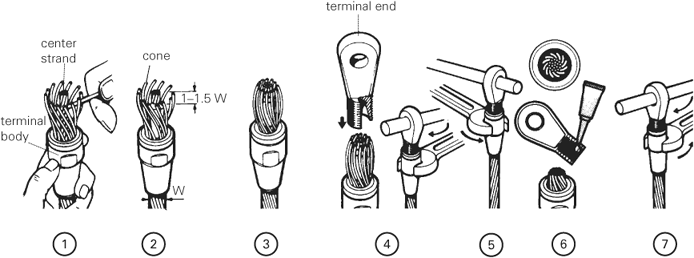

I have a Hood furler that needs to be repaired. I have a Norseman style fitting at the bottom of my forestay. I assume the furler will not be able to slide past the fitting? I'm guessing that I will have to cut the forestay a bit during reinstallation to get a clean end? If it has to be shortened, I'm wondering about the feasibility of using a couple of halyards for a month or two in place of the forestay. I've done this short term without issues. I've also rebuilt a Hood furler in the past but can't remember the specifics
Norseman fittings are mechanical, not swaged. Examine this diagram, then search youtube for vids on Norseman installation or replacement.

Norseman fittings can be reused if threads are good and no cracks. Check carefully.
But you need to cut off about 3 inches of wire, because the wire cannot/should not be wedged in the same spot.
RE: the above diagram. Good luck tightening with a bar and spanner.
I had to use a vice and a LOT of muscle.
:D heh, heh, xlnt point about bar and spanner tools. Good comment about trimming wire. Turnbuckle adjustment or adding longer stud could help compensate for that.
Thank you for your straightforward answer! That's a lot to trim off
