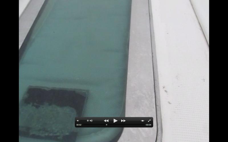

This is the method I plan to use. With the exception that I am going to remove them from the boat and send them to Select Plastics to be replaced so new, un-glazed windows go back in.
I have repaired both my fixed ports on my B352. You need to remove the plexiglass, and scrap and sand (lightly) off all the old adhesive, of the frame and the glass. Get two tubes of Dow 957 (black) and the primer - you'll require one tube of 957 per window. Mask all around the frame (inside and out) and the window. Now the tricky part. Insert some small lifters (1/8") and float the glass on the 957 (the whole tube), push down on the glass, squeezing out the excess 957 - down to the lifters. Now remove/clean away excess and get a smooth bead around the frame/window gap. Do the same on the inside. Carefully remove the masking tape right away (fix the bead, if necessary). Put a little weight on the window and leave it alone for a few days. I think it is easier if the weather is cool, as it gives you more time to work the 957 - also you'll need about six hands to control the mess. I hope that helps. Let me know if you have any questions.
How did you remove the windows. Were they screwed or just caulked. Dod you have to pry - risking breaking the glazing?
I haven't made it that far just yet.
The skylights are not screwed in, just held in place by sealant. The side fixed port lights are held in by four screws, but I assume that they are mostly held in my sealant. The screw are more for alignment and to hold the window in place while the sealant is curing.
