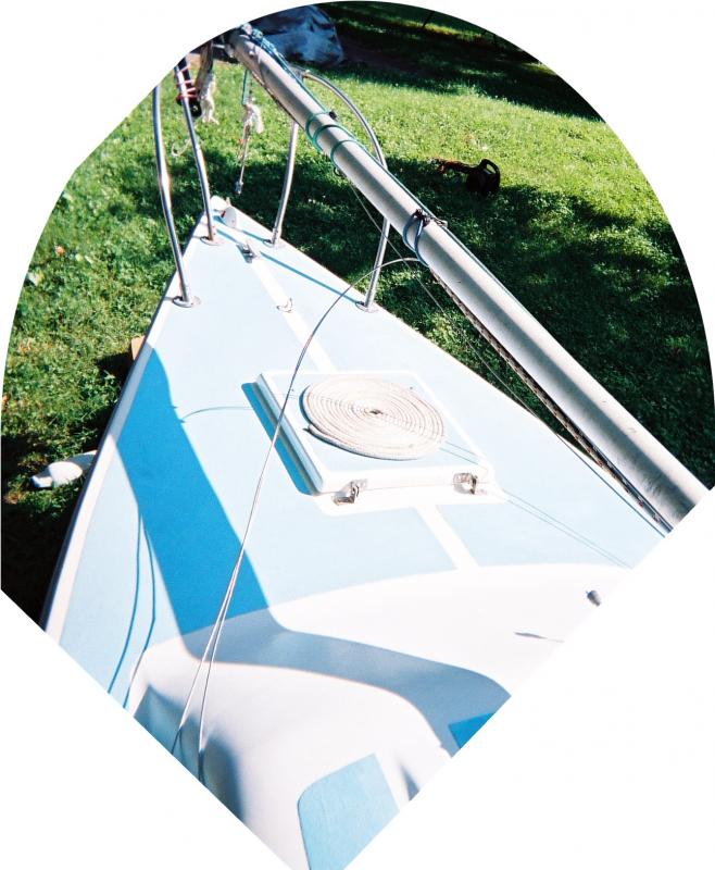

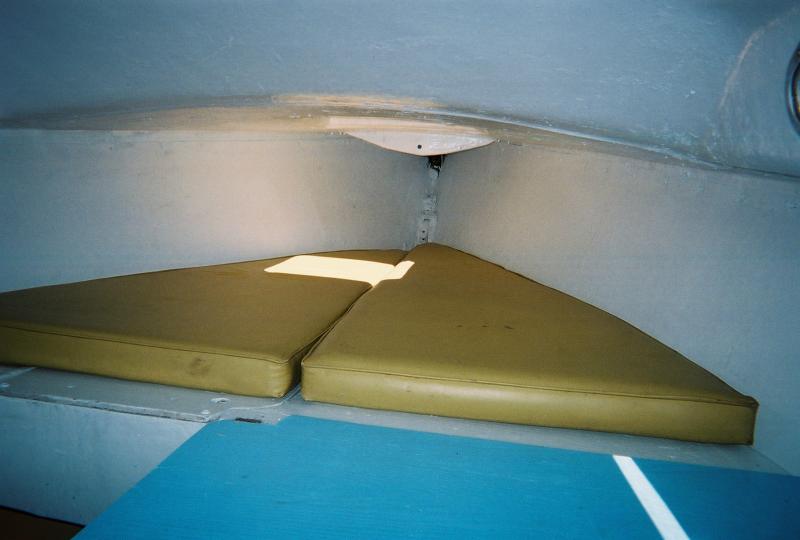

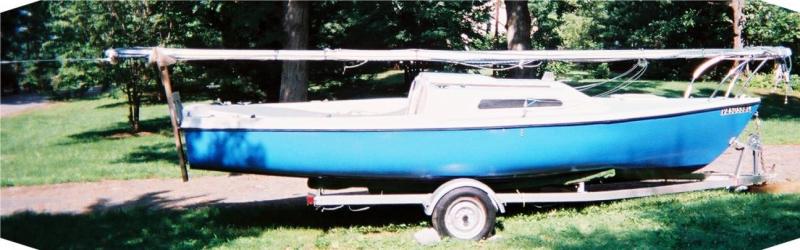

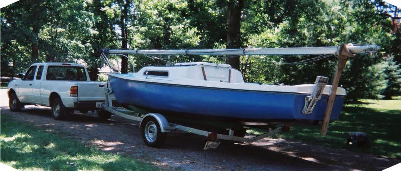

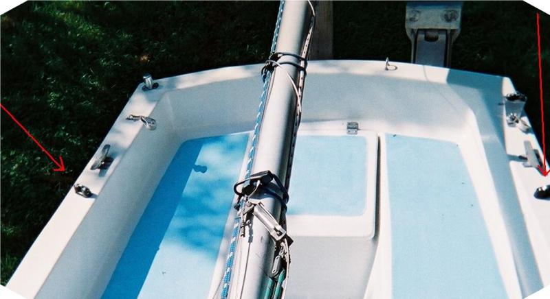

Here are some pics of the first boat I restored (a Mac 21). Maybe give you some ideas. I'm on my seventh now so be careful... fixing old boats can be addictive (and expensive)

Rustoleum sells a Marine grade paint... but honestly, I've had very good luck with regular (in the can not spray) rustoleum. I've used both and both are very good paint. The boat above was regular rustoleum. The color was called "Sail Blue". Use the roll and tip method to get a smooth finish and make sure you use the low nap roller (foam) designed for a smooth finish. The tipping has to be done within a few minutes of rolling so either have a partner or roll a small section and then tip. If you need to.... do a google search on Roll and Tip painting and you will get several uTube links.

Def top and sides.... I think Rustoleum makes a bottom paint but I've never used it so I can't (won't) vouch for it.....for the inside, I used an oil based paint that I got from James T Davis that was formulated for bathrooms. It has an anti-mildew additive. I had fantastic results with that. When I sold my boat three years later... there was no mildew and more importantly no mildew smell in my boat...I also know that Home Depot has the anti-mildew chemical as an additive you can add to many different paints... that would open up more color options. I have read that a high quality exterior grade latex will work on the insides. Many people have done that... I'd still recommend the anti-mildew additive.

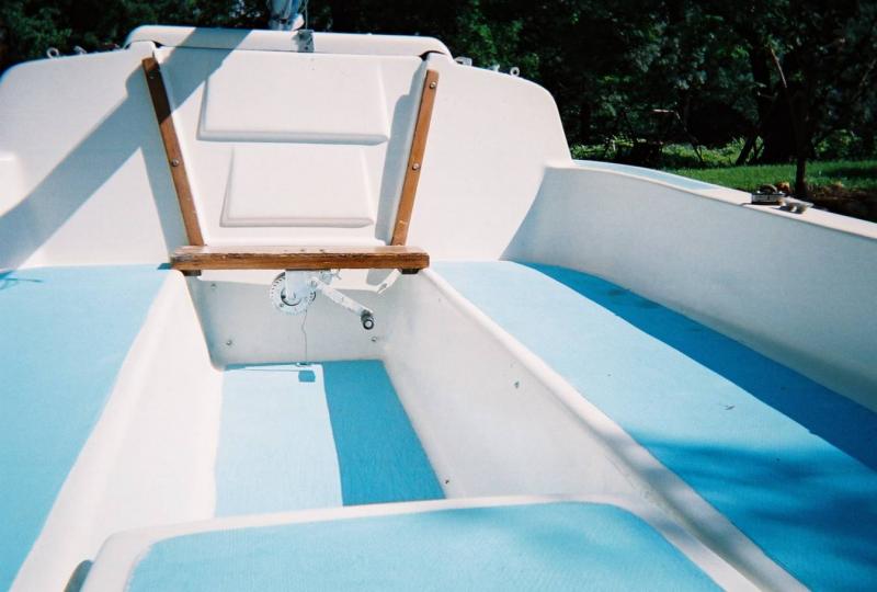

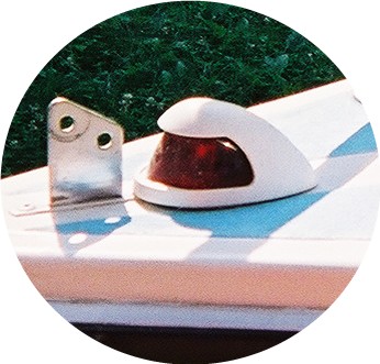

The anti-skid you see in my pics I got at Lowes and the stern light is actually a licence plate light I got at Auto-Zone.

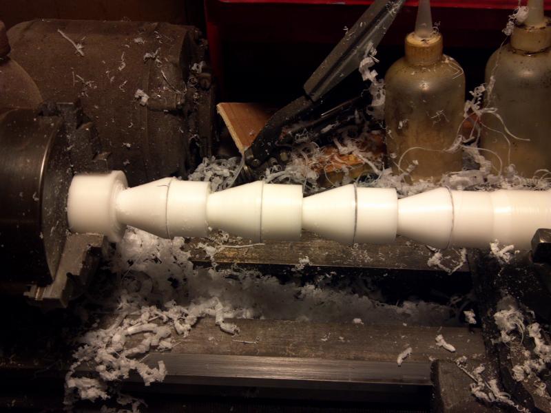

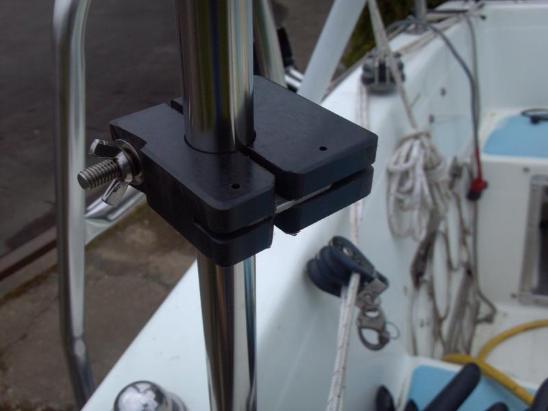

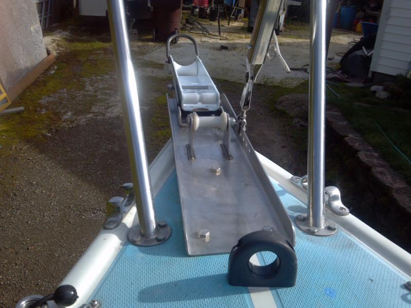

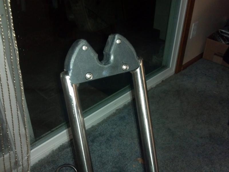

the starboard would be better than plywood because it wont rot, but it still has a lot of give to it unless you use it in thicker pieces... when it gives under a load it can still stress the area around the hole that the hardware passes thru.
a much cheaper and stronger material to use would be delrin. because of its extreme stiffness, it will effectively spread the stress out over a broader area of the deck, which is what is required for high tension loading. it comes in any thickness you want, it is nearly equivalent to aluminum and is workable like a very hard wood, but wont corrode, rot or degrade in the weather.
and its STRONG... with the larger pieces you can make about anything you can think up... its good stuff to have around if you are creative with tools.

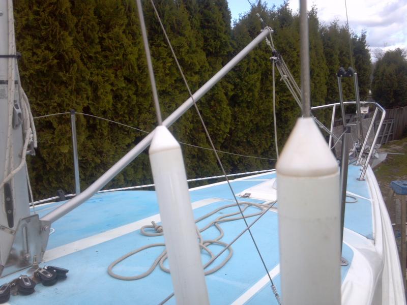

in addition to being used as backing plates for deck hardware, here are a few photos of it in use on my boat.... the mast crutch, turning the pointy caps for the shroud cover tubes, large bullseye lead AND roller for the anchor chain/rode, heavy duty railing clamps, and the finished pointy caps so the jib sheets dont hang up on top if the tubes.... it serves many other uses for me as well and I have more plans and ideas for the stuff than I have time to create with it...:D

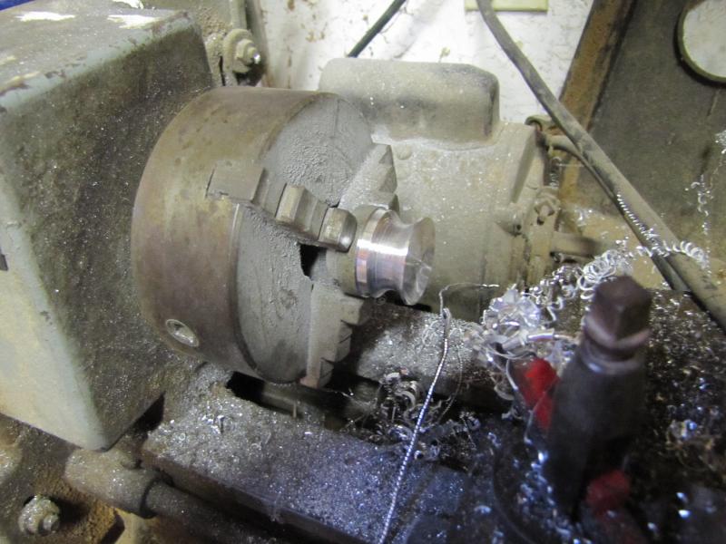

The delrin as mentioned in centerline's post, is also used for sheaves. Although, when the delrin sheaves went south due to age, I replaced them with aluminum ones I turned
