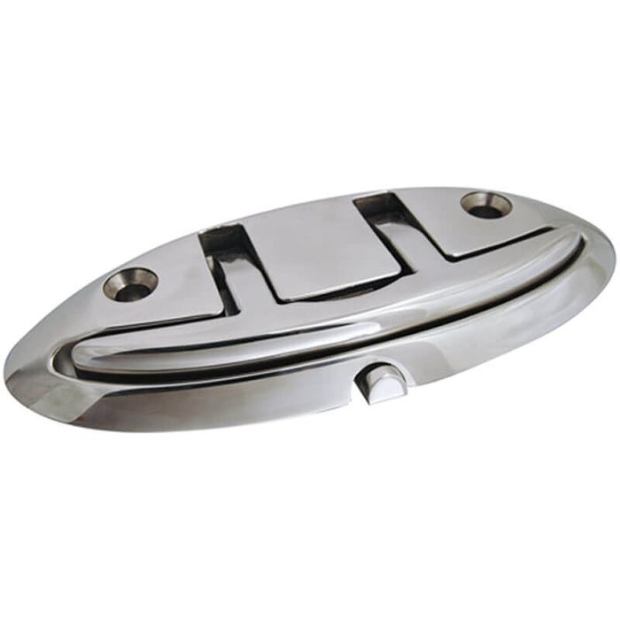

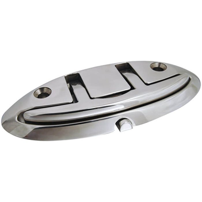

I found room with one of these.
I installed with a 1/4" Aluminum plate as a backing material

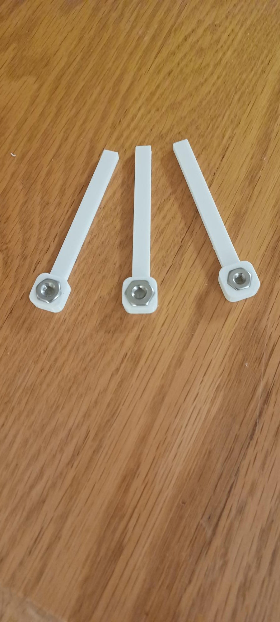

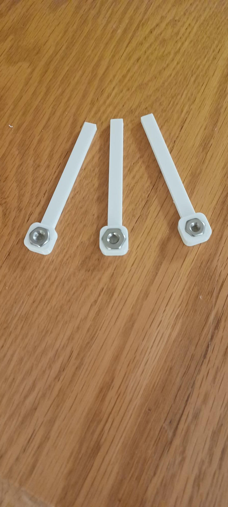

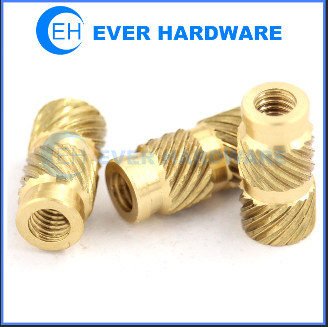

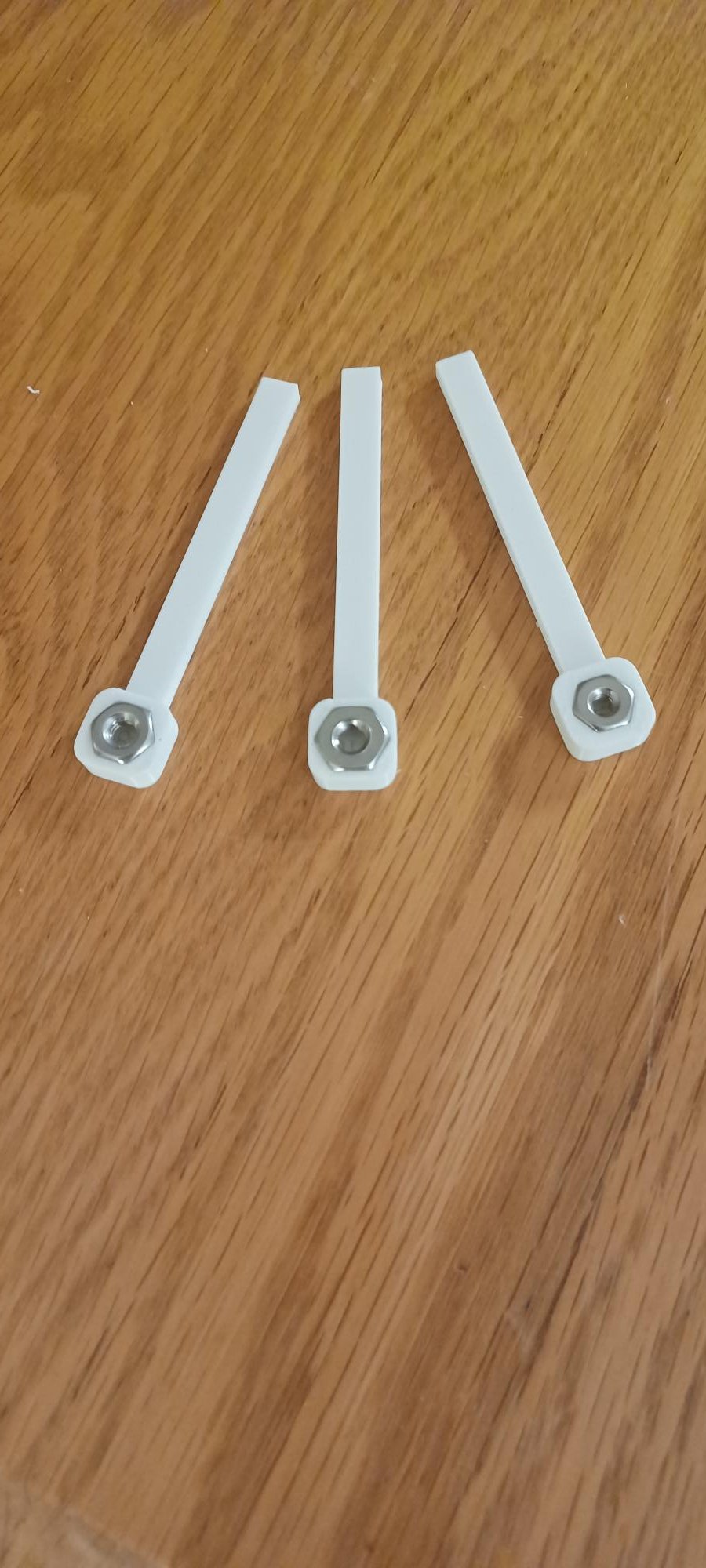

My boat is a C30 Mk2 so very simular in almost every way. In your first post you commented that the small screws were pulling out of the deck. On my Mk2, all of the stanchion bolts are thru-bolted. Some of them can be an absolut bugger to get the nut back on once you remove them for rebeding. I printed these nut holders just for doing this job. It hold the nut captive until the threads come all the way through the nut and then the threads push the holder off.

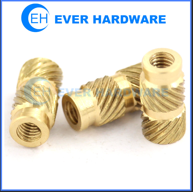

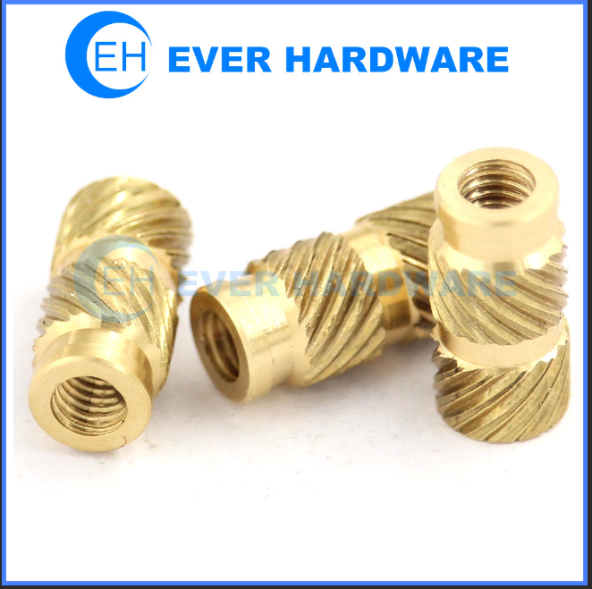

I had two screws that were completely impossible to get the nuts back on without cutting out significant access holes inside the boat and that was not acceptable. In those cases, I drill the holes out larger and epoxied in knurled brass ferrules so that the screws were attached to brass threads strongly anchored into the toe rails.

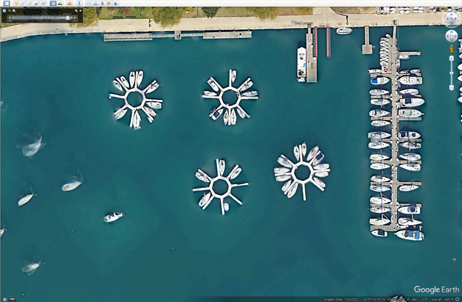

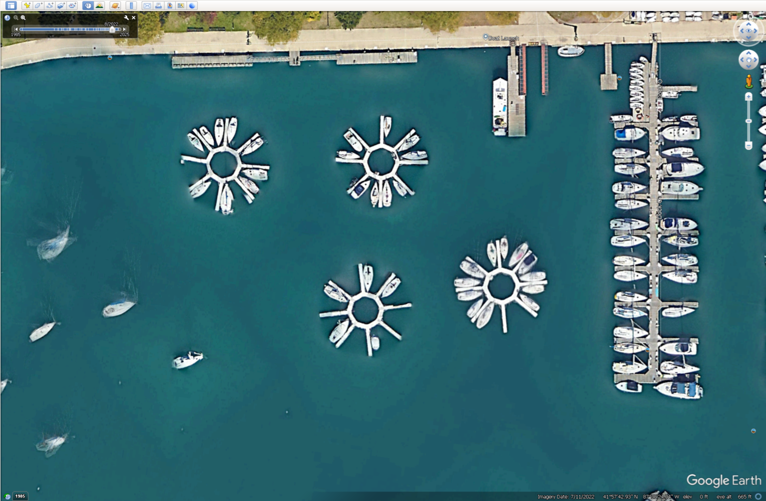

Here's a map with my typical route. The docks shift around so angles and distances change from day to day. Sometimes the docks are only 10' apart. No currents. Winds are usually under 5kts

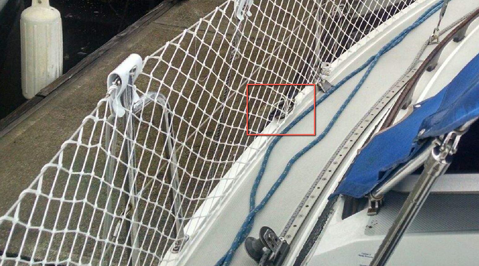

I think you have the same toe rail that I have. Maybe I should have called it a min-bulwark. On the edge of the C30 deck is a 1" high by 1" wide raised lip that the 1/2" bolt for the stanchion bolts through. I mounted my midship cleat to the top of that. Here is a video link showing a method very similar to mine.

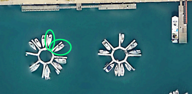

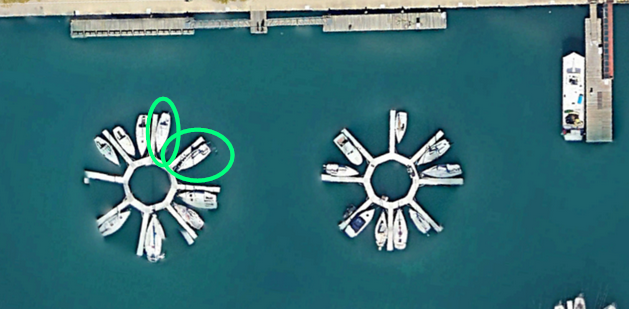

I would be in one of these two spots. It all depends on which way the wind was blowing that day. Sometimes my slip faces land and sometimes it faces the other floating dock
Wow, no wonder I couldn't envision this - I've never seen such an arrangement - do you always get the same slip even though it may move around?
