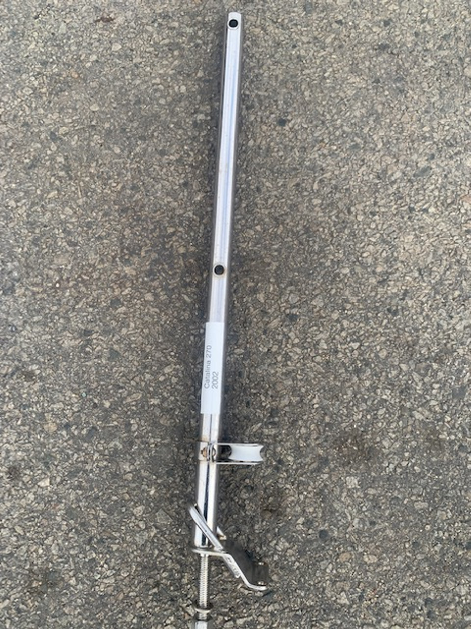

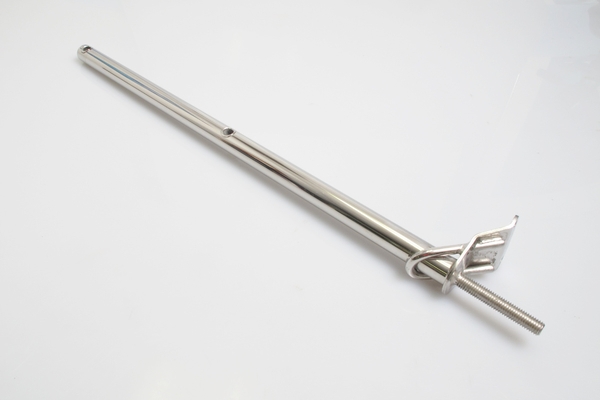

People really like to grab my midship stanchion when docking even when I tell them not to touch it. I have the style below with a big bolt through the deck and two smaller metal screws. At least one of the smaller screws has stripped the fiberglass around it so I'll have to fill that back in. Has anyone reinforced or improved their stanchion in anyway?

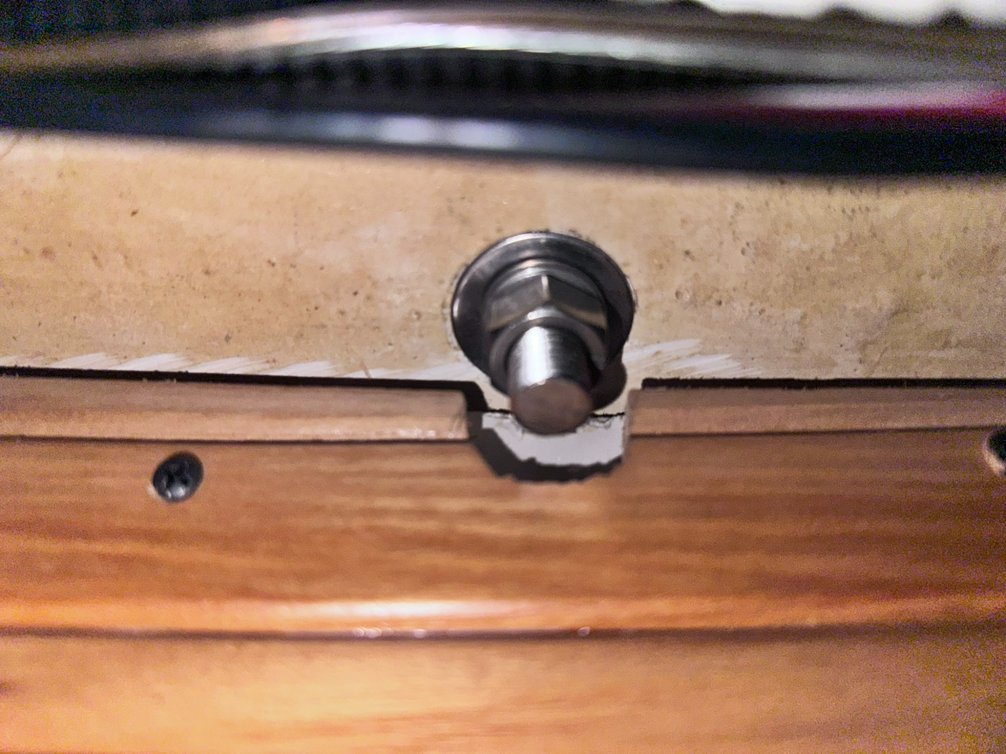

Upon close inspection, you can see the glass is crushed around the washer

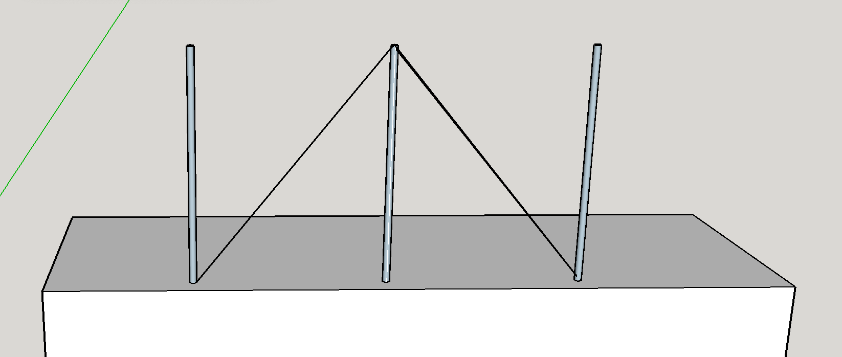

A diagonal brace of some sort will add significant strength to the stanchion. I'm leaning more towards a cable so I don't have to drill more holes in the deck and because I have most of the hardware on hand
I can't envision a diagonal cable brace. Got a diagram?

Right, but that does nothing for the port to starboard loading which is likely your most concerning loads.

24,615
Such a design is interesting. If I grab the middle stanchion at the top, with the diagonals and push it, what will happen to the forces at the deck? Will the stanchion not bend in the middle?
dj
Fore and aft is my primary concern when people try to stop a moving boat
I can lower the attachment point. I have yet to bend a stanchion. The deck has always taken the brunt of the beating
