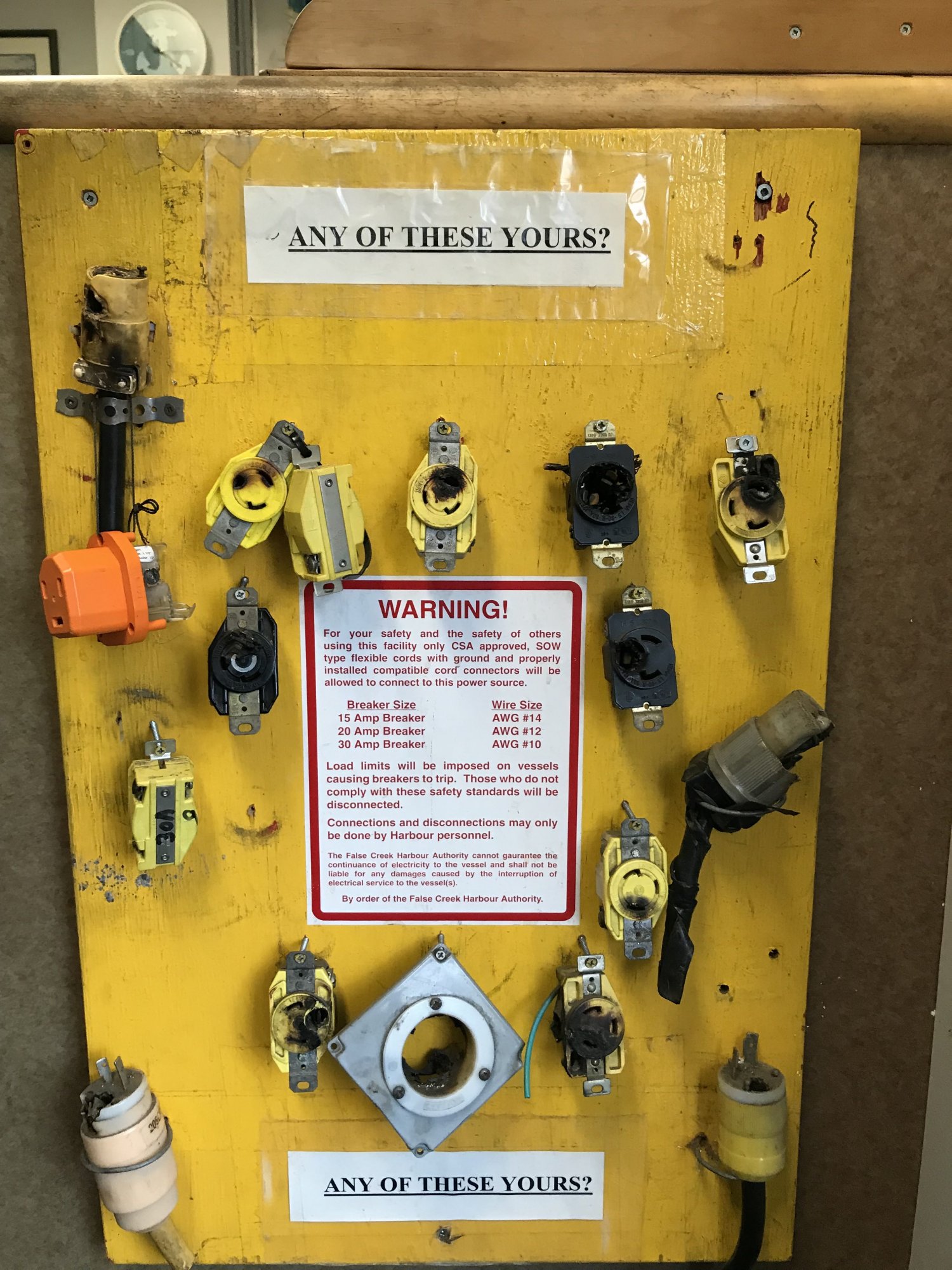

Justin writing rule is communication. They are your rules and as such “justification” is really not necessary. It is nice. Perhaps clarification can be accomplished by having examples. Maine Sail posts his gallery of shame ”burned out plugs and cables”. During a visit to Fisherman’s Dock in Vancouver BC they made it clear they only permitted commercial power cables attached to there power stanchions. There was a board showing approved cables and examples of burnt cables and fittings.
State the rules, communicate with orientation discussion and pictures or a board demonstrating failures.

24,495
I found the image of the Vancouver BC Board of Shame.
The items indicate to me the it is not always the product but the way it was installed or used that causes failure.

6,136
Yikes! Check out that 30A SmartPlug connector (orange).
Yeah, having just installed a smart plug I wonder what happened there. Given that smart plugs are a pretty low percentage of the install base having one on the board of shame isn’t a great percentage. Though it is a small sample size.
It looks like it burnt at the screw terminal.

13,975
IIRC when i cheg'd mine, the screw was already black? Maybe not.
I believe the screws on the Smart Plug are color coded, so black, silver, and green.
It looks like the SmartPlug connector in the photo is attached to or associated the heavily charred 30 amp plug with the black cable. I'm wondering if this was a DIY adapter to connect a smart plug to a 30 amp receptacle.
