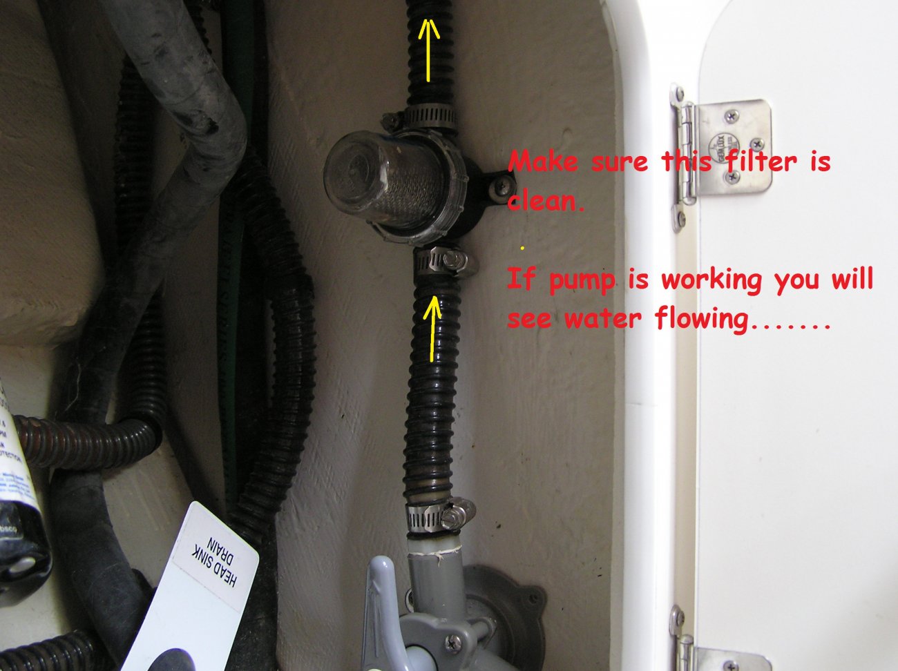

Spellman66: the Y valve should be on the right side under the galley sink. The filter and pump are also there.

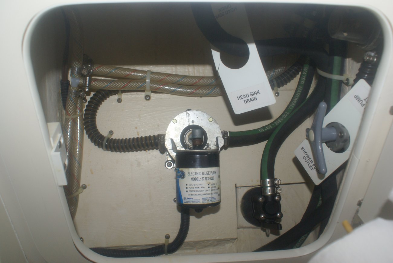

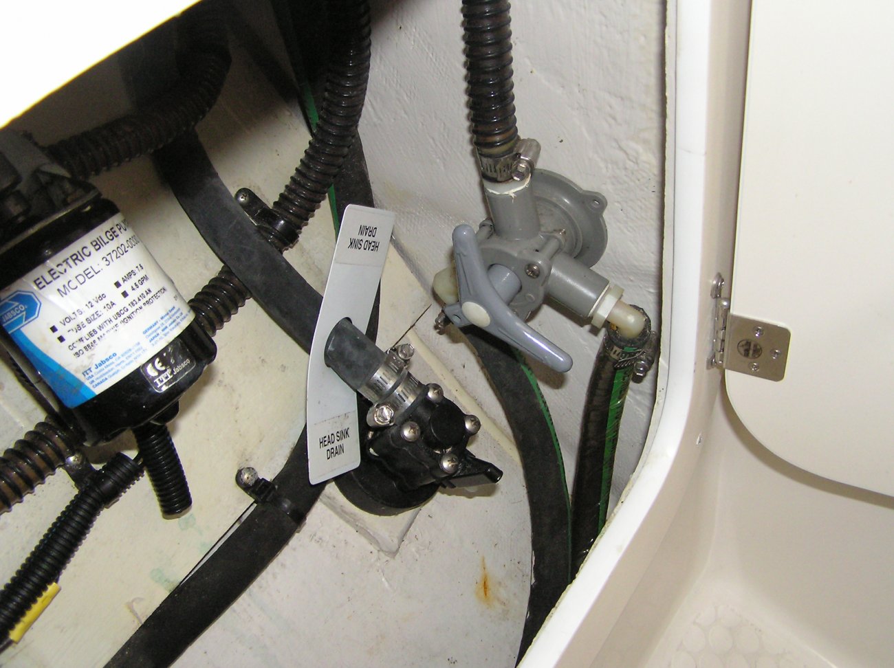

This was the setup on early models. Later models put the pump and the Y-valve under the head sink. So look for where the Y-valve is located. You will need to turn the Y-valve to the proper side, open the through-hull and then push the shower sump button above the head.
Good luck and fair winds.
Jesse
Catalina keeps us on our toes. That also explains why somebody else had room to put his battery charger under the galley sink-right where my pump, filter, and y-valve are mounted.

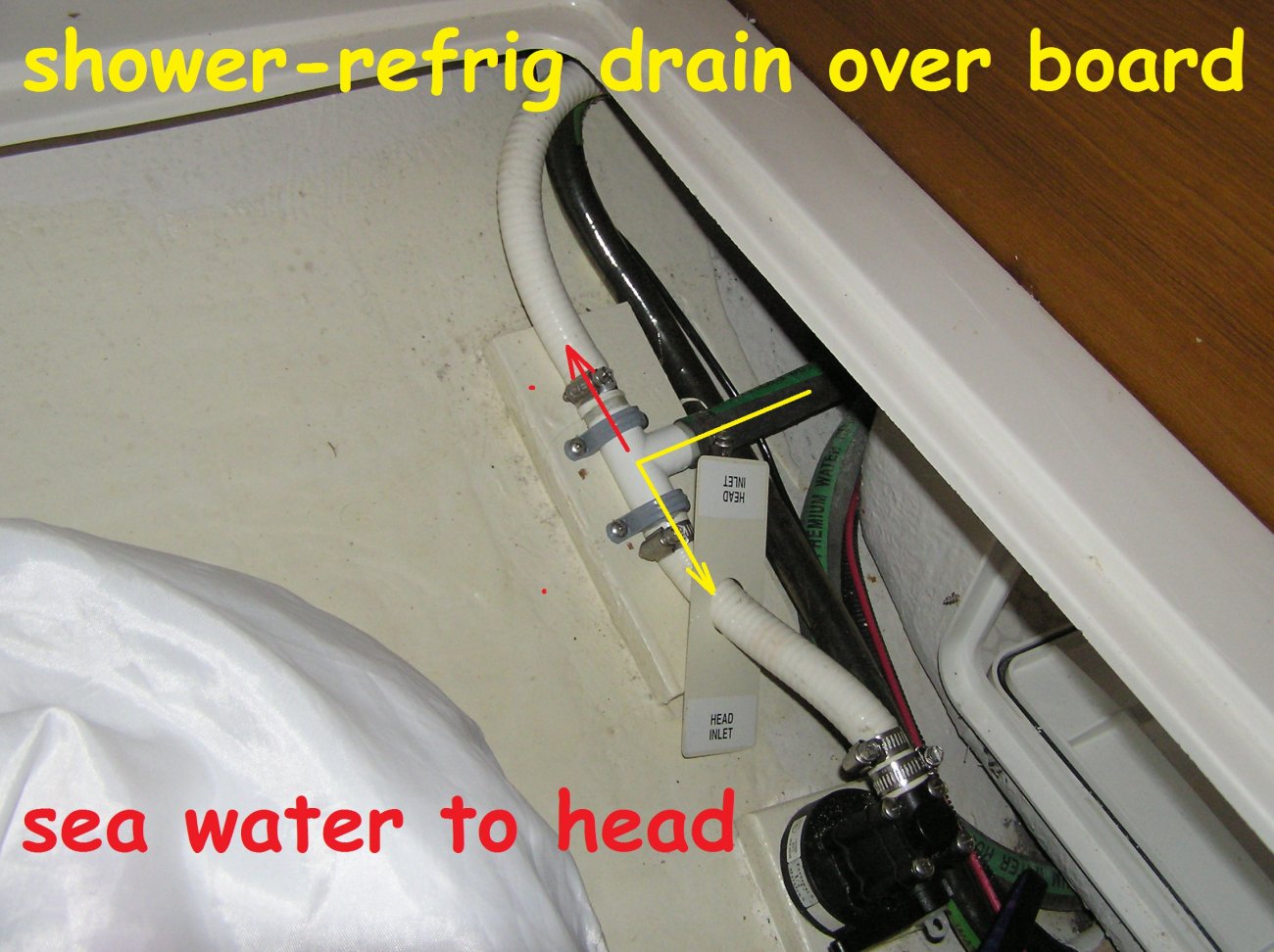

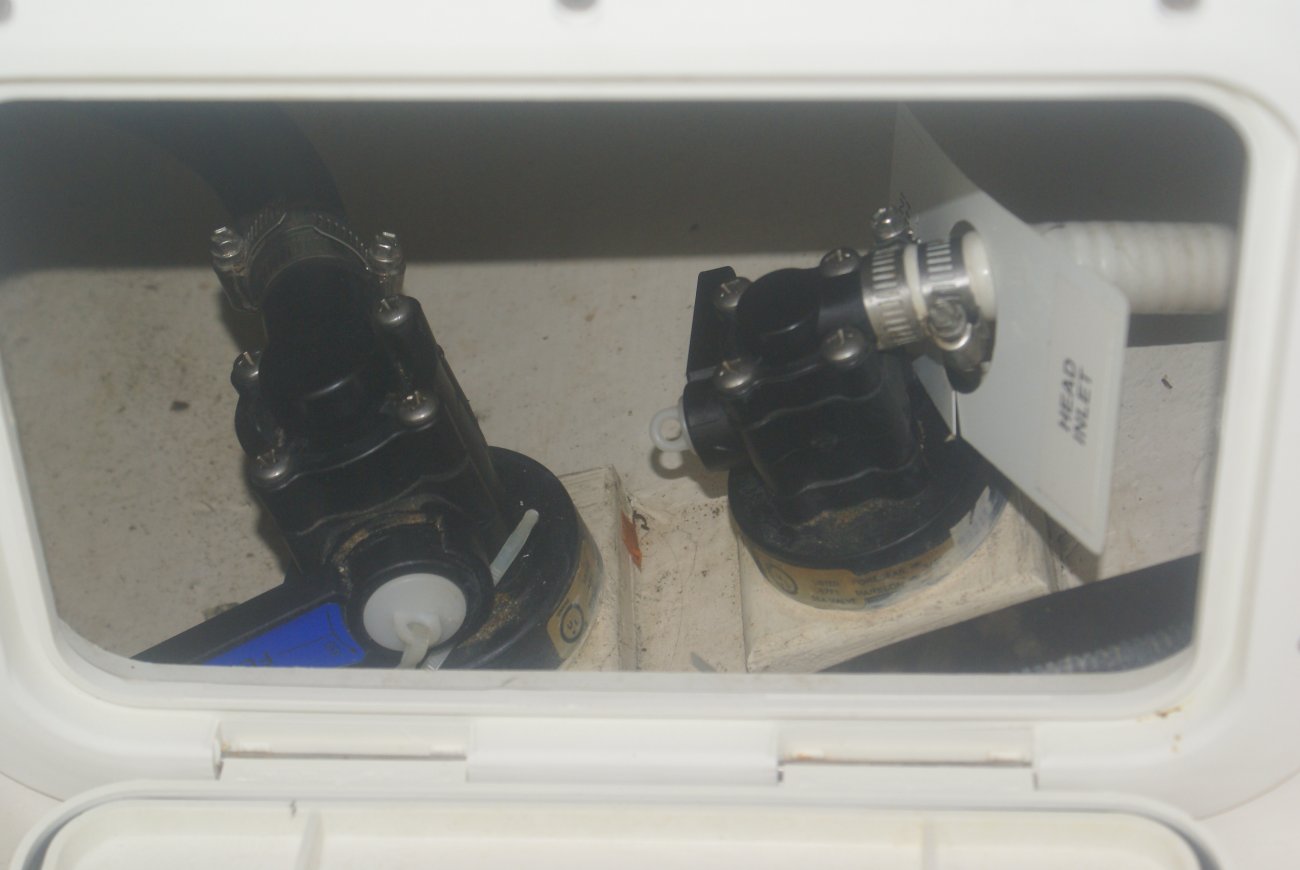

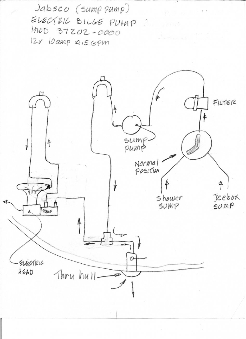

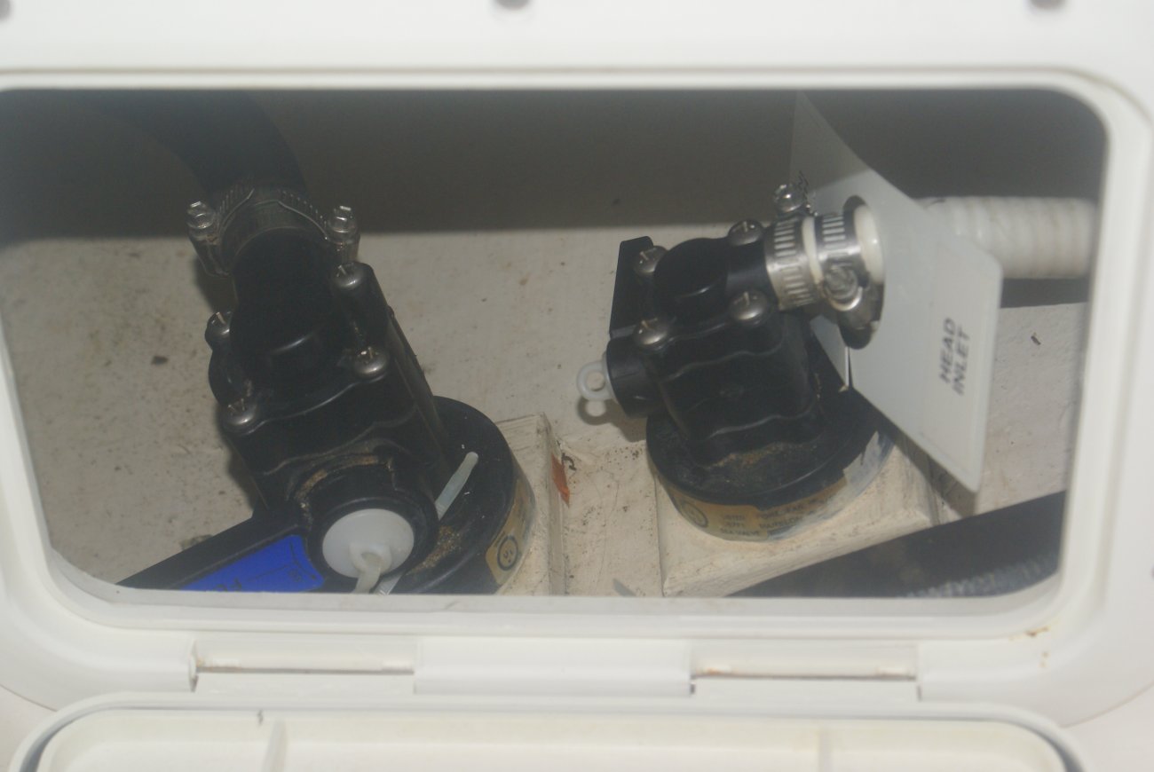

Picture shows the Y valve on the right. Looking forward, from aft, rotate valve fully clockwise. That puts it in the reefer drain position.
Open the head inlet water seacock (picture #2, looking aft, valve on right). The water exits through that seacock. Turn on the shower sump switch on the main power panel. Push the shower rocker switch above the head. It can take several seconds for the pump suction to pull the reefer water through the lines into the pump. You will hear an audible change in the sound of the pump.
Open the head inlet water seacock (picture #2, looking aft, valve on right). The water exits through that seacock. Turn on the shower sump switch on the main power panel. Push the shower rocker switch above the head. It can take several seconds for the pump suction to pull the reefer water through the lines into the pump. You will hear an audible change in the sound of the pump. View attachment 156775
Seems you also have the same RUBE GOLDBERG design as I.
paulj
:hook2:
Interesting. I was wrong about you making that change, must have been Catalina. Maybe they moved it from the galley to the head so shower was the shorter section of tubing, instead of the reefer? So you’ve only got one thru hull under the galley sink?

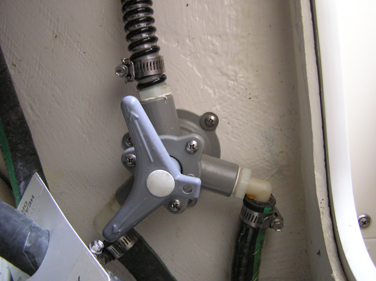

I have a 2003 and the set up is identical to paulj. I found it great for winterizing. Just pour in the polyglycol into the bottom of the fridge and turn the valve to the setting in the photo. Then turn on the shower sump pump and it drains the entire system through to the head. WINTERIZED !
PS.Don't for get to clean the filter just above the Valve.
