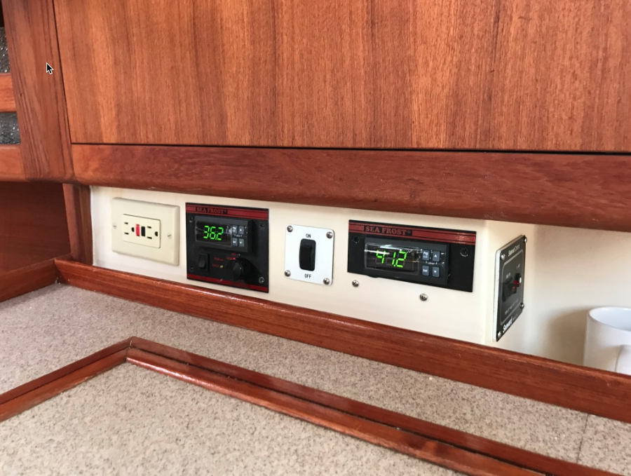

I have to give Cleave at Seafrost a huge thank you! I am very pleased with the system he spec'd out for me and he was a huge help during the install when I had a couple of questions! I am very impressed with the quality of the equipment. It is very solid and has almost a commercial grade feel to it. The install was straightforward though some of the wire pulls were a pain in the butt. It's hard fishing wire around the back of the box.

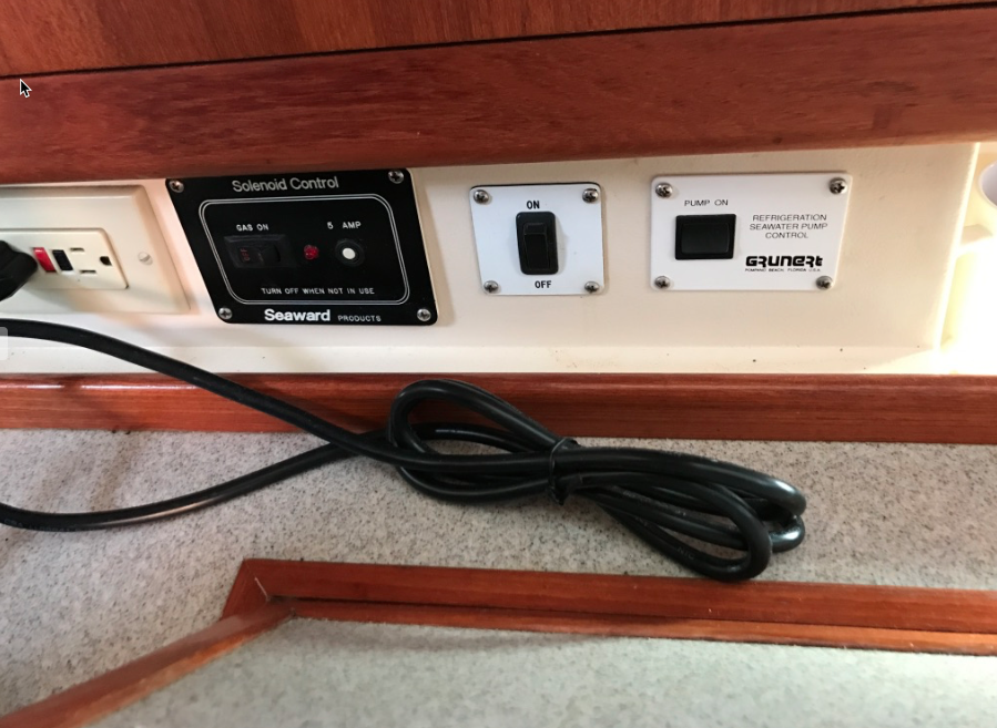

Here is the before of where the controls were going to go.
After, box was open a lot right before the picture so the temps were up a bit.

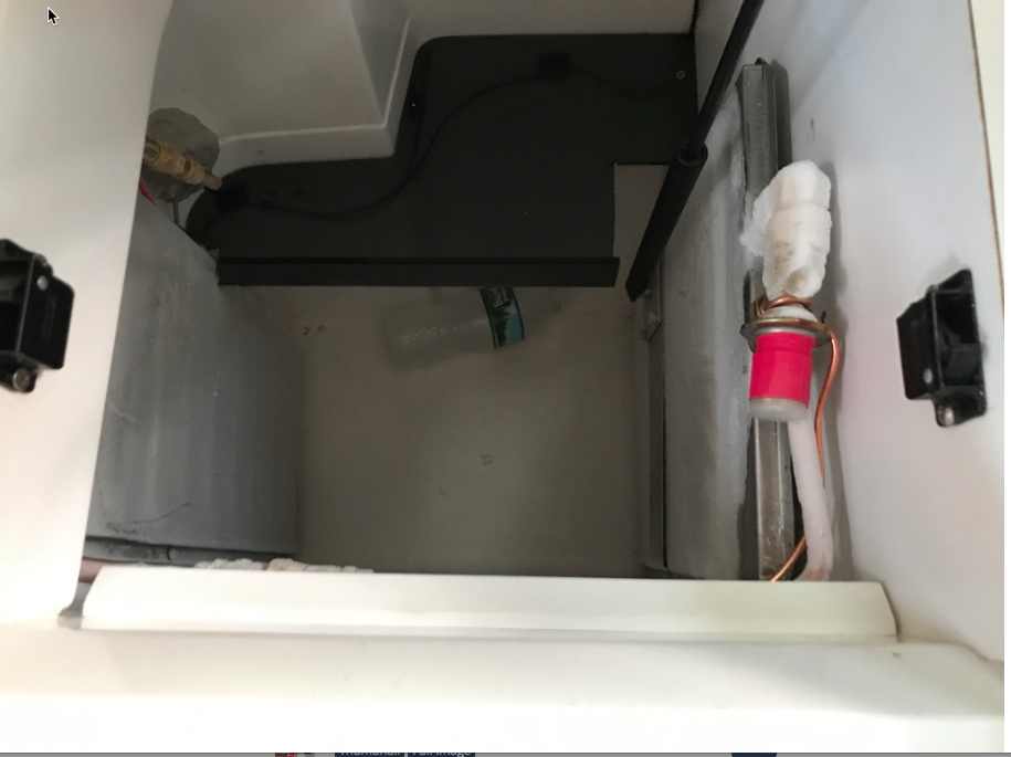

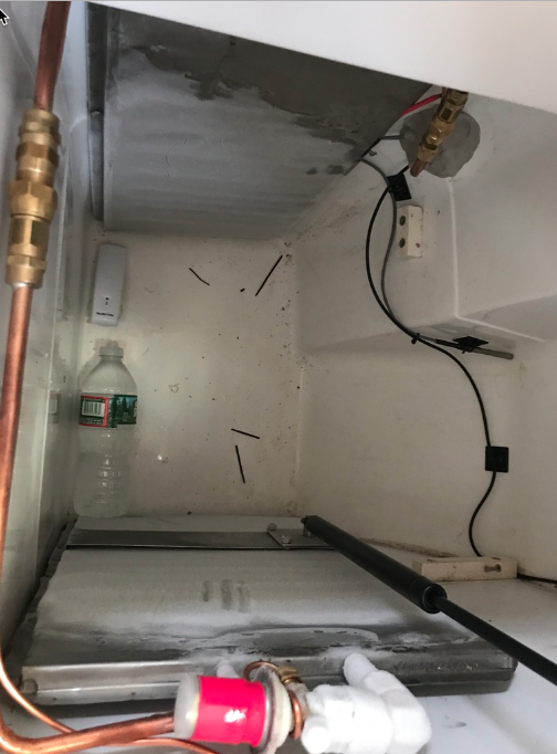

Inside of the box is hard to get good pictures but here are a couple.
The shelf is out in this picture obviously
Here with the shelf back in and a piece of starboard added to protect the copper tubing.

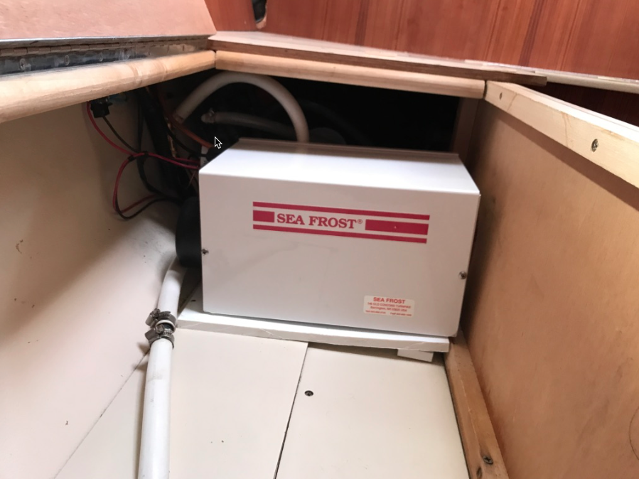

The compressor went right where the old one was in the settee.
