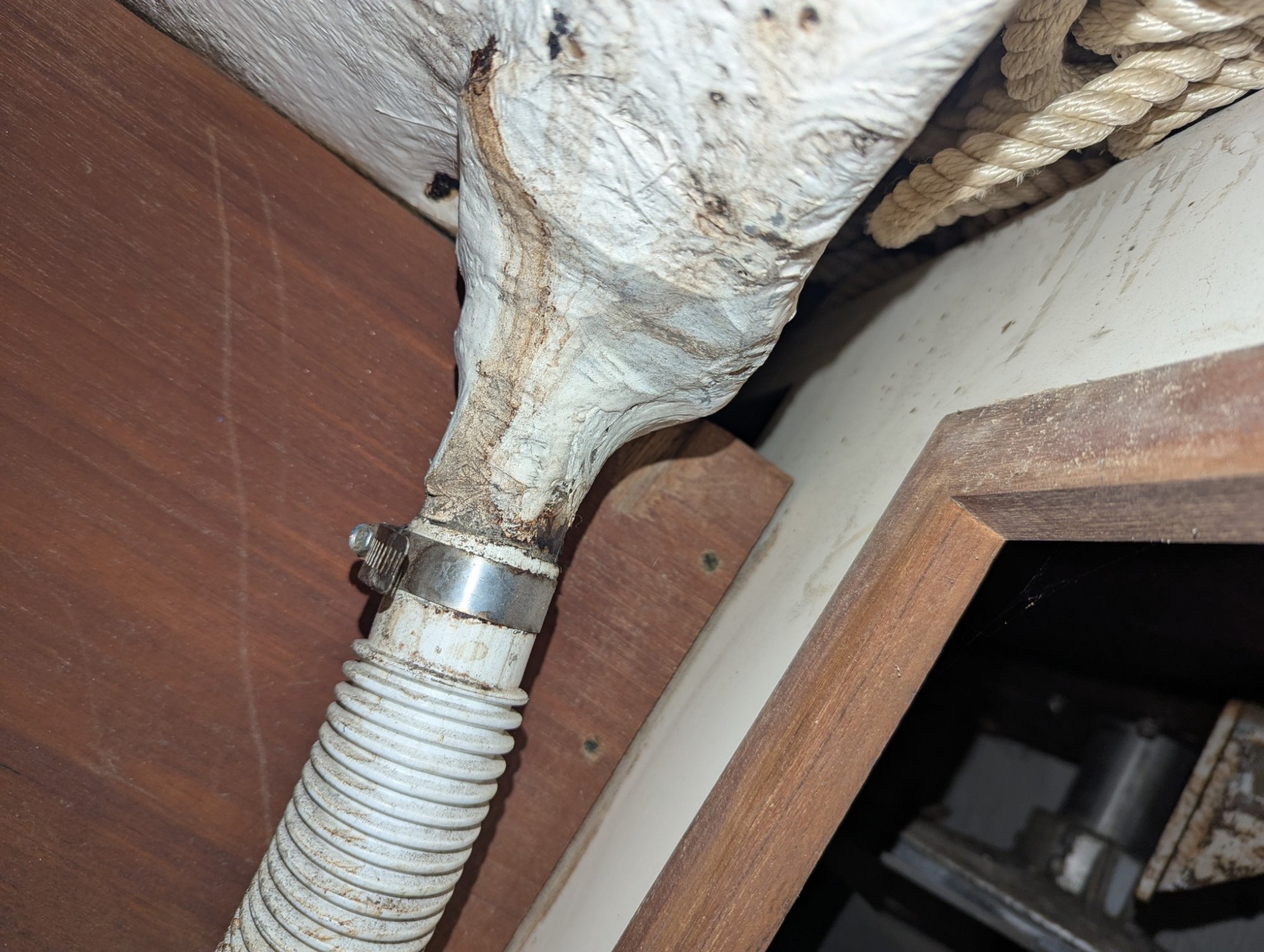

I'm upgrading the cockpit drains on my Cherubini with bluewater reliability in mind—planning for green water, not just rain. The current setup is typical of the era: molded fiberglass drains, glassed into the cockpit sole and hull, no flanged fittings, no seacocks—just a hose clamped onto a hand-shaped layup that looks like it was built with a bucket of resin and a prayer.
They've held up, but they look rough, and I’m not interested in crossing oceans with systems that rely on luck and legacy glasswork. I like the 1.5" hose size and plan to replace it with high-quality smooth-wall hose. I’m also considering adding seacocks to the cockpit drain outlets, even though they exit slightly above the waterline, just for peace of mind offshore.
I want to bring some real structure and serviceability to this part of the boat—flat flange, proper through-hull, backing plate, valve, and hose run that won’t make me nervous in a seaway.
Open to ideas or lessons learned if anyone’s done this kind of retrofit.

Really appreciate your thoughts, Stu—especially the Coos Bay story. That’s exactly the kind of real-world data I’m hunting. And you're right—cheap hose is a false economy.
That said, I’m not sure I follow the "seacocks make no sense" angle. ABYC H-27 calls for shutoffs on all hull penetrations below the waterline—or near it. A knockdown doesn't care how high the drain exits looked at the dock.
Crossed hoses help, but they don’t stop a cracked fitting, a failed clamp, or a dragged-off hose from flooding a laz. I’m thinking in terms of collision, inversion, container strike—not rainwater management.
To your question: planning ICW to Caribbean, but designing for Cape Horn—because I’ve never met a storm that asked where I was going.
Still sketching options. Curious what others are running—factory glassed tubes, flanged fittings, valves, or just hope and tradition?

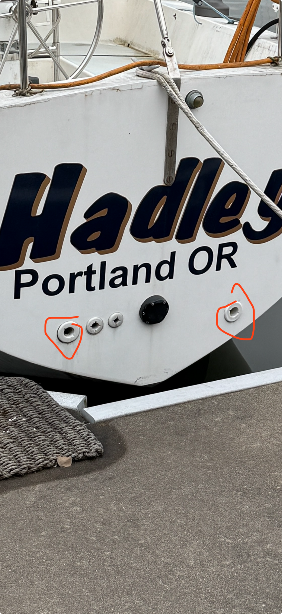

My boat’s cockpit drains are schedule 80 1.5” PVC PIPE. The 90degree turn is a full flow 90. They exit the stern. Water would have to flow up 3-4feet if it is breaking against the stern. From in the cockpit I’ll be standing in water as it empties.
Here are the outlets.
With your concern are you installing a high volume manual bilge pump?
