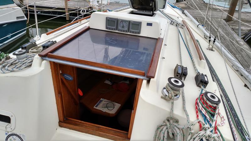

Just did 3 coats of Cetol for the first time. Looks good. I hope it holds up.
Nov 9, 2012
2,500
Oday 192 Lake Nockamixon
Yes, there is a gloss overcoat available.
Note that Cetol is really more like lightly pigmented translucent paint than varnish. It doesn't build up the way varnish does.
That looks really good! Is there a gloss overcoat?
