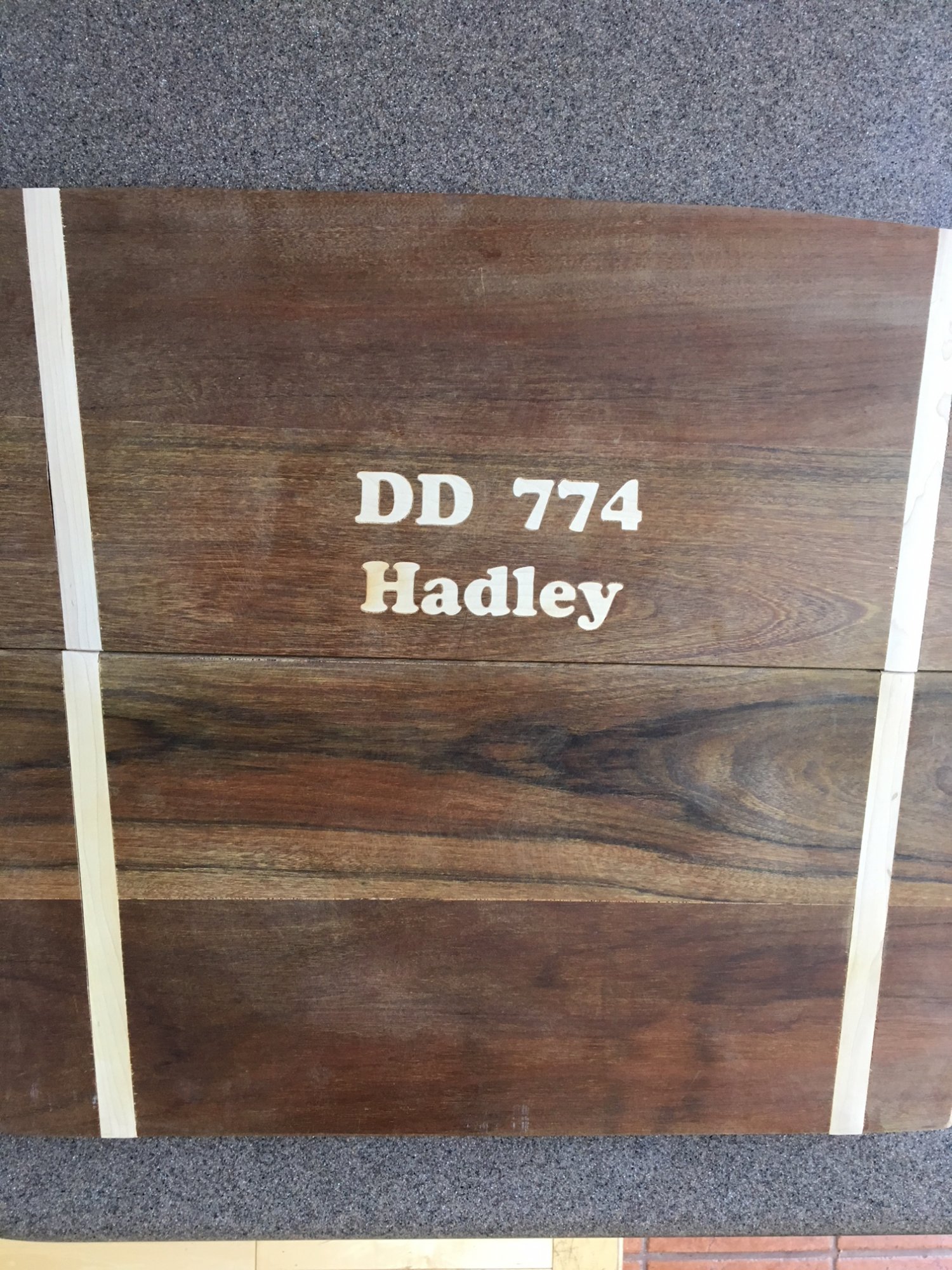

I found the image of my hatch boards. The boards and the beautiful inlay were a gift from my buddy, @LeslieTroyer .
They really dress up the old girl and bring a bit of family history to life.
