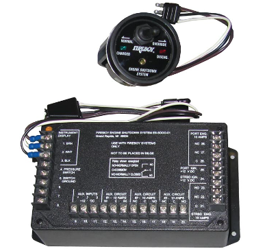

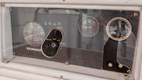

I find this interesting. Below is a panel from a 2005 Hunter 38 on Yachtworld, and in the upper right of the panel is the AFSS helm display unit, which includes an override switch for the auto engine shutoff that is wired to the shutdown control module (2nd photo below), which is likely buried somewhere behind the panel. Curious if you have the helm display unit on your boat with the little switch that lets you override the auto shutdown from the helm?

Yes, engine panel in cockpit is as in your picture above. The round instrument with the override switch is installed in this panel. I do not know what the shut dowv control module below is for. If it is related to the fire activated auto switch of installation I suppose it is to combine different fire detection sensors with different engines on a big yacht. I am absolutely sure it is not hidden somewhere on our H38, ( I have crawled every space in the last 12 years), no need to combine sensors when there is only one engine and one extinguisher in the engine room :).
