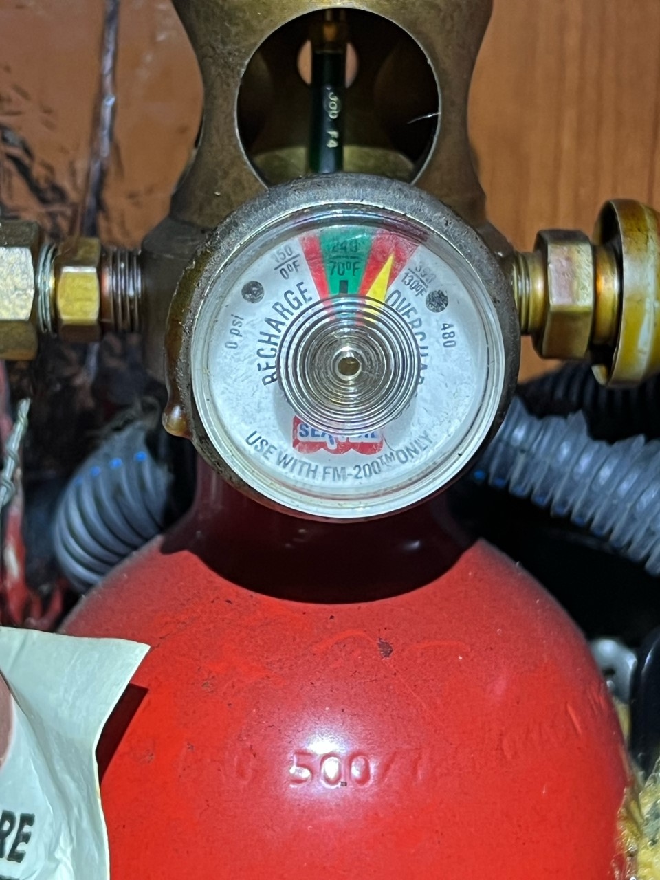

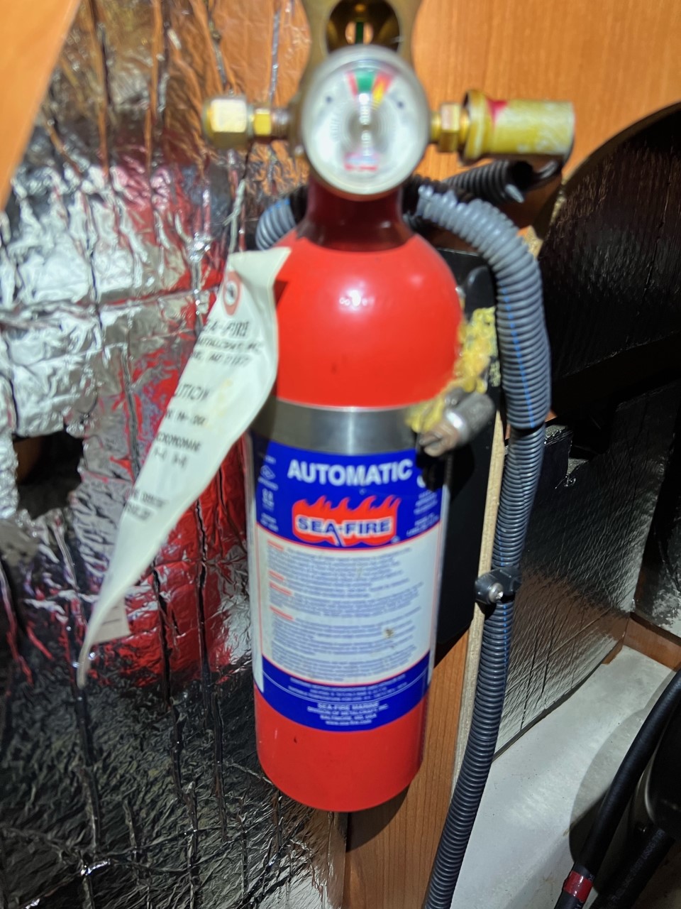

Just went through this and see next to nothing here on the forum I thought I'd post in case someone else is thinking about doing this.
Sold my 2009 H36 and one of the conditions of sale was to replace the Sea-Fire automatic extinguisher in the engine bay. Surprisingly it was actually reading high (see photos), which no one (Sea-Fire, the surveyor or my broker) could explain. Possibly a bad gauge, but worrisome. I had noticed it previously but it had always read at that level and I couldn't find anyone to test/weigh/tag it. The model number for the extinguisher is a white tag on the right side of the fire extinguisher as you look at the gauge (see photo - mine was an FG 50A model). You need to replace it with the same model and that tag is the only place with that information.
You can find the bottles online (e.g. Go2Marine, etc.) and you'll find the prices for a new bottle pretty dear. Mine ranged from $300-$800 online depending on where I looked. Plus hazmat shipping. Pacificfireandmarine.com seemed to have the best prices, but didn't see how much their hazmat shipping was.
The bottle removed painlessly, but you have to cut the wires going to the engine control panel and then rejoin them when you reinstall. Otherwise I believe the engine won't start without an override. Polarity doesn't matter. Mine didn't have a manual pull, so that may complicate things more.
After looking online, and needing a bottle quickly (within a few days), I contacted Sea-Fire in Baltimore, which is ~50 miles from where the boat is on the hard in MD. They were pretty responsive, but I recommend calling a customer service person on the phone once you get an e-mail response. They are pretty knowledgeable and helpful. Once I provided a photo of the tag and the gauge they indicated that my extinguisher (circa 2009) wasn't refillable, but they had the replacement bottles in stock (some they have to order). They took my old bottle and disposed of it, and replaced it with a new one for $495 in one day. While it appeared I could find it cheaper online I couldn't have gotten it in time to close on the boat, and the final charges with hazmat and fedex would've probably added up to more than what I paid to get it directly from Sea-Fire. Sea-Fire says that that bottle is good "for life" as long as the pressure stays in the green. Practically speaking you're still gonna get dinged if its tag doesn't show its been inspected, is my guess.
What I haven't been able to find is someone who will come out and weigh and tag the engine extinguisher. Sea-Fire doesn't have a recommendation, and any surveyor (or Coast Guard boarding team) is going to look at that tag and say it needs to be inspected and certified, which means it needs to be either removed and weighed, or weighed in-situ. Good luck with either of those for engine bay fire extinguishers. Would love to hear anyone else's thoughts on that front.
One last thought here. If you look on West Marine's site you'll see a Sea-Fire automatic suppression bottle for a WHOLE lot less - like $85. It is a different fire suppression gas (3M’s Novec® 1230) than the FM200 in the extinguisher I replaced. Both are gas, and (relatively) safe around humans (unlike the Halon they replaced) and used in the same application. Neither is harmful to the engine or electronics (or a mess to clean up). Would love to hear from someone knowledgable in this area, but they look to be for identical purposes and one costs 1/5 of the other for seemingly the same capability. Sea-Fire sells them both for the same application. I'll be looking into the Novec 1230 for $85 next time I need to replace a bottle and aren't up against a survey and time crunch. The cylinder for the Novec 1230 may need to be a little bigger to have the same effect, but otherwise looks to be better for the environment and cheaper. Here''s an info sheet on it:

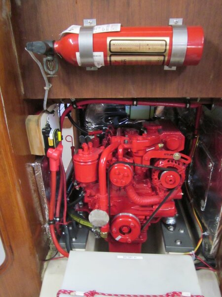

Very Interesting thread, about a brand of fire suppression system I had not heard of. Our boat came with a halon bottle in the engine compartment with a remote indicator light to show that it had not discharged. There is a gauge on the bottle.
I have had it recertified a couple times over the decades at a local extinguisher company. They remove the halon and weigh it, and put it back after the bottle is tested. Or something like that. They charge about 20 or 30 bucks.
I have replaced the remote indicator light when the bulb/lens cracked due to age. I also updated the wiring; it's on whenever the circuit is on for the lift pump. i.e. when the engine is operating. That's how Ericson wired it.
According to a surveyor, this fire bottle does not count toward the minimum number needed for our vessel. In any case it's useless as a portable fire fighting means. We have two of the 5# dry powder, and two of the 2.5# dry powder.

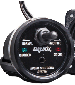

I have not heard of having this somehow tied into the engine starting circuit. That seems dangerous, since there would be emergencies when you need an engine quickly and would not want to have any possible electrical circuit problem to trouble shoot.
Speaking of certification, my insurer wants all of the extinguishers to be "in date". Considering the danger of a fire on board, I am inclined to agree with them on this point. I know a couple of surveyors that have said that too many sailors do not realize that a sinking might take over15 or more minutes before they would have to step up into a life raft, but a fire on board often requires an exit in under 30 to 60 seconds.

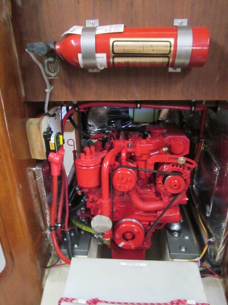

I will add a picture of the $$ extinguisher in place, and this all normally covered by a one-piece set of FRP steps

As to the extinguisher circuit being wired to an engine cutoff, that is required (it clearly says so on the manufacturer's website). The reason is that if you have an engine fire and the extinguisher goes off, it needs the contents of that extinguisher to stay in the engine room to extinguish the fire. If the extinguishing gas is drawn out of the confined space too soon by any means either the fire will not be extinguished, or it will re-flash. Also, shutting off the engine shuts off the fuel pump, which hopefully keeps any more fuel from being fed into the situation. To your point about needing an engine quickly, the fire is the most dangerous thing at the moment while its going, so allowing the extinguisher to work sufficiently is more important than anything else at that time. In the rare case that the system shuts down the engine in error, there is an override installed at the engine panel in the cockpit to cover that possibility (see pic below). But you'd better check to make sure you don't have an engine fire before hitting that override. Your installation may be different, but on the boats I've owned that have had such a system installed that's how they're set up.

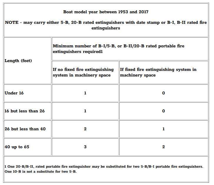

So, if I read the chart for “no fixed system in engine compartment”, and have the required number of portable extinguishers, I would think I would be ok.
but who knows…
might depend on the CG personnel conducting the inspection.
I could just remove the halon bottle, but I would rather have it in the engine compartment 1) in case of fire and 2) in case it fires and snuffs out the flames. if not, I am in no worse shape than if I didn’t have it…I would resort to portable extinguishers.

My guess would be a Coast Guard inspection team would treat the "extra" extinguisher (e.g. your engine room halon bottle) like they do expired flares. As long as you have sufficient UNexpired flares (or fire extinguishers) onboard to meet the requirement, having some extras that are expired don't count against you, and provide some measure of backup or a potential additional margin of safety.
