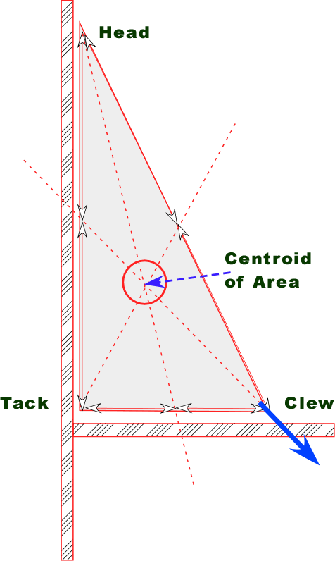

The 'plain vanilla' attachment point for the clew reefing line should be adjusted so that both the tension along the foot and leech of the reduced area wind up with 'equal' tension. A sliding cheekblock (for the reefing attachment) on the boom is the best way to get the angle correct ... and the foot/leech not unduly overloaded. If this arrangement isnt correcting the amount of heel to a comfortable angle, then reef 'deeper' !!!!!!!!! instead of the potential of 'busting' a sail by over-tensioning an edge.
From the attached pic below, you want the stress to pass through the centroid of area in the reduced sail area ... this will ensure equal stress along the leech and foot edges for
good sail shape as the sail designer intended (even when reefed).
How to find the 'centroid': divide each 'edge' (foot,luff,leech) in half and draw an imaginary line from the 'corner' that is opposite of the 'side' ... where the three bisecting (dashed) lines meet is the 'centroid' ... and thats where if a single line (solid blue arrow) would 'point' if there was only one single reef line at the clew.
