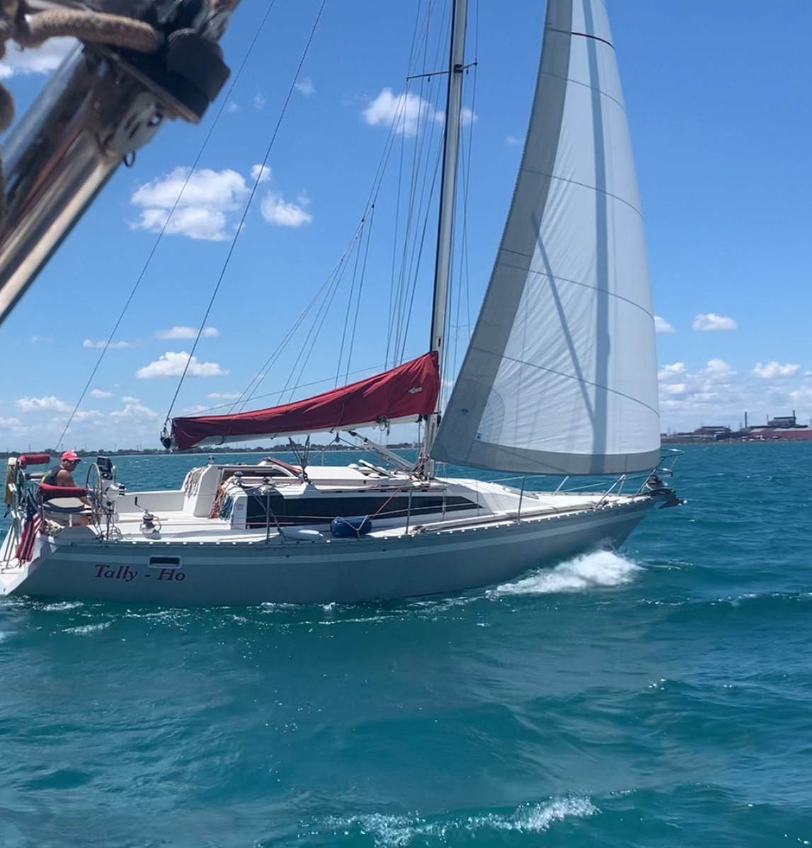

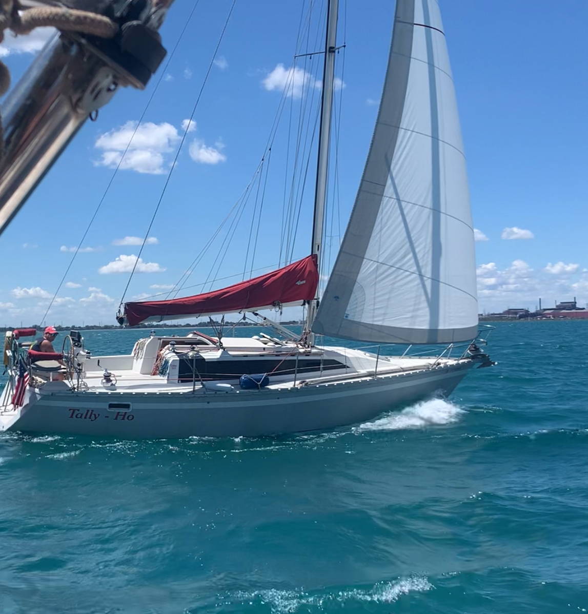

I have a Mack Pack sail cover and lazy jacks…so when I reef, the cloth below the reef is basically in the bag. :)
I usually set up the reef at the dock if I think the winds dictate. Or if I am really lazy, I will go jib only in windy conditions.
My Strong Track and the nice SS slides make it possible to pull down a reef by easing the traveller as Haydon showed in his video. Shaking out a reef the same way. I still play around with double reefing options, trying to get the best reef…I still like dropping the sail and setting the Tack on a reef hook at the mast….but that requires me to leave the helm and go to the mast. So I still experiment with different options. Right now, I have small blocks at the tack cringles and a single line reef line.
Here is a double-reefed main…
But I almost prefer going out jib-only in a strong blow.
