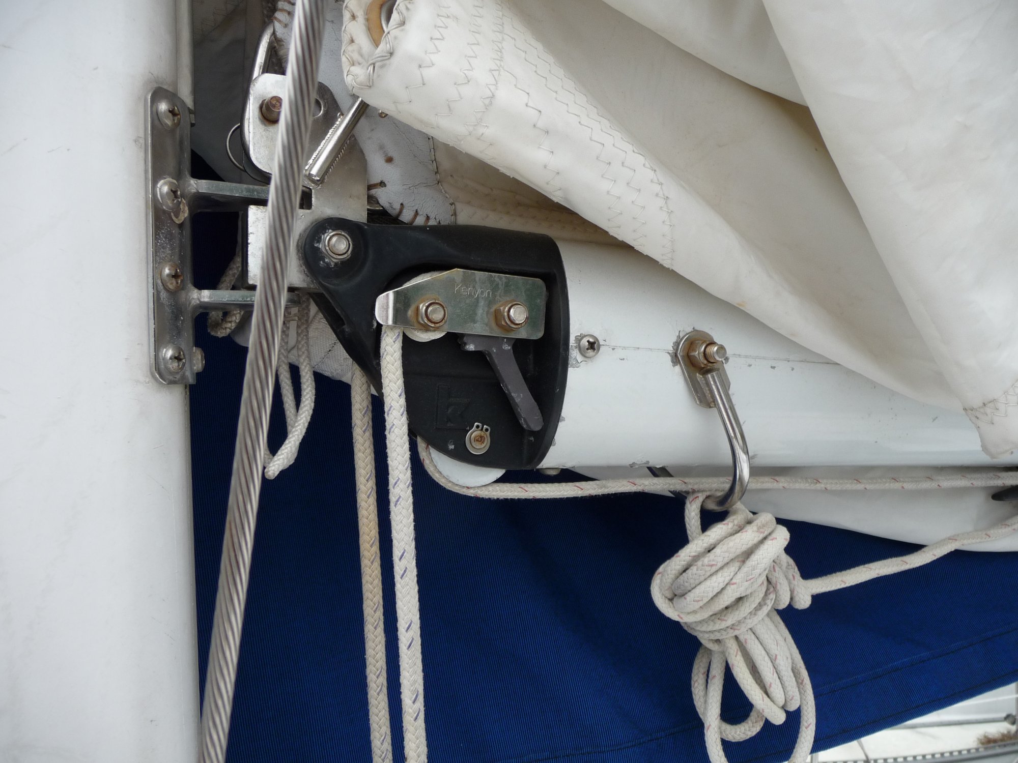

3/8 or 5/16.. It has to be big enough to feel good in your hands.. I have 3/8" Mine are led back to the cockpit, but I have to go to the mast to hook the reefing tack . The reefing lines are the two vertical lines going down to the deck blocks then to the organizers then aft under the cover to a cleat next to the clutches..
So do I.
I figured since I need to go there for the hook, might as well do all the work in one place at one time. Reefing lines are at the mast. So is the halyard. It is nice not having to go back and forth if the main halyard gets stuck in a clutch when I need a little slack.
