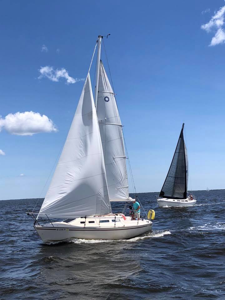

I pulled a few photos from the facebook page that illustrate our problems in Race 2 :( We're in he center having crossed the line first, but by this photo from the committee boat, the Tartan 40 was blowing by us. The eventual winner is the boat on the right side of the picture.

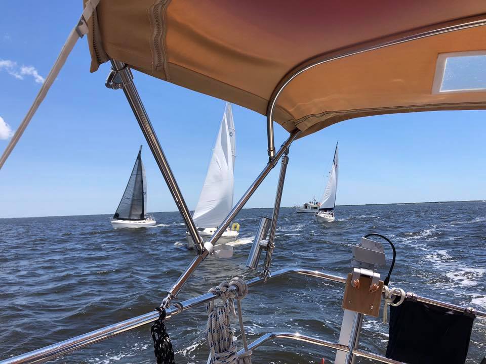

This from the Tartan is just after they have passed us. Now, my reefed headsail is showing obvious problems as does the boat directly behind us. The Catalina 30 with laminated tri-radial sail is rapidly gaining and will soon be out in front of us, but will trail the Tartan until much later in the race.

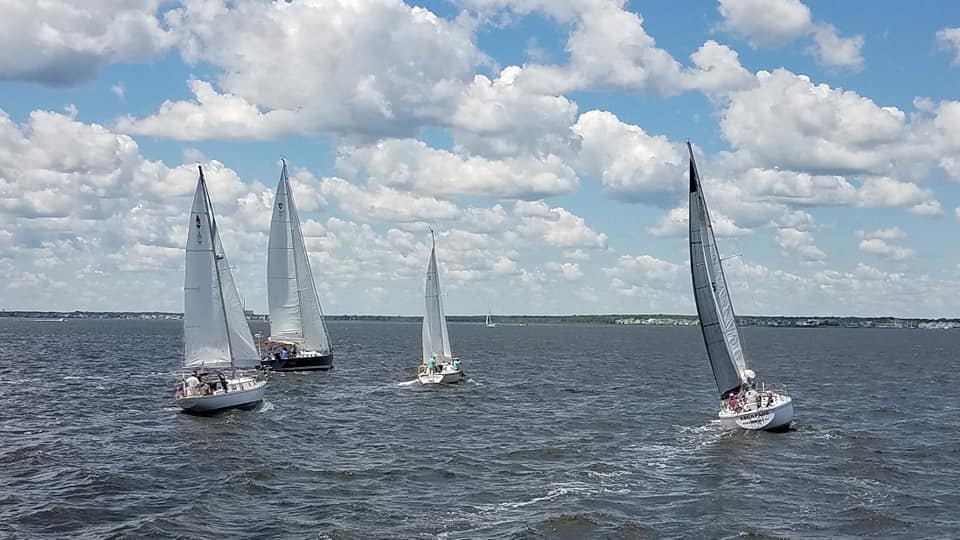

I think we're trying to point to high but I'm guessing the furled headsail is not a good shape. That tri-radial sure looks nice and fast! They'll soon be gone. Just after the first upwind mark we took the reef out on the mainsail, but we continued to reef the headsail on upwind legs. I think that hurt our position a lot.

Three thoughts/things:
1) You need to sail your own race, and sail within your boats limits. If you cannot point with other boats, don’t try. To the degree that this is a function of the boats design, your rating will factor that in. Always sail fast.
2) The sails look tired. And in particular, the genoa has way too much depth (belly) in in now. A foam on the luff designed to pull in extra fabric in the middle might help that. In that second picture it looks like you are way too high, its hard to backwind even a blow-out genoa like that.
3) get sails designed for where you race. If you are always racing in the breeze, get a jib. The downside is you are non-spin, so I betting you like to roll out the extra sail downwind. So maybe the rolled genoa is your best bet. But even on a new sail, the foam luff will help.

Nice evaluation. Looks like Afraid Knot has their headsail furled about the same amount and has the same shape issues.
Do laminate headsails hold their shape better, allowing the boat to point higher?
Bummer about being out of sailing for the month.
Often boats will not notice that until they are racing. Then they try and hold a lane, and that happens.
A sailmaker can add a foam luff to a sail to help correct the extra depth. He might say the sail is too far gone to matter.

You and the Catalina with the laminated headsail had a good idea: reefed main, but the Catalina kept it's genoa full for best/fastest shape. That reefed sail plan can work well for many boats racing.
I think :) you should have let the genoa out full size to get a good shape, cracked off a bit for better speed with a little twist in the main to keep her on her feet.
Sail fast - first, pick a direction, second. If you sail the boat well, your rating should make up for the smaller slower, less weatherly boat (in theory).

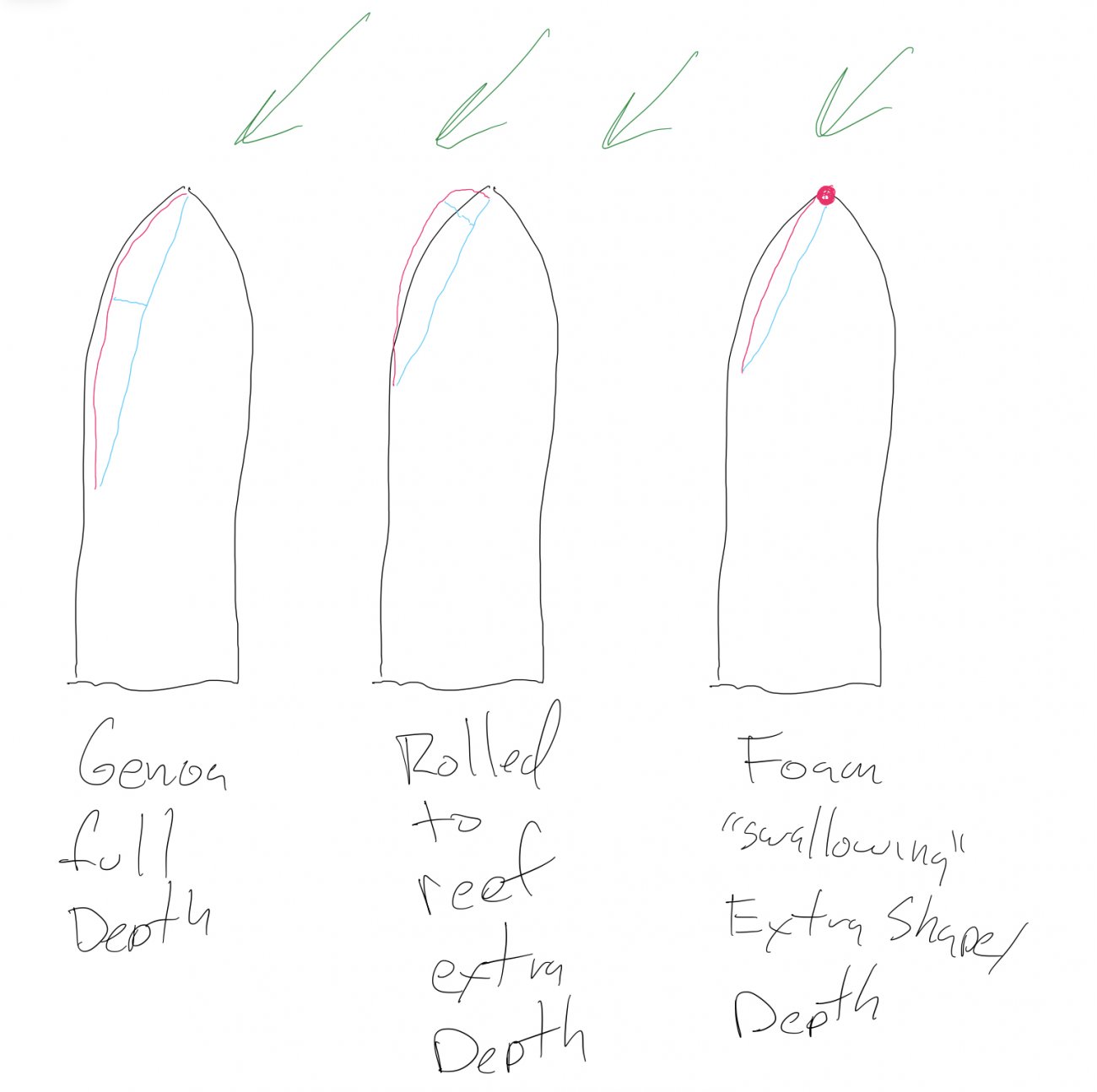

Had a PM asking about the function of the ‘foam luff’. Said I would answer here.
Regard the drawing below. Any headsail has ‘shape’ built into it; the draft depth that gives it its airfoil shape. This shape (or extra sail cloth) is greater in the middle that it is at their edges.
You can see this on the left. The full genoa has draft built in to the sail at the expected furling point. The sail is in RED, the chord and draft line in BLUE.
The middle shows the sail furled to that point. The foot and leech roll tight, but the fuller middle section sags out as it cannot roll tightly. Now the leading edge of the middle of the sail is way too ‘full’ and billows out, actually getting blown back ‘backwinded’ by the Apparent Wind hitting the luff when sailing closehauled. This is most noticeable when racing and trying to point... when cruising most will crack off and the symptom goes away.
With foam strips (or rope etc) sewn strategically into the middle of the luff, the extra bulk rolls the draft tight, and presents a much better shape to the wind.
Note that is is not a sometimes problem as suggested in earlier posts... this will happen with any large genoa rolled down to a jib.
The foam while a good idea is not an ideal solution.. the foam disturbs air when fully unrolled, and the thick rolled luff solves one problem but creates another.. namely a object blocking the smooth air as it approaches the sail.

Based on the photo, that headsail looks like it’s 145 or 155 LP reefed to the area of approx 100%. By taking some measurements off the photo, I estimate it’s reefed to a 20% linear reduction, which corresponds to a 36% area reduction).
Even with a luff pad, that’s not going to be a very close winded sail if you reef it down that small. 150% genoas have a comparatively deep draft for extra power and they don’t reef very well compared to a 135. That’s true even though sail designers make the draft on reefing headsails little shallower than non reefing ones, and they also add a luff pad to get an acceptable furled shape that is without wrinkles and a shallower draft.
Here’s the bottom line: You can’t sail as high with a reefed sail as a purpose-designed sail, and that’s doubly true if you reef a 150-ish more than 10%. If you want to race your cruising sailboat competitively, be prepared to change headsails to suit the conditions of the day, just like a competitive racer does. Get a new 135 with UV cover and luff pad for cruising....
plus a dedicated jib and a genoa without the extra and expensive UV cover and luff that a cruising headsail requires. That’s the best of both worlds.
Roller reefing headsails are wonderful for cruisers who want convenience and who don’t want to change sails, but a boat with one single RF headsail can’t compete with a boat that Carries three or more headsails, each one optimized for a very narrow range of conditions.
Furthermore, I’m sorry to say that the mainsail looks tired and stretched out to my eye, and I suspect the same is true of the Genoa. :( (Please don’t shoot the messenger). Your boat will sail much flatter, faster and higher with new sails.

Also, be aware that when you are sailing on someones weather hip like that you will be feeling a header as the wind is bent off their sails and diverts the true wind coming into your sailplan. So, all things being equal, the boat to weather will not be able to point equally to the leeward boat. Tack and get out of there, then sail your boat and don't pinch!
Pretty sure they got rolled by that Tartan 4000 who took that picture... so that situation will not last long! ;^)
