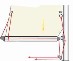

The simplest solution in my opinion is a two-line reefing system, one for the tack and one for the clew, run back to the cockpit. The line for the clew runs straight through the boom to the aft end. You can even run the clew line outside of the boom but I wouldn't. Looks something like this:
Maybe I’ll convert!!

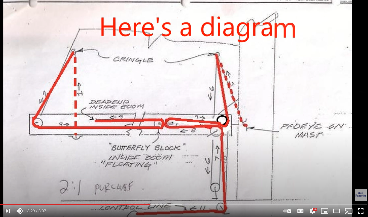

Our P31-2 has a single-line reefing setup, and has similar if not the same hardware (boom, pulleys, blocks etc.). When I got the boat a PO had changed the arrangement of the forward part of the system to remove turns and simplify the whole picture, as below.
On our P31-2 this revised system has worked very well, see
A well-functioning single-line reefing system is a joy to use and I would try resolving your problems with it.
PS> You need to be sure that there are no fittings installed on the boom that protrude inside the boom, as if so, the shuttle blocks will tend to jam on them, getting damaged and causing the reefing system to be unusable. The PO of our boat has installed lazy jacks, whose attachment bolts extended inside the boom, damaging the shuttle blocks and causing the system to hang up. The first winter I took the boom home, took the endcaps off, replaced the shuttle blocks and cut down all the bolts used with the lazy jack fittings and re-assembled. The system has worked faultlessly ever since.
