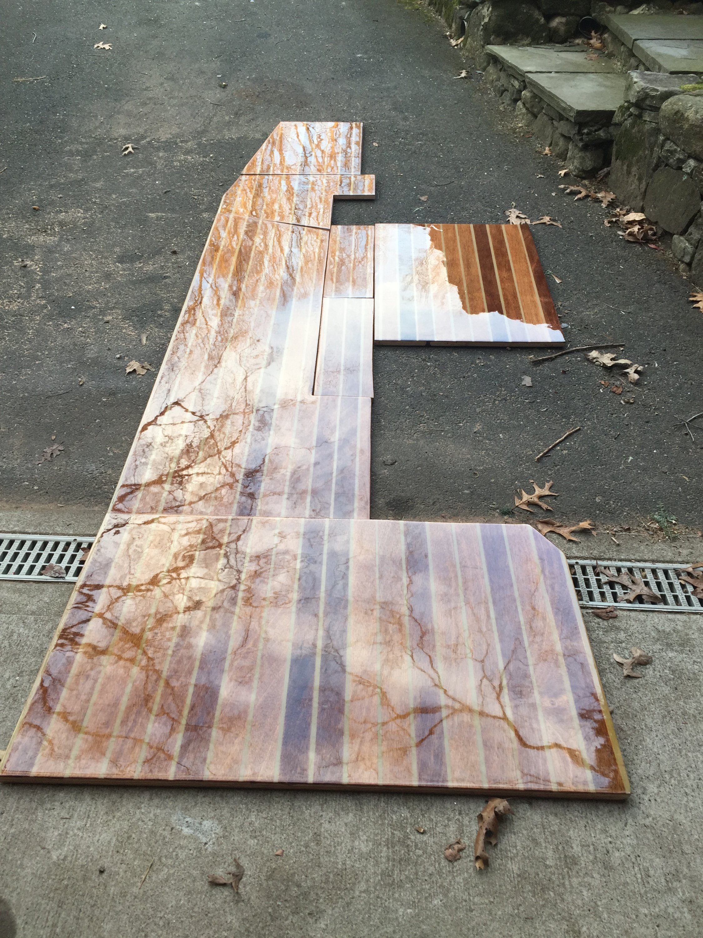

Redid my floors on a C&C 32
Mar 11, 2016
6
C&C C&C 32 Stamford, CT
I stained the stripes then used a combination of epoxy and varnish to get the shine.

I knew it was something more than just varnish.
These steps were done about five years ago and were covered with glass cloth and epoxy plus varnish for UV protection. Lots of grubby, sandy little feet over the years. The glass completely disappears in the epoxy as they both have the same refractive index.

I'm in the process of replacing my sole right now. What type of wood did you use? Due to high cost and shipping, I'm looking for alternatives to teak.
Jan 4, 2006
7,641
How did you do the nonskid section on each step?
I probably shouldn't say as I'm still waiting for the patent to go through but ..................
  1. Taped off the narrow sections I wanted to cover in non skid.
  2. Applied varnish by brush to these taped off areas.
  3. Sprinkled ground up silica (quartz) on the wet varnish which acted as an adhesive.
  4. Peeled off the masking tape while the varnish was still wet.
  5. Let varnish dry.
  6. Applied a few more coats of varnish to all of the stairs for UV protection.
  7. Once the varnish was dry and hard, installed the stairs.
PS. Please don't let this get around :shhh:.

Feels rough and abrasive under bare foot which is what keeps you from doing the splits or worse :eek:. The abrasive has stayed in place for about five years now. I recently added another bit of abrasive along the leading edge and then covered the old and new abrasive with an additional couple of coats of varnish.
Jan 4, 2006
7,641
What varnish did/do you use?
Nothing special as it was an "inside job". First thing that came to hand, off the shelf was interior gloss Varathane. Just wait until is has thoroughly hardened before installing.

And then you mixed it with epoxy, right? what type of epoxy? i know this sounds basic but im really new at this and im replacing most of the interior wood and i want it to look nice and also last.
Jan 4, 2006
7,641
Egads ................ absolutely not :yikes:. Don't know what kind of a witch's brew that would produce.
The epoxy, which goes on first, provides a hard, waterproof encapsulation and the final varnish coats protect the epoxy from UV damage.
System Three is the epoxy I use but West System and others all supply pretty much the same products. Read the the Epoxy Book for System Three before starting your next project.

Like I said, I'm new at this. Thats why I ask so many questions, many if which I'm sure seem down right basic to those with experience. I rely on the kindness and understanding of folks like you Ralph to guide me and I have not been disappointed yet. Thank you so very much for the cobtinuing education. Now, since some of my new wood already has multiole coats of varnish on it can I reverse the process and put the epoxy on top of it and then recoat with varnish on top of that? I'm guessing not but it does not hurt to ask.
Jan 4, 2006
7,641
I've never been in a position to epoxy over existing varnish so not too sure how it would stick. I'd go slowly and experiment with scrap pieces to see what results you get.
