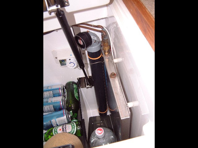

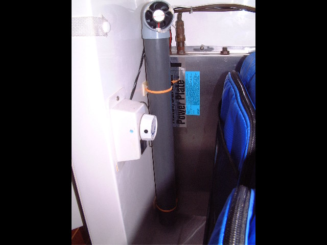

Feb 10, 2004
4,253
Hunter 40.5 Warwick, RI
Whose or what fans do you use? I've seen some that say they will run up to a month on a C or D battery I believe and I've considered some computer fans on 12 volts, but don't know if they would like that enviornment.[FONT=Arial, sans-serif]http://purplesagetradingpost.com/sumner/macgregor/macgregor-links-1.html[/FONT]
I once borrowed one of the small square fans that run on 2 D-cells from a RVer friend. I was encouraged by the result of helping to keep the temperature even across the box. But the box fan has the disadvantage of getting buried in the box and the air doesn't circulate. This doesn't happen in a conventional refrigerator with shelves like in a RV. You also need to turn off and on when you leave and return for battery life.
So I designed, built, and installed a fan system that runs from the ship's 12 power and will pick up cold air from the bottom of the box and blow it across the top of the food to the opposite corner. This design always works and requires no action when arriving or leaving. The fan is a small 12V computer fan that I selected to fit into the end of a 1.5" PVC elbow. The power wires were routed along the refrigeration lines back to the compressor and then connected at the compressor. The fan runs continuously.
I have a second fan in my freezer compartment and that is wired to the fan in the refrigerator. Both fans can run when the refrigerator has power so I put a small toggle switch on the freezer fan so I can turn it on only when we actually run the freezer. These connections eliminated the need to run the freezer fan wires to the freezer compressor.
I have had this fan system installed for 10 years with no problems or maintenance issues.
Bottom line- go ahead and install a computer fan solution. I think you will be happy with it.
Sumner
Jan 31, 2009
5,254
....So I designed, built, and.....
... installed a fan system that runs from the ship's 12 power and will pick up cold air from the bottom of the box and blow it across the top of the food to the opposite corner..
Thanks, that is exactly what I needed to know and I like that installation. I'll copy that for sure :),
