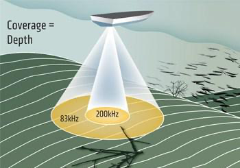

How helpful is a depth sounder in that situation? How far ahead does it scan? Is it enough to stop or steer away from such an obstruction or are you looking for the clearance start dropping as the bottom is approaching? I am not familiar with depth sounders or their operation, but I figured they wouldn't protect against sudden obstacles, only upcoming clearance limits.

Snoopy. The answer to your questions.
  • How helpful is a depth sounder in that situation?
    • Not very. Depends on how fast you are moving, how good are you able to recognize the changes in the bottom depth, how quick you are ready to put the boat in reverse, and how effective your boat systems are to stop the forward movement of your boat. A good skill building practice, go out in the water and practice emergency stops.
  • How far ahead does it scan?
    • Your system will be a sending out a signal that takes the shape of a cone.
    • If you have it near the bow it will be reporting more of what is ahead of the boat bow only at a depth that extends in front of the boat. You can buy a "forward looking depth finder (sonar)" but that will put a protuberance beneath the hull. They act to slow the boat down by adding drag.
  • Is it enough to stop or steer away from such an obstruction or are you looking for the clearance start dropping as the bottom is approaching?
    • Yes to both of these questions.
You should not worry about this stuff. If you spend any time on the water you should just expect to run aground. Expecting this to happen keeps the idea on your mind when you are planning your route to cruise.
