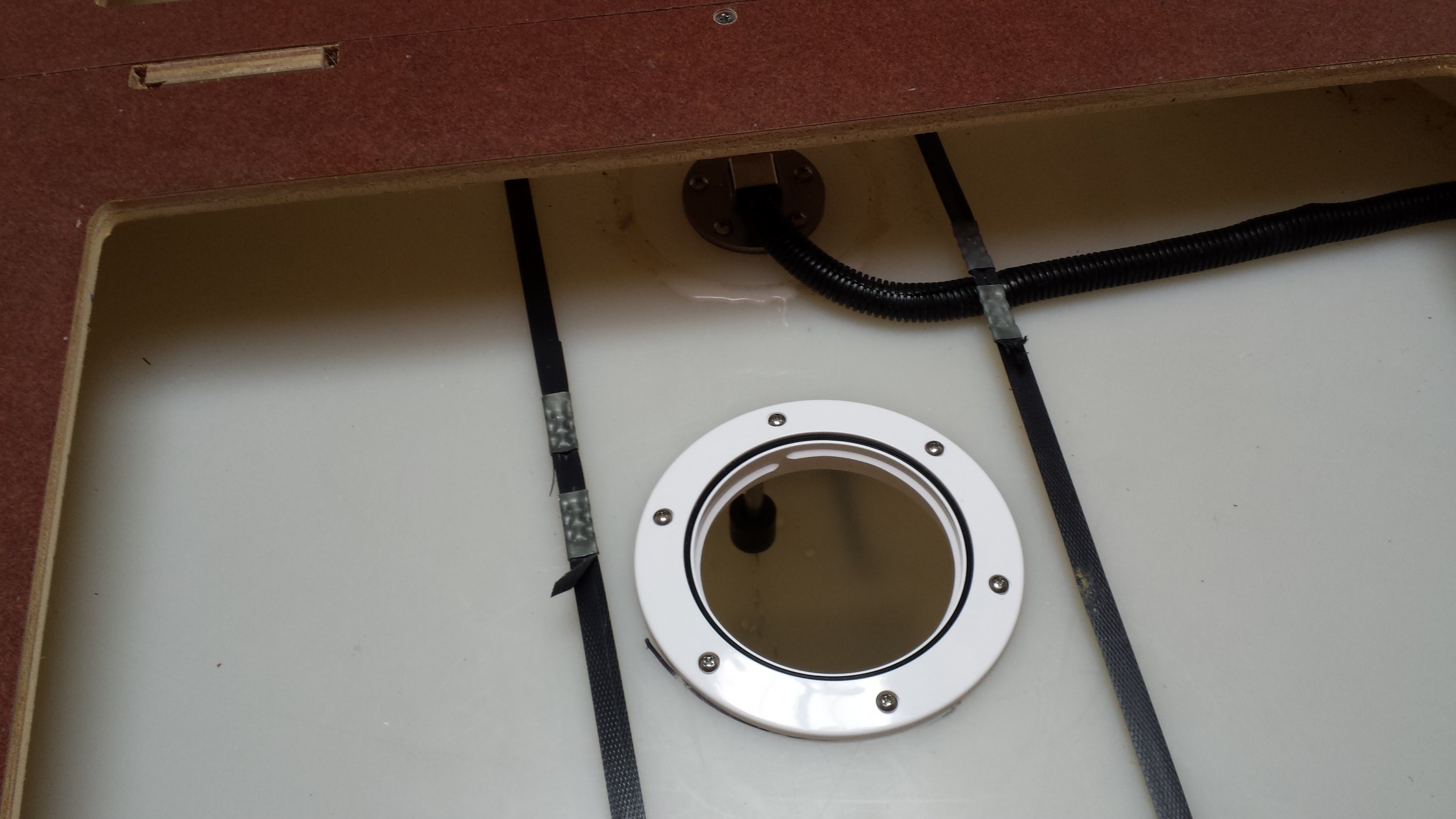

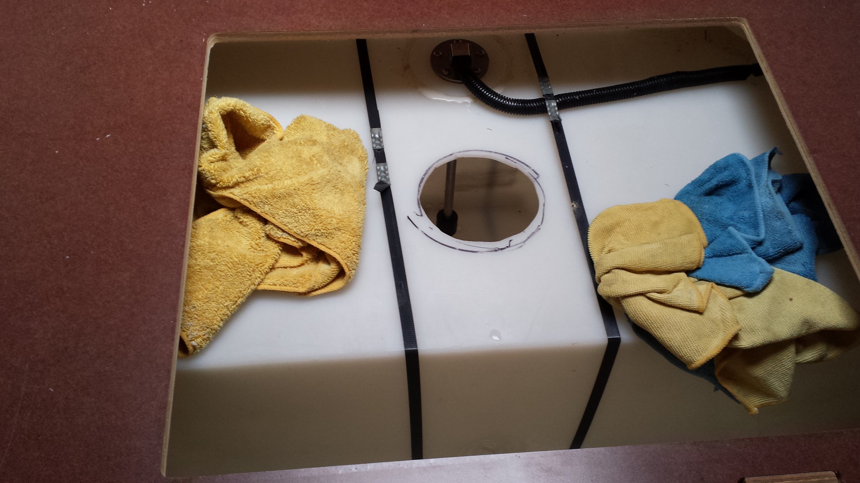

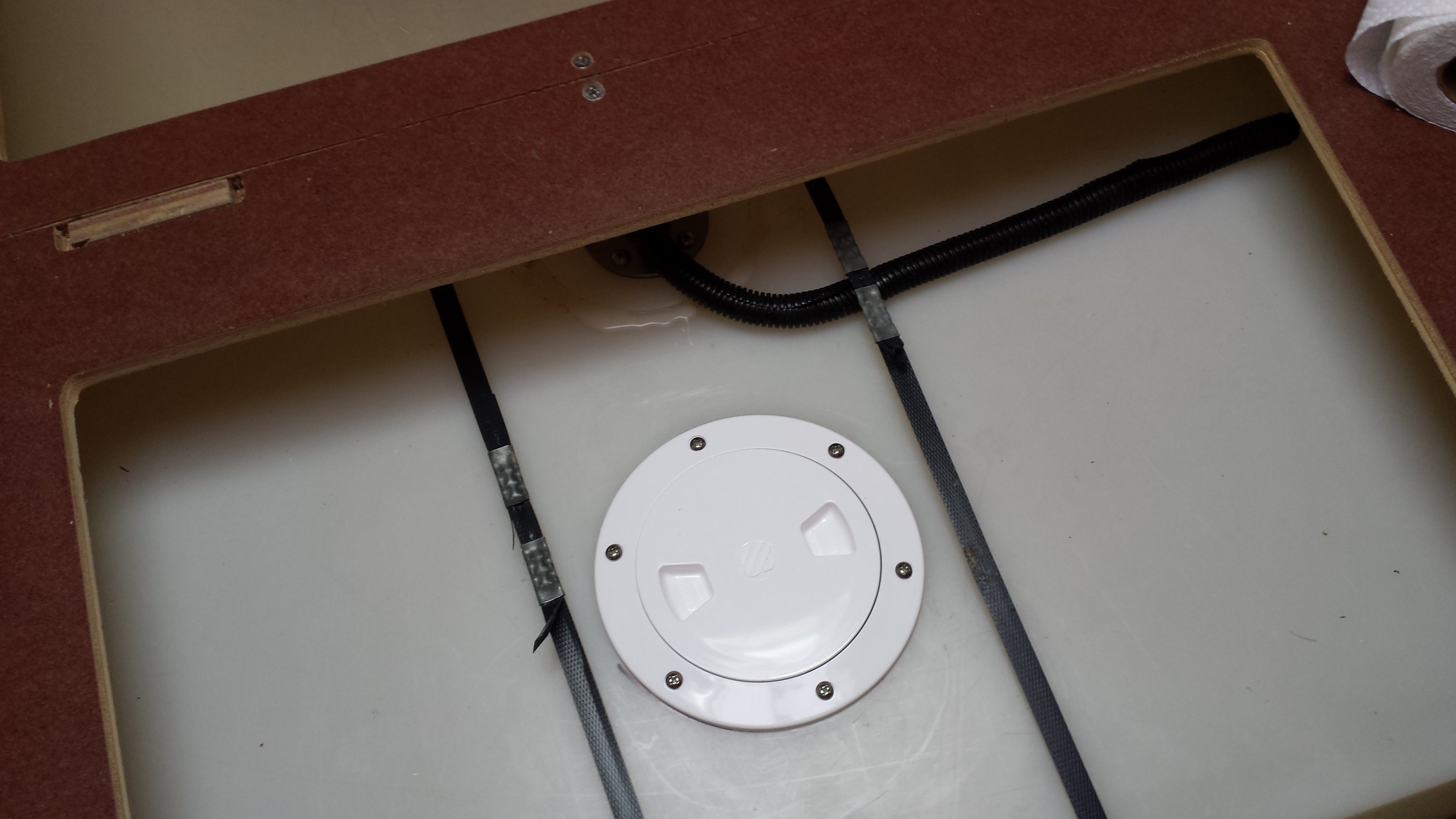

A year or 2 ago I had to replace my Water Tank fill meter and had to install one, here are a couple of pictures of what I did.

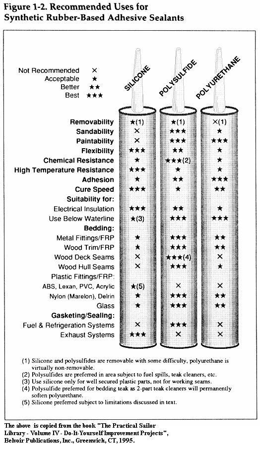

Years ago (1995!) Practical Sailor published a an adhesives guide chart that I saved to my files and still have it. 22 years have passed since during which there have surely been many advances in sealant chemistry...but y'all might still find some value in it.
