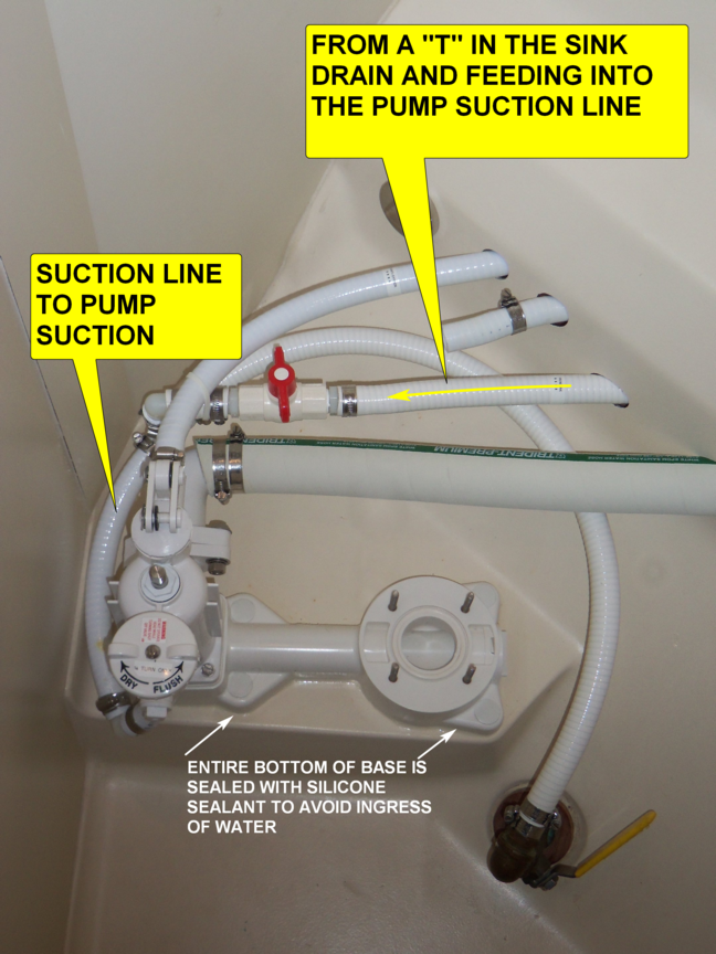

If by "hand flush" you mean a manual toilet, those should never be connected to the fresh water plumbing due to the risk of contaminating your potable water supply and every toilet mfr specifically warns against it. Some people just keep the intake seacock closed and use the shower head to flush, or install separate water tank to supply flush water...about 5 gallons should be enough...it will have to be vented btw.
Or you can reroute the head intake line to tee into the head sink drain line. Keep that drain seacock closed except when using the sink...use the sink to supply flush water. Better yet you can use seawater (seacock would have to be open) to flush, switch to sink water (close the drain seacock to do this) last thing before leaving the boat to sit to rinse all the sea water out of the entire system--intake line, pump, channel in the rim of the bowl AND the toilet discharge line. This is my favorite way to do it.

Jan 4, 2006
7,757
My lavatory sink doesn’t drain below the waterline, so I can’t use Peggy’s drain trick.
Greg, don't see why you can't use your sink drain as a source of flushing water once you close off its thru hull valve. The entire drain line now fills with water and act as a source of flushing water. Sort of like this as the new Raritan was being installed :

Jan 7, 2011
5,976
Oday 322 East Chicago, IN
I could if I wanted to plumb an extra feed line into the pump (which I don’t).
shower wand is just to convenient and simple…
