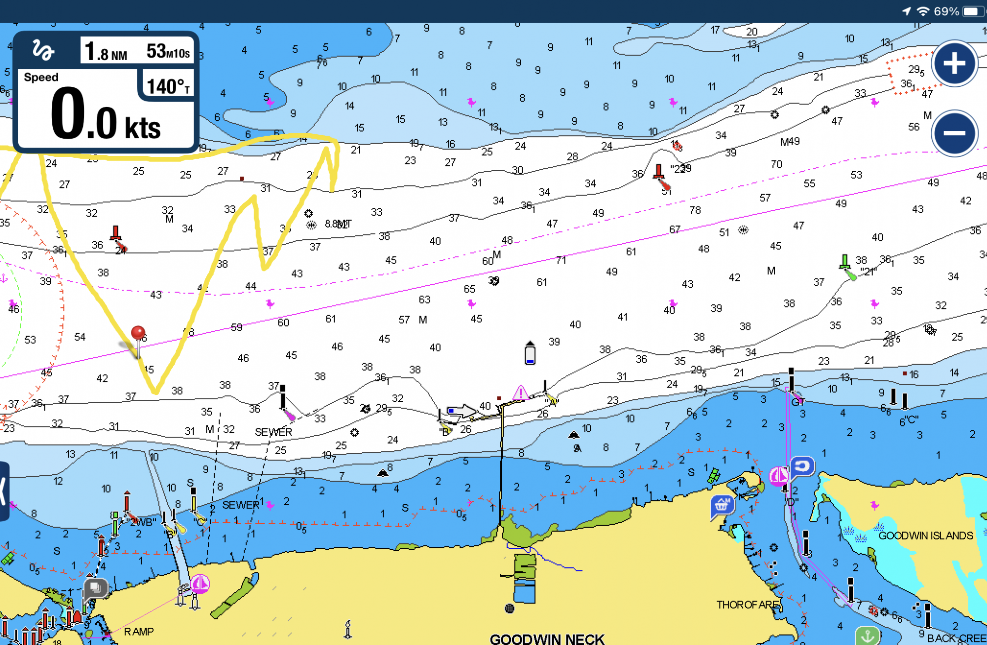

Does anyone have issues with Navionics (Boating app) active tracking - specifically speed (kts) measurement? I frequently (mostly) find it reads 0.0 but will occasionally blip and show actual speed for a few seconds, before all too quickly returning back to 0.0. I find my tracks are recorded otherwise, but distance traveled is not calculated correctly at all. I’m using Navionics on an iPad Pro (with cellular/GPS chip), but have also tried it on my iPhone 11 with the same issue (both running iOS 14.8 and now 15.0). To further test, I’ve pulled down the “Waterspeed” app which records perfectly on all my iOS devices, including my Apple Watch! So, this leads me to conclude this is a bug in Navionics. Anyone else have similar experience?

Does anyone have issues with Navionics (Boating app) active tracking - specifically speed (kts) measurement? ...
We've used Navionics quite a lot, and I haven't ever seen that problem (over the years, we've used a 2012 iPad, an original iPad Air, and currently a 2016 iPad Pro). Hope you can find a solution.

@Two Sails I suspect the app’s been disallowed from using your location. Is your device managed by corporate Mobile Device Mgt settings?
Check this: In the iOS Home Screen go into Settings, Boating, Location, then select While Using The App, then select Precise Location
Boating is indeed set to Precise Location in my Location / Privacy settings. No management profiles on the device at all - it is a personal device. My iPhone 11 does indeed have a management profile, but none-the-less, I am still able to manage the location settings and had configured it as above as well.

@Two Sails IDK what could be causing this - especially since other apps are picking up GPS info. I'd check with Navionics support forums and contact the company support. If not, try removing the Navionics app and all it's data. then reinstall from the app store.

Does it do with both when off the boat? Also make sure appropriate updates are in place

So off the boat, it seems more accurate for sure. I need to do some more testing, but if I forget to “stop” my track and jump in the car, the speed measurement starts to record far more accurately. So couple additional things I have noticed:
1. Higher speeds (like the car) are more accurate. On the sailboat, going below 4kts say in light winds - it almost always stops recording.
2. The area I sail in is the mouth of the lower York river, south Chesapeake Bay. The area right outside the marina is a coast guard station and just up river is a naval station. I’m wondering if there is any type of disruption of signal given the sensitivity of these areas. Again though, my track is recorded, so it tells me my coordinates are updating and my watch and other speed apps work perfectly.
