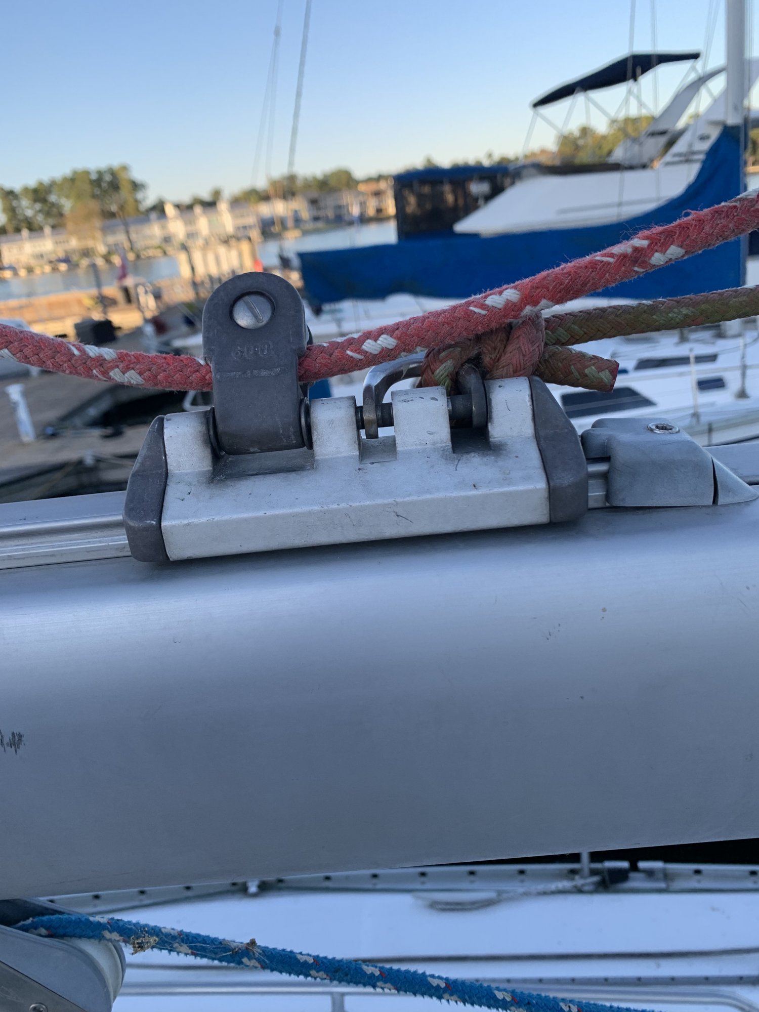

The sail on my 331 is very difficult to pull out of the mast. I’m pretty sure it is the Outhaul car that is the problem because I can manually pull the sail out at the mast by hand but very difficulty using the control line. so I cleaned the ball bearings in the car and it got a lot better but unfortunately I made the mistake of pulling the car off the track to see if I could ”get it even better” and of course the ball bearings flew everywhere all over the entire boat.

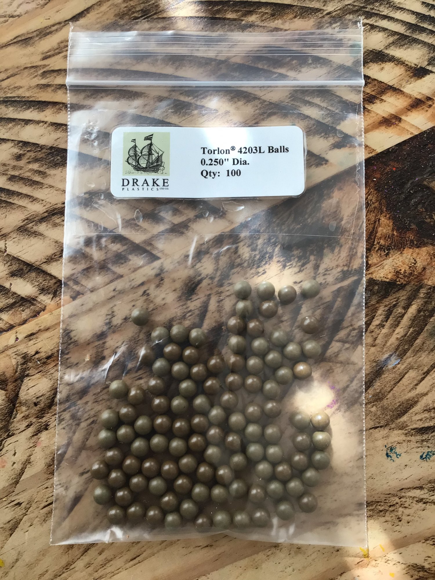

Fast forward two weeks and I now have a bag of new balls I just need some help on how to get these installed without using a pre-loader tool, is this possible or do I need to buy this tool? Has anyone had any luck with this or should I go buy a tool for it?

You can do it without the tool! But you need two set of hands. One to hold it together while the other feed the balls in.

I did this with my traveler which has the same type of car but is a Garhauer. I started by dabbing a bit of grease on each ball as I slid it in, just to keep it in the slot while the car was off the track. When I went to put the car on the end of the track I realized that if you hold the car just hanging off the end of the track you can slide the balls in without them falling back out, just a dab of grease on the end to keep them from rolling back out, or hold a finger over the bottom open slot. An extra set of hands would help, but doable with only two hands.

You can do it no issues using a dab of grease then washing it out after as it will collect and hold dirt putting you back to where you were. Another way that is easy ,although involves work is to remove the boom and stand it up vertical ,now the balls drop in going no where, put the last few in the cap with grease ,put cap back on

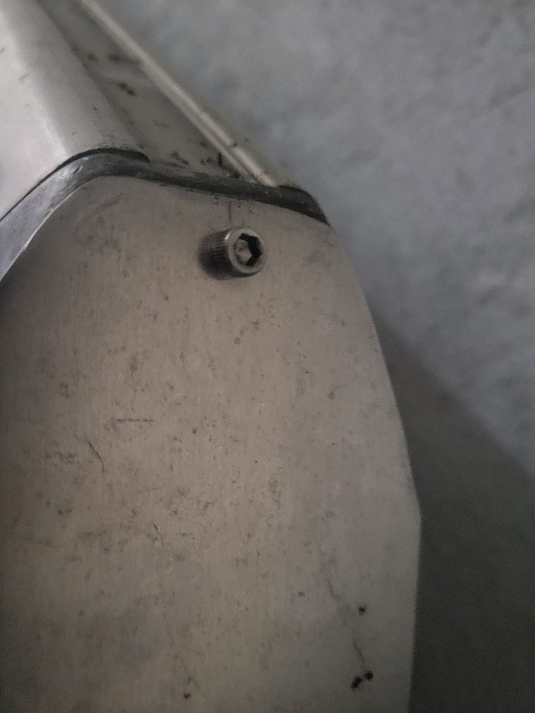

They should have put an end-cap on the boom. Mine is completely open at the back end!
Perfect solution…
Mine only cost me the Michigan 10 cent can deposit. Drink the contents and push the empty into the boom end. I only had a problem in the Spring when I removed the winter cover, and birds would begin to build a nest.

I did fabbed one out of sheet aluiminum ,not a good picture boom is hanging on wall in my garage drilled and tapped
I was thinking maybe some type of netting to get some airflow in there so the line doesn’t rot.
