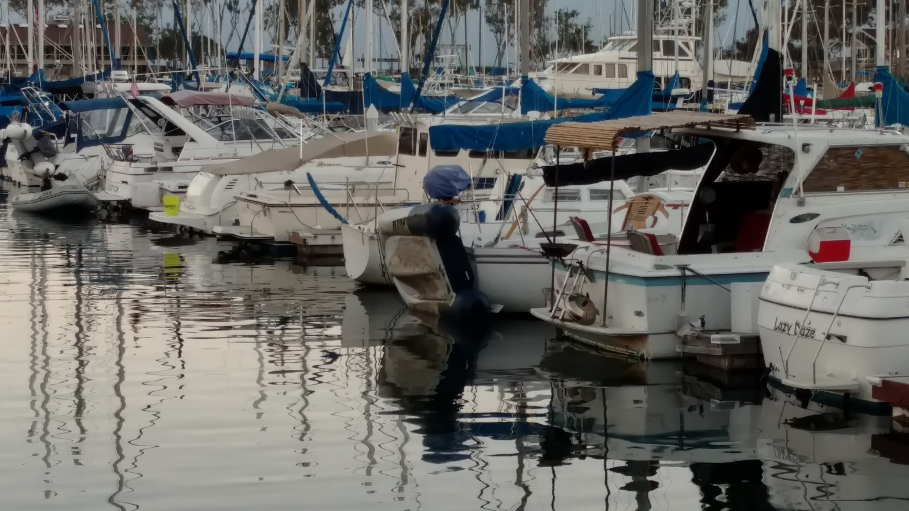

So I managed to hoist the dinghy out of the water (single hand) and secure it to the stern railing. Not as hard as I thought.
Next is cleaning the bottom.
