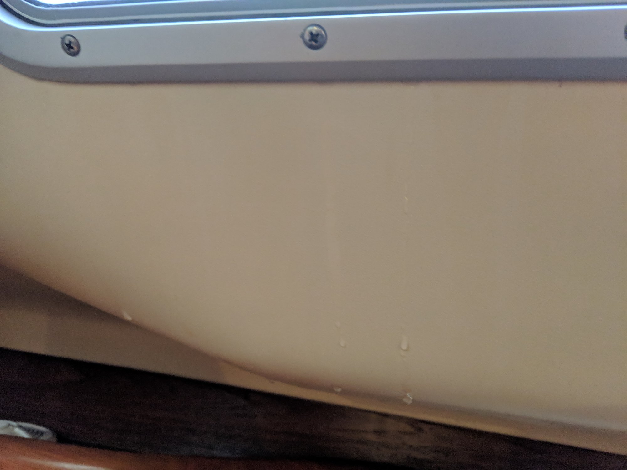

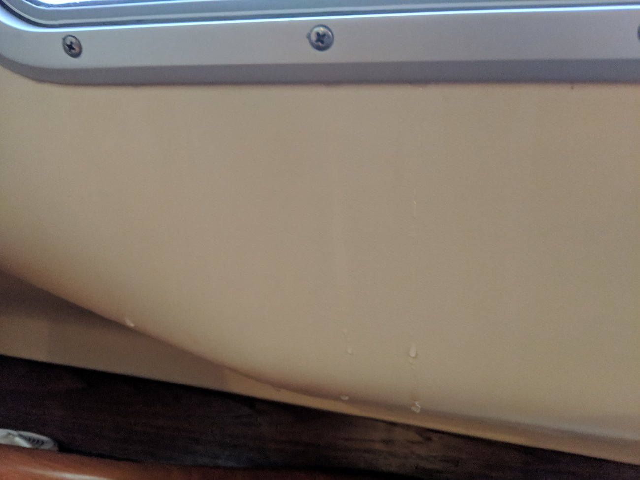

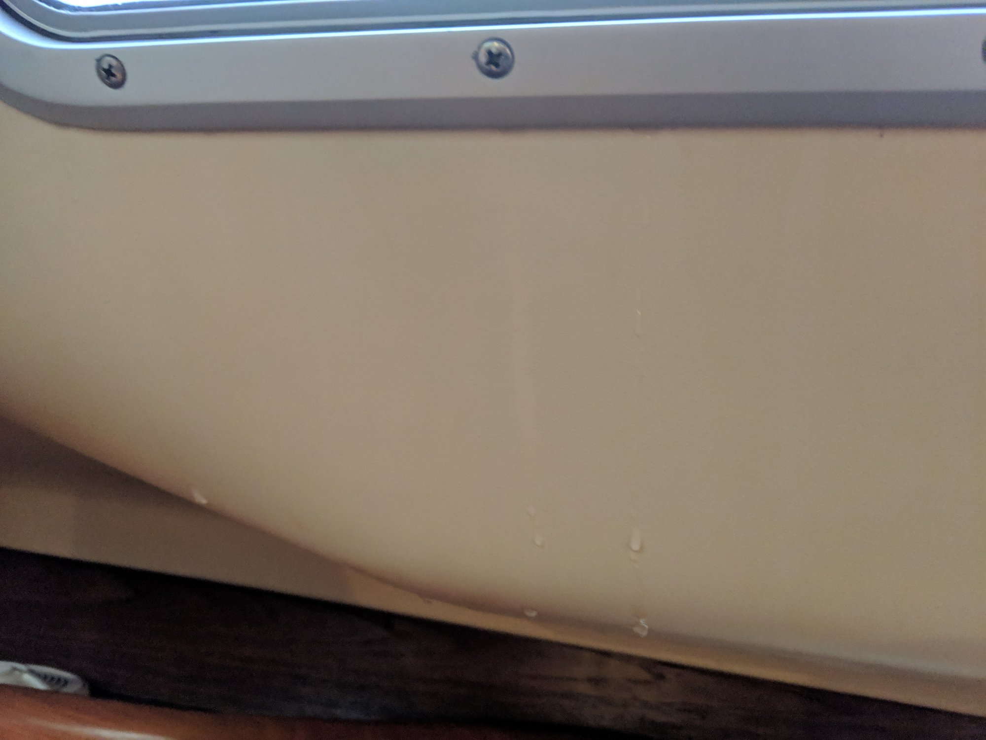

Continuing in my quest to rid the boat of leaks, I've been getting a good amount of water coming in through one of the fixed portlights on my 03 356. It's the starboard side portlight, aft of the bulkhead. I have water coming in from under the frame, as well as running down the liner and onto the top of the galley cabinets.

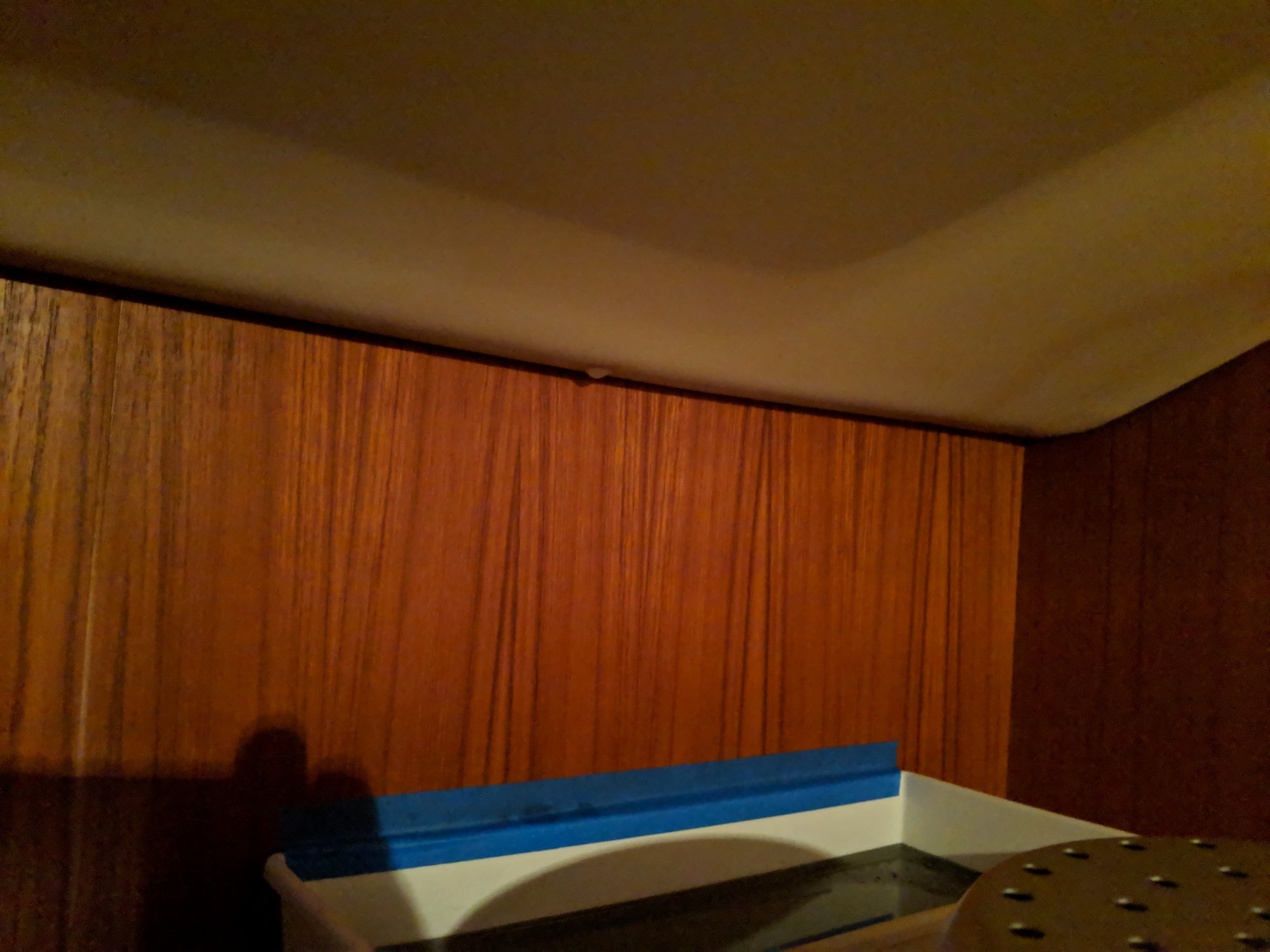

I ended up having to re-bed the large fixed portlight / windshield on the cabin top. Turned out it was leaking and somehow water made it's way across the headliner and onto the fiberglass liner, then dripped down above the galley cabinets.

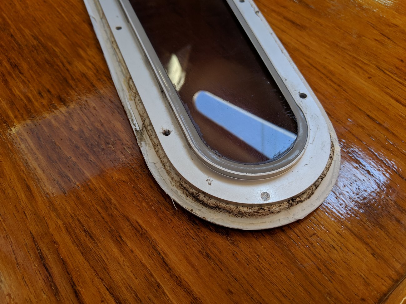

I don't have any suggestion for you on how to narrow it down. Re-bedding the fixed portlight on the side wasn't a big project. Undo the screws on the inside, then it mostly just pops out. Clean all the bedding compound off, put down butyl and re-attach screws. Cut off extra butyl.

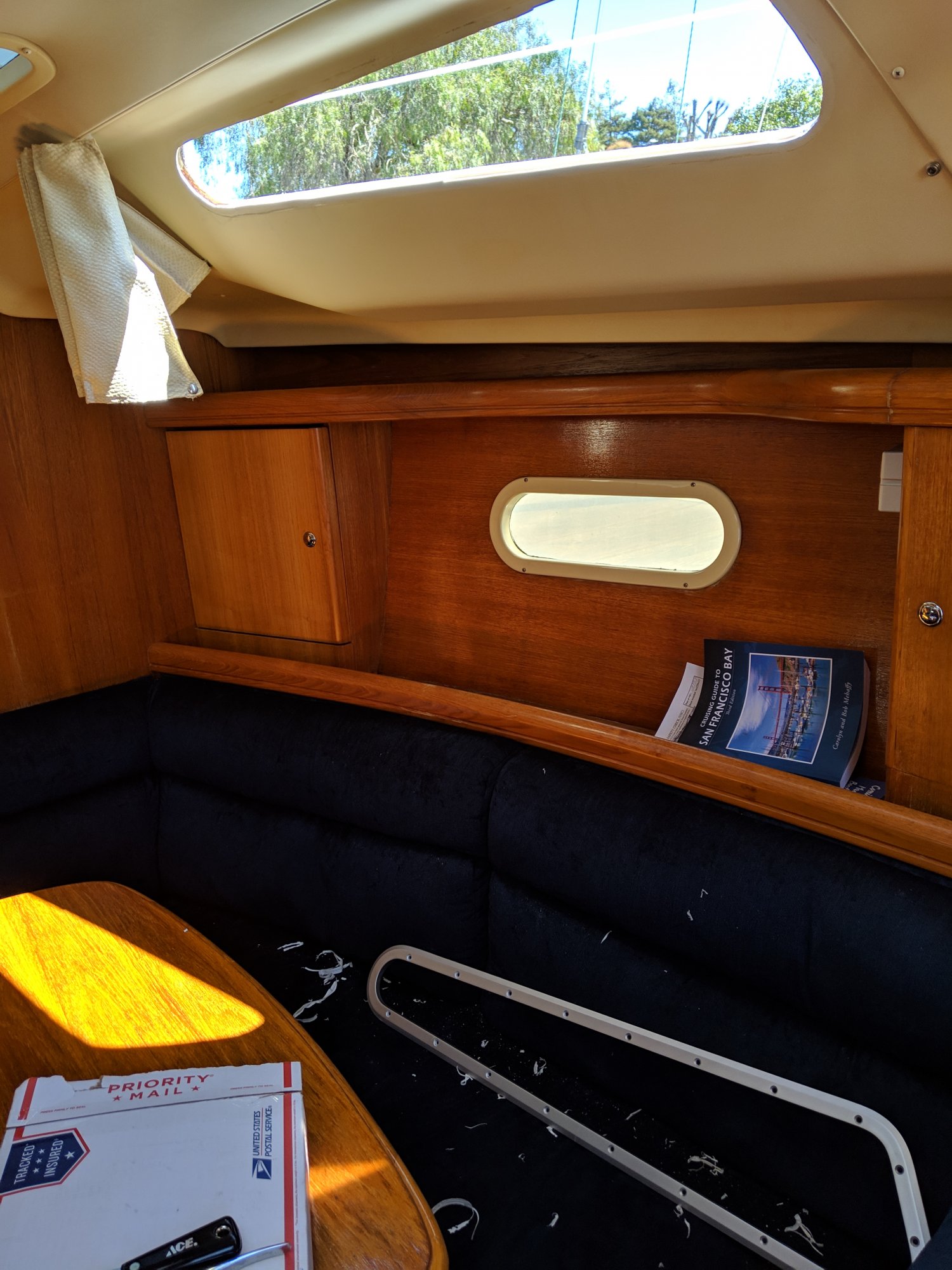

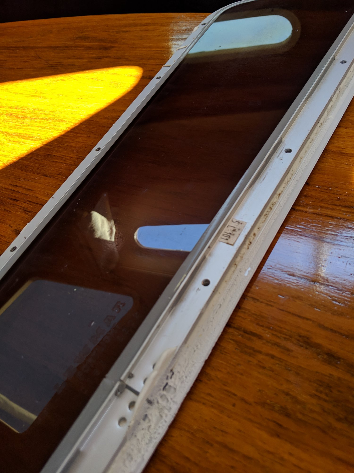

Here are some pictures of re-bedding the side portlight. I have a few of the "windshield" re-bed as well if you end up doing it.

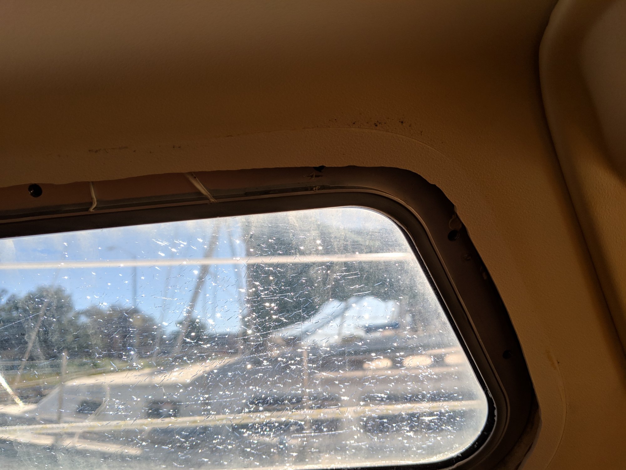

Sure looks like this is leaking, doesn't it? (Hint, it's not.)

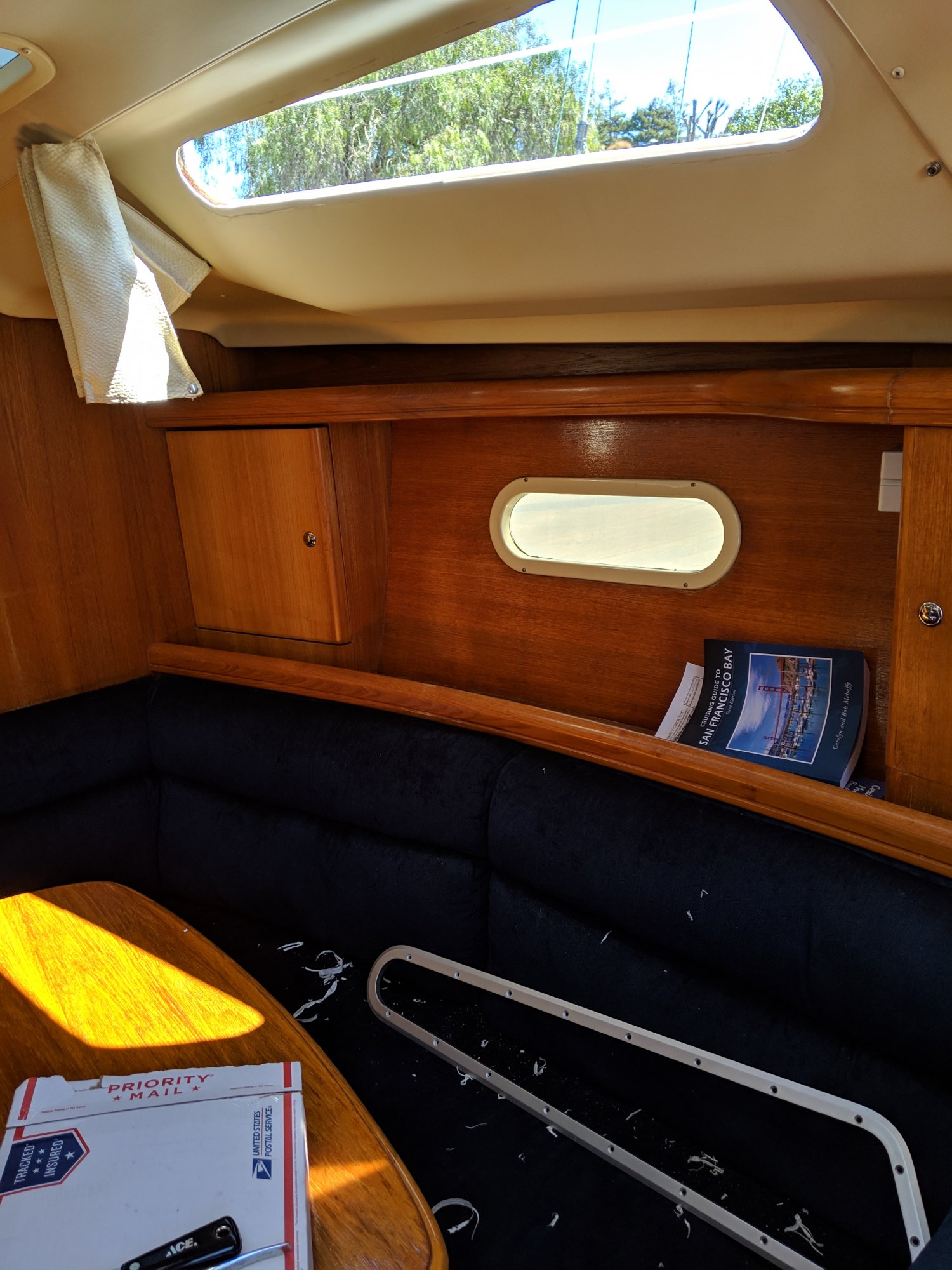

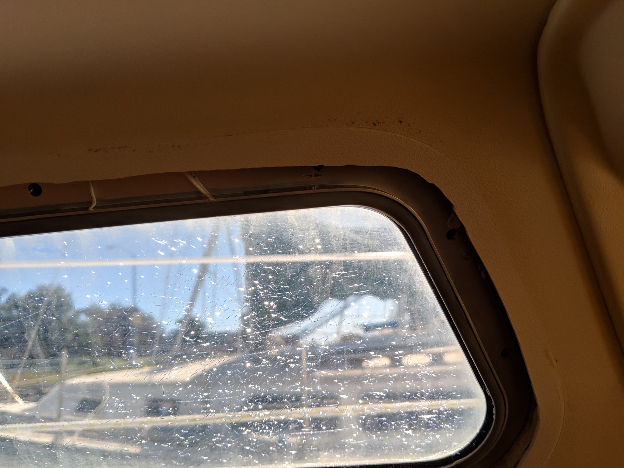

This is what you'll see after removing the screws.

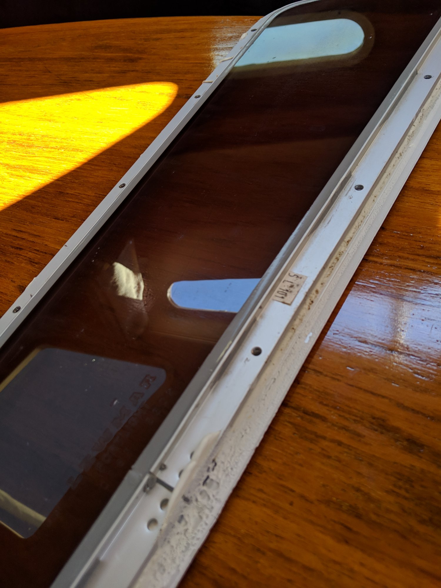

Remove sealant from the outside as best you can and slowly push the frame out. Make sure it doesn't fall off into the water -- I didn't have to push very hard to break the remaining sealant. You can see the inner frame in the picture below, sitting on the cushion.
And here is the portlight after removing it. The longest part of the job is now cleaning all the old sealant. I used butyl when I re-bedded it.
And at the end of the day it didn't solve anything. THIS was the real culprit:

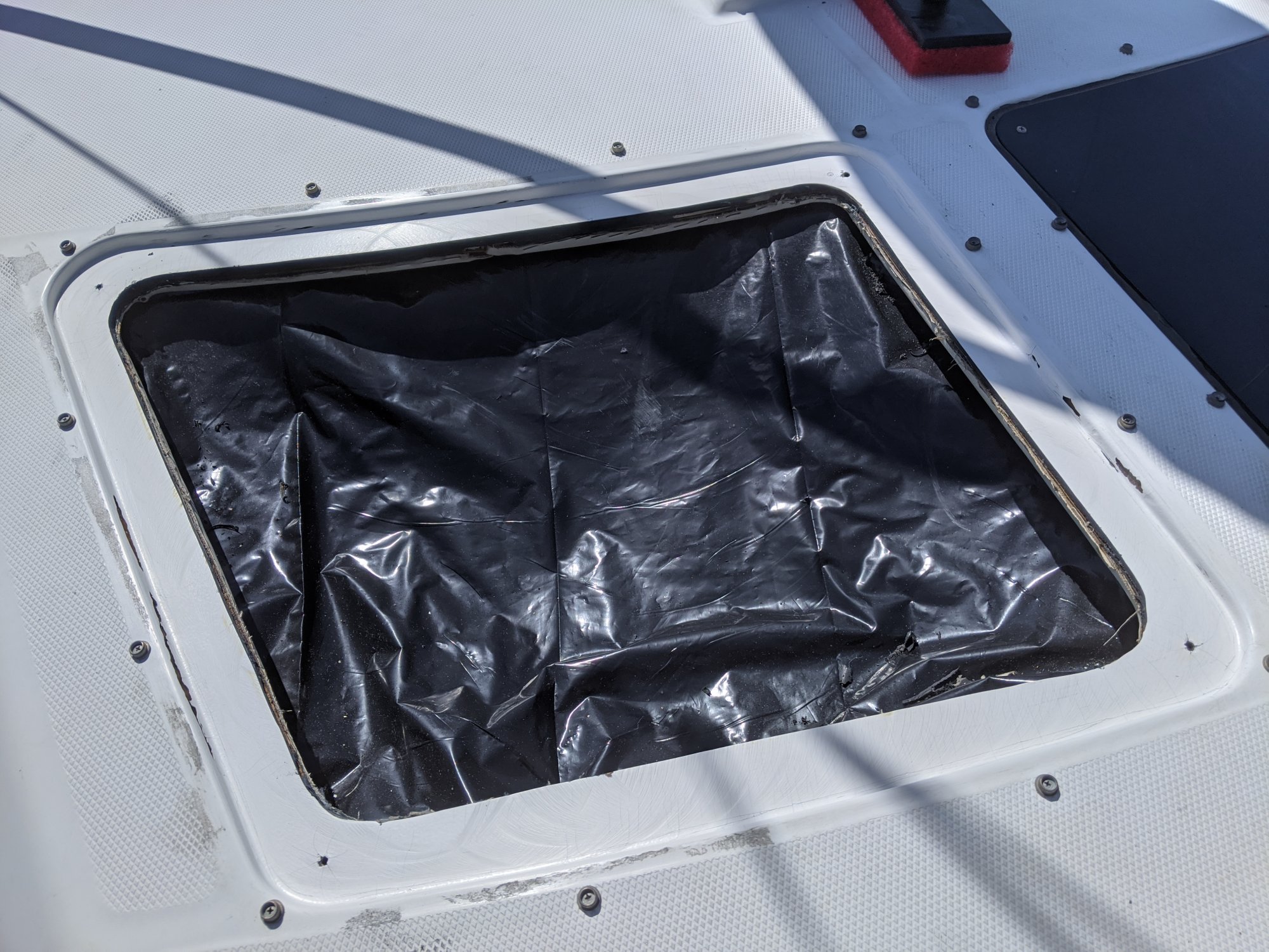

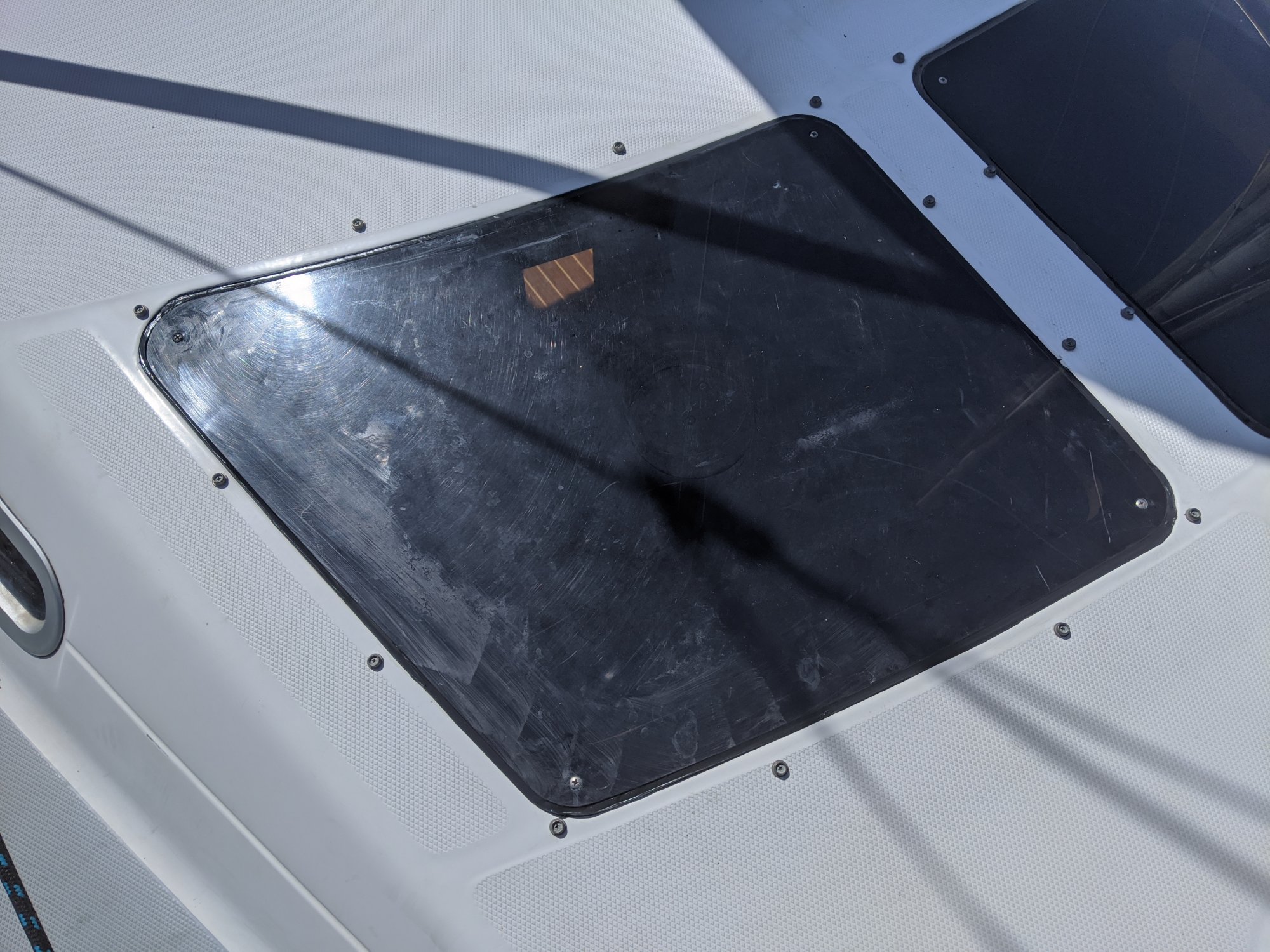

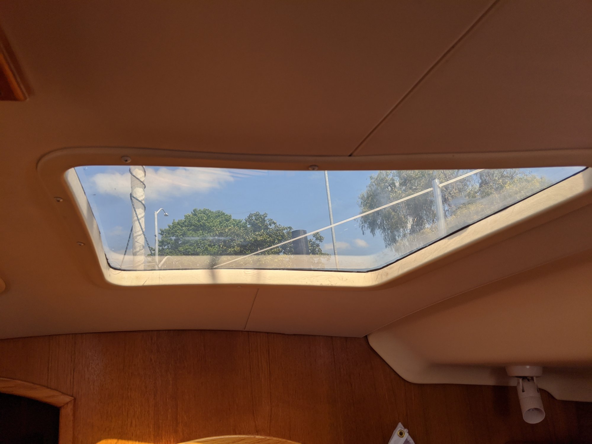

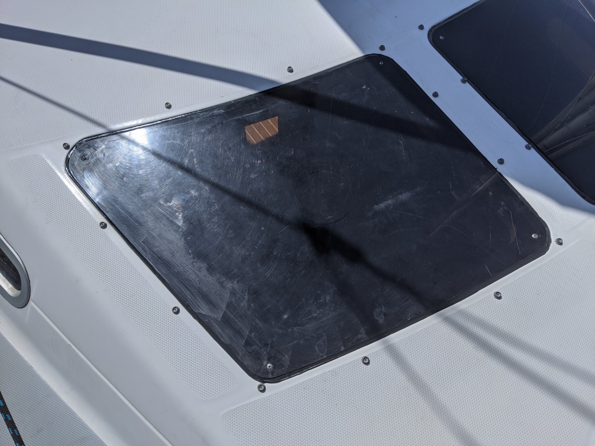

Start by removing the 4 screws in the corners of the windshield.

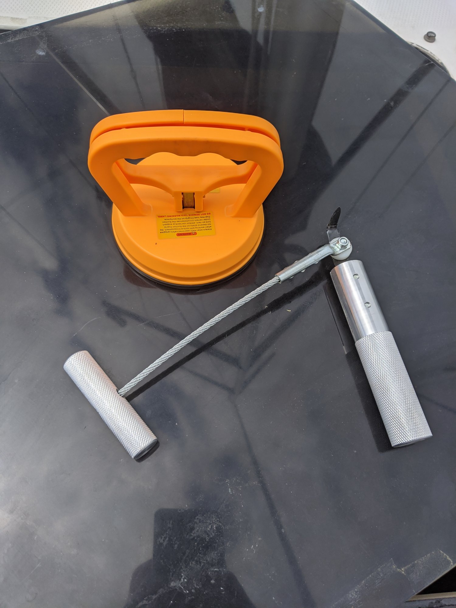

Then I used a windshield remover tool to cut out the sealant around the windshield and just under the windshield.
I then attached a suction cup lifter to the center of the windshield and attached it to the spinnaker halyard. I tightened it up, but only with just enough tension to be tight -- not enough to actually pull the windshield out.
Then I had my helper slowly ratchet up tension on the halyard as I worked my way around the windshield with the removal tool. Eventually it released and popped up.

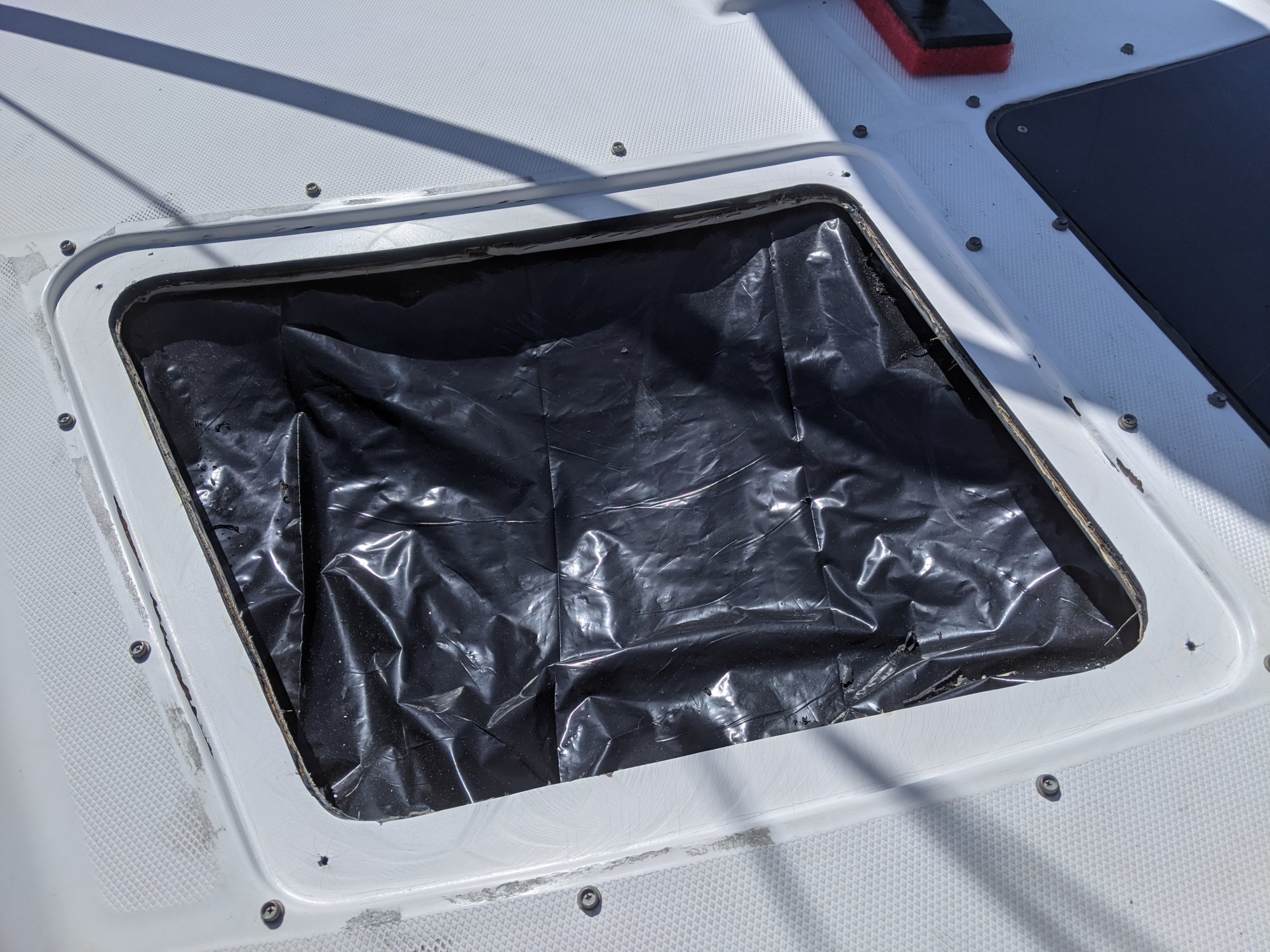

Underneath I taped a plastic sheet to capture all the detritus to come.

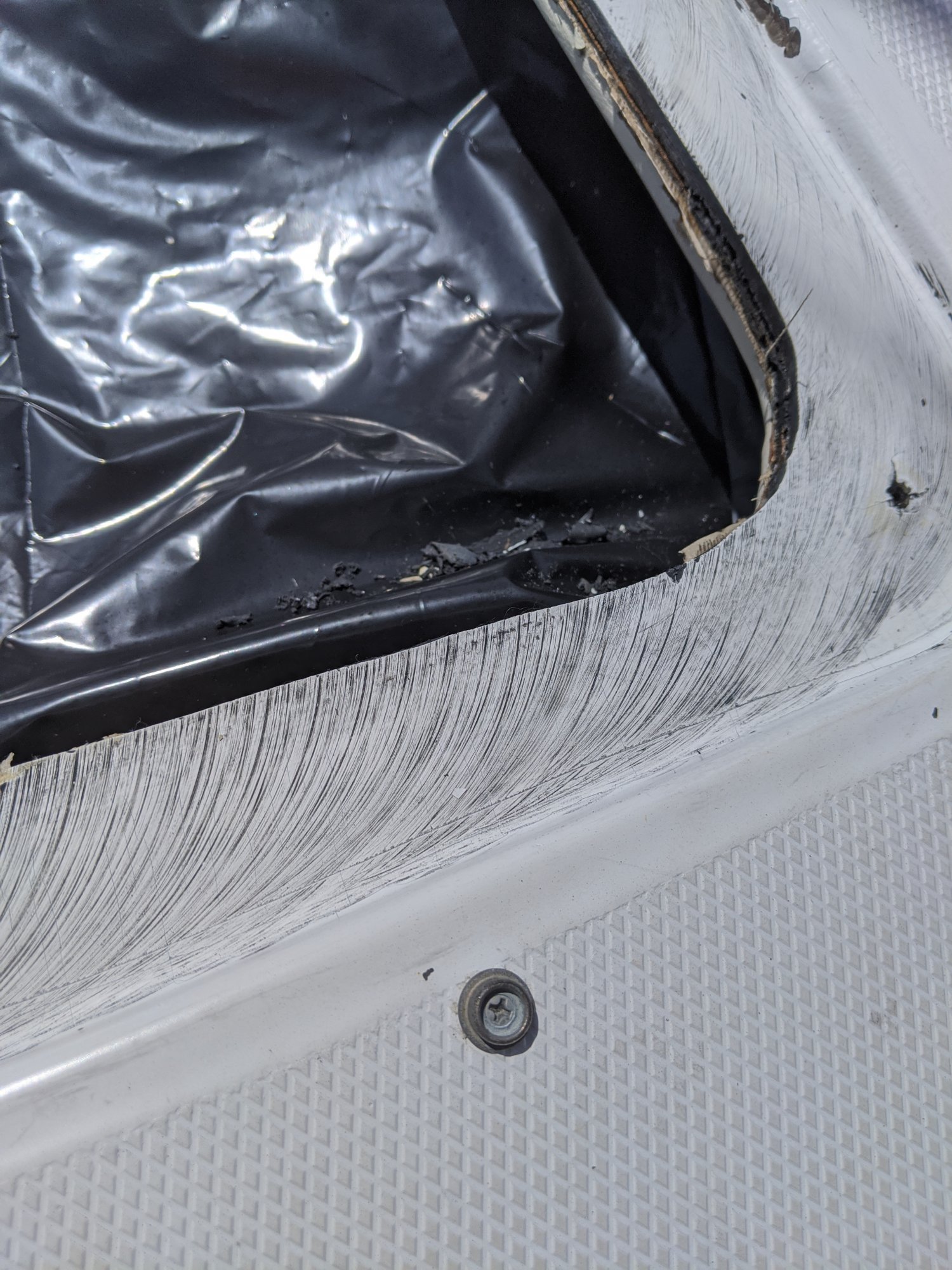

Then, again, came the longest part of the project -- cleaning up the old sealant. I used various plastic scrapers and Re-Mov silicon remover. I found out about this product through Practical Sailor. It's a bit pricey, but worth every penny. I've never seen anything clean up old silicone like this stuff.
After using just the scraper I had this:
After the Re-Mov:

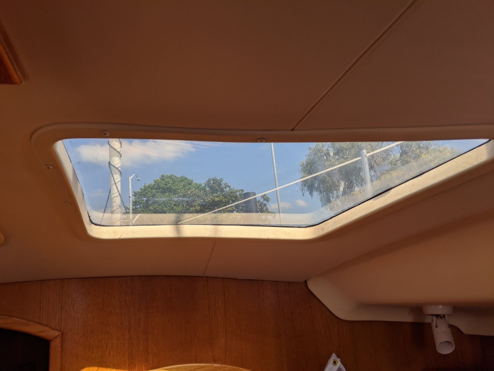

Finally, re-bedded the windshield with Dow 795, which is what the original factory used. I used blue painters tape around the edges to get the cleanest bead of sealant.
I didn't take any pictures of the underside, but I did end up getting some excess on the underside of the windshield. It cleans up fairly easily as long as you do it right away before it dries.

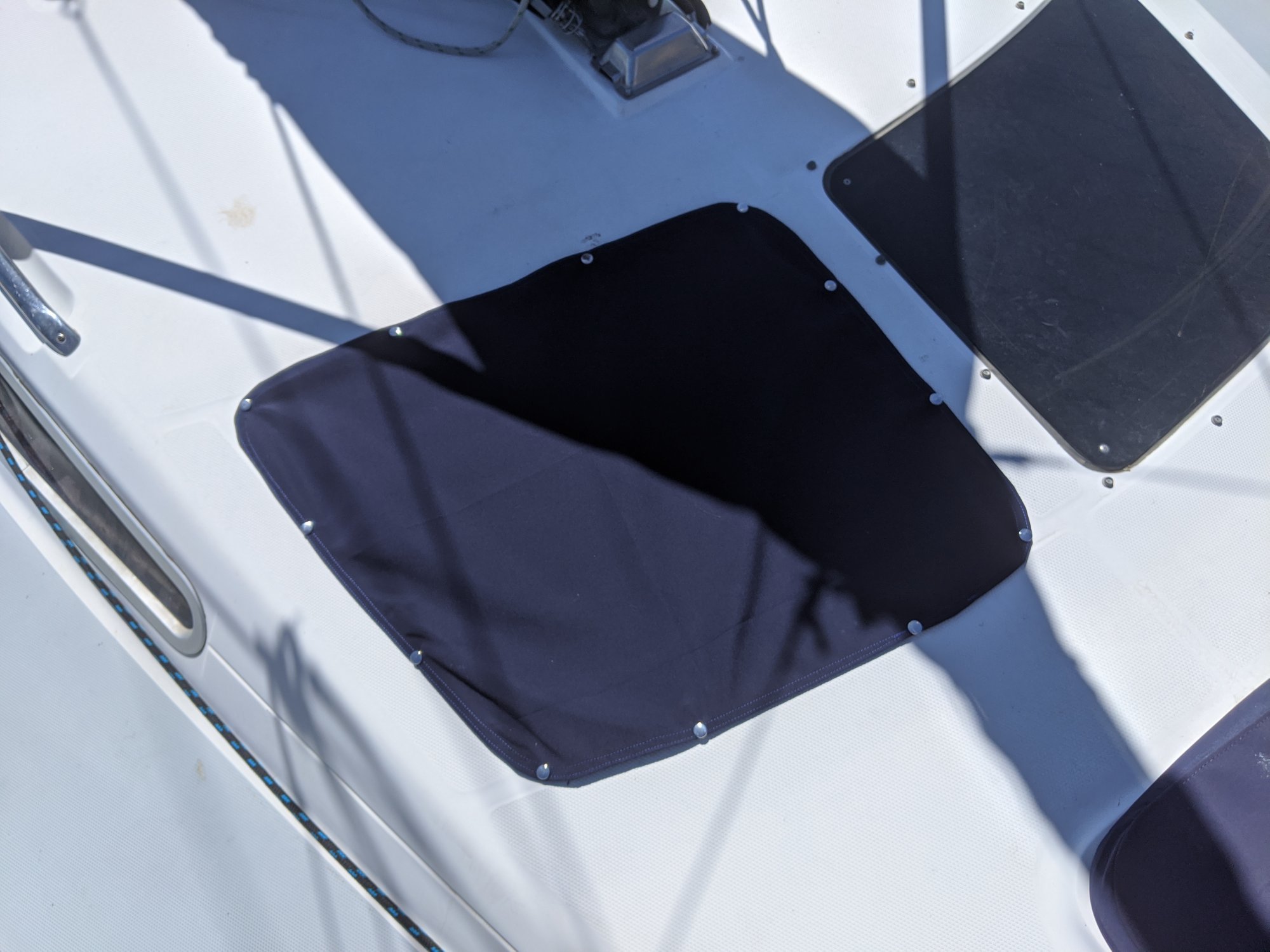

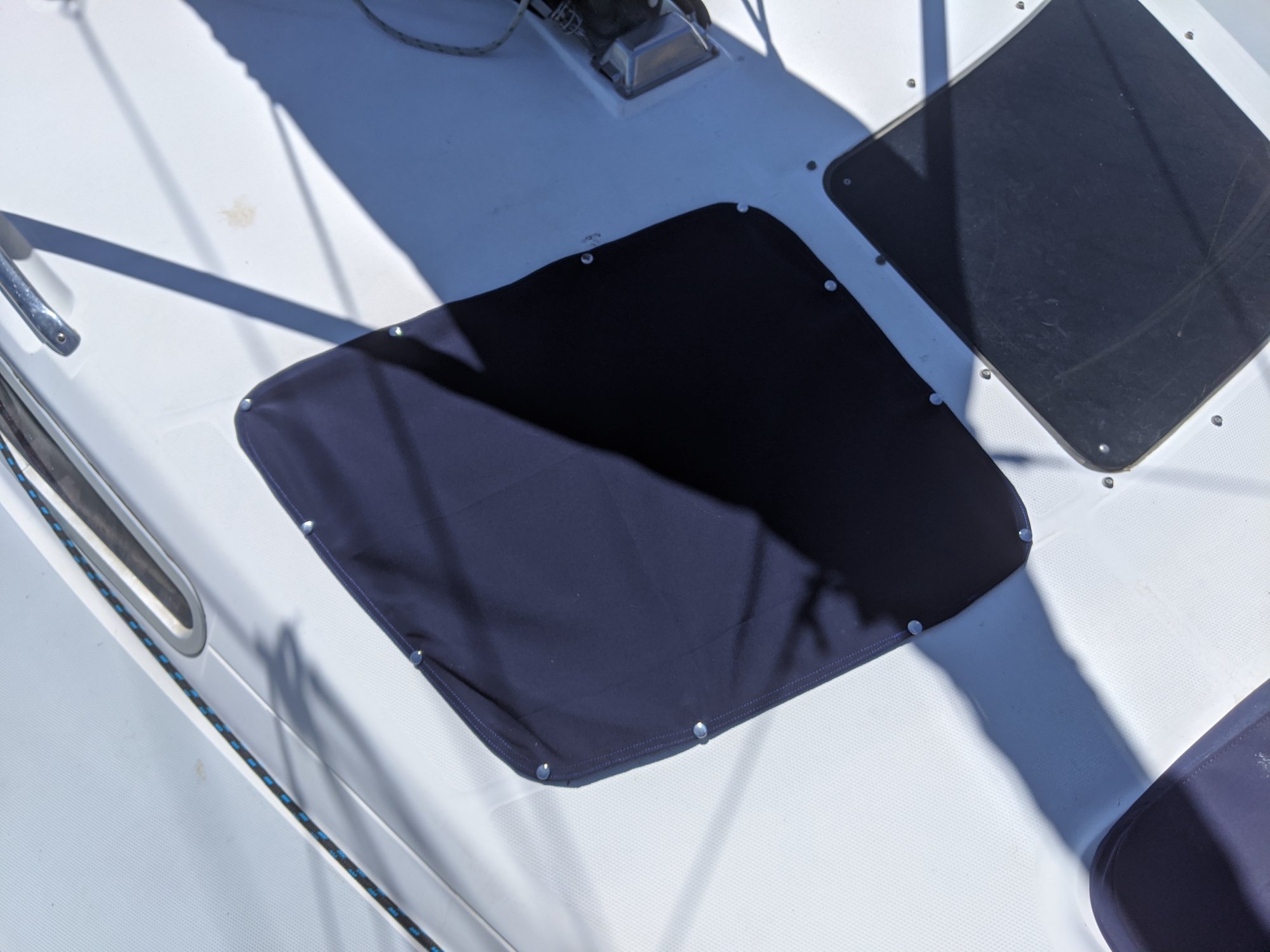

For my very first sewing project ever I made somewhat ill-fitting covers out of Sunbrella in an attempt to keep UV off the windshield and sealant.

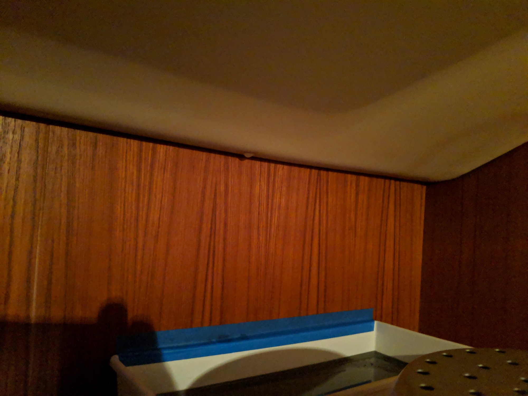

I still have ONE leak left on the boat that I just can't seem to figure out. In the aft cabin I get a slow drip from the edge of the liner at the rear bulkhead. Other folks in the forum have indicated it often comes from the wire loom going into the pedestal. I tried cleaning that up without success. One of these days I suppose I'll climb in the rear locker in a downpour with a flashlight and see if I can see anything.
