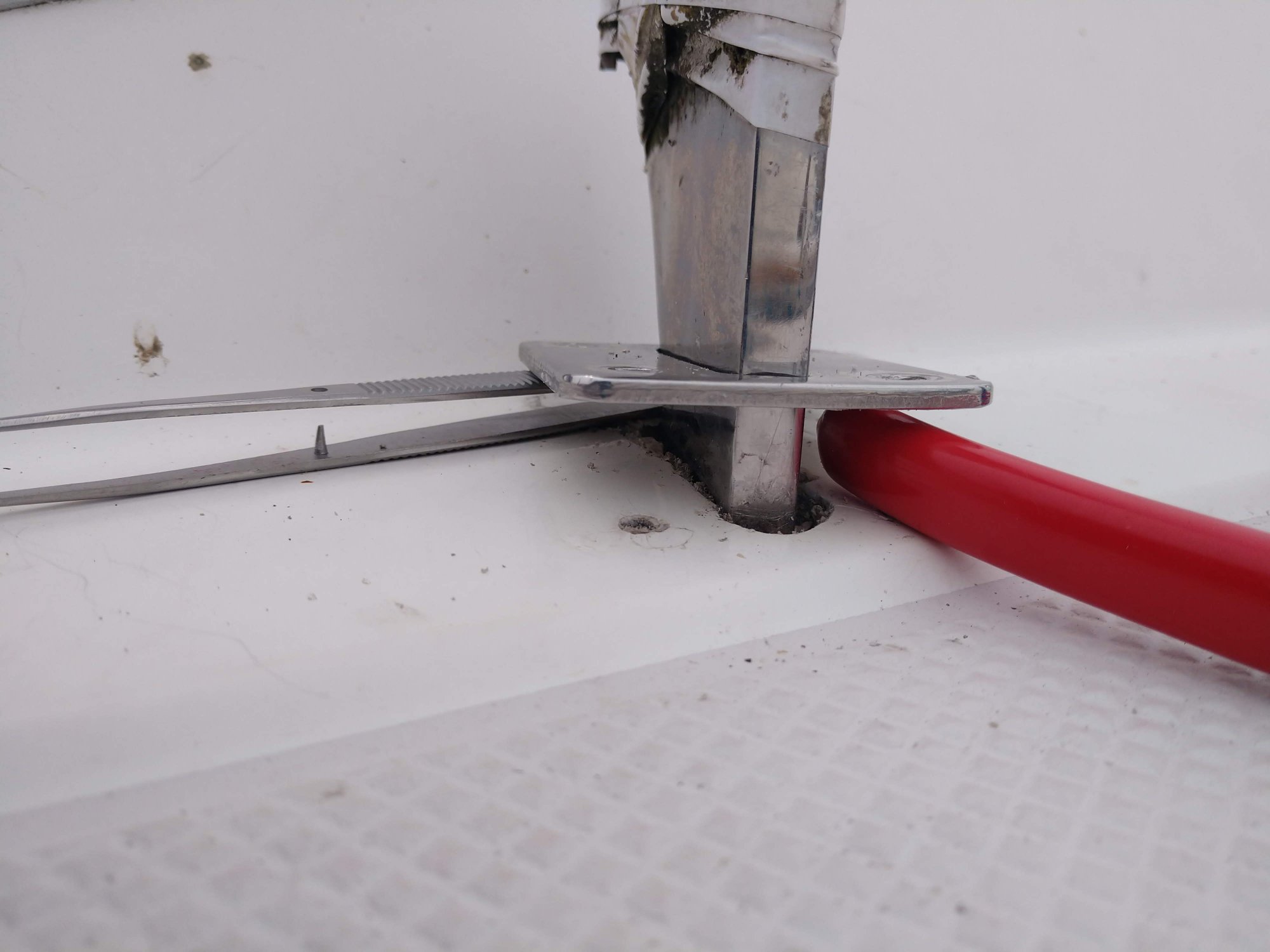

I did all mine without removing the mast. Just do one at a time like others noted. I will say that the main chainplates are hard to access with butyl tape. There just wasn't enough clearance to get it in there for me. I ended up using 3M 4200 instead until such a time when I actually remove the entire chainplate from the bulkhead. See attached. Butyl tape did work well for the other 4 chainplates though. Easy peasy.

Thanks! Quick question though - if you didn't remove the chainplate from the bulkhead, how were you able to raise it far enough above the deck to get the 4200 in?

Look at the pic I attached.
I did, thanks but, stupid question, it looks, then, like all you did was remove the deck screws from the chain plate and that gave you enough play to raise it the amount shown in the picture without removing any bolts that attach the chainplate to the bulkhead?
I think he means that the chainplate wasnt moved, just the coverplate is lifted up. New bedding material applied, and the cover plate put back down.
If that is all you are doing, no need to remove the shrouds. And no concern that the mast will fall.

Apr 19, 2020
80
Catalina 310 Kenosha, WI
Greg
correct. That's how I did it for the main chainplates that attach to the bulkhead.
