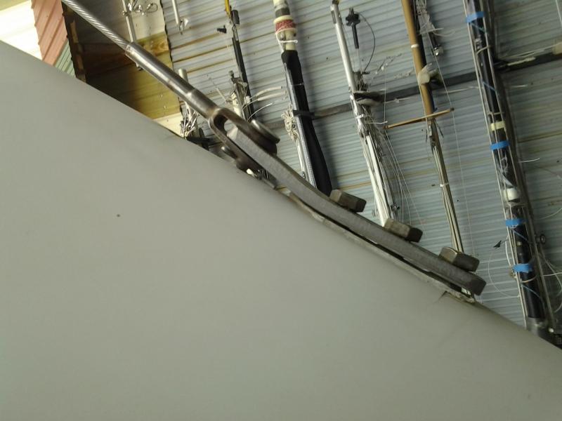

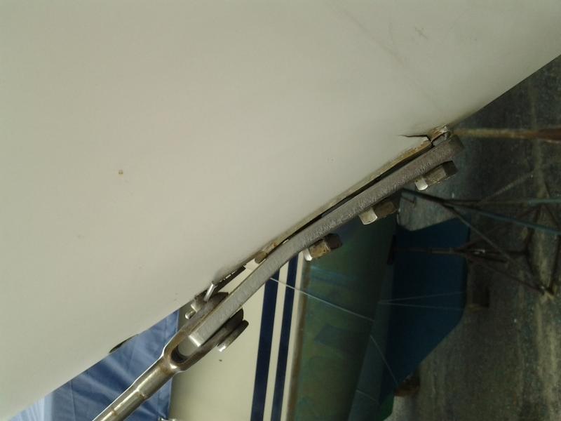

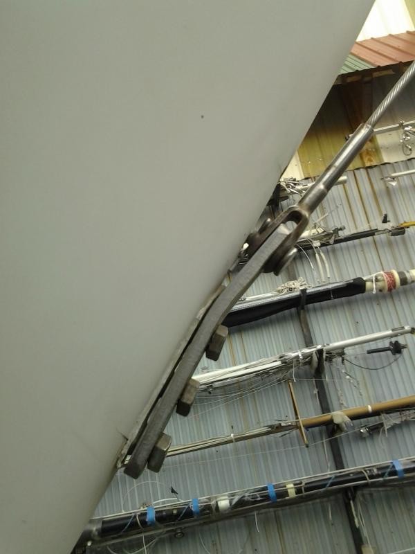

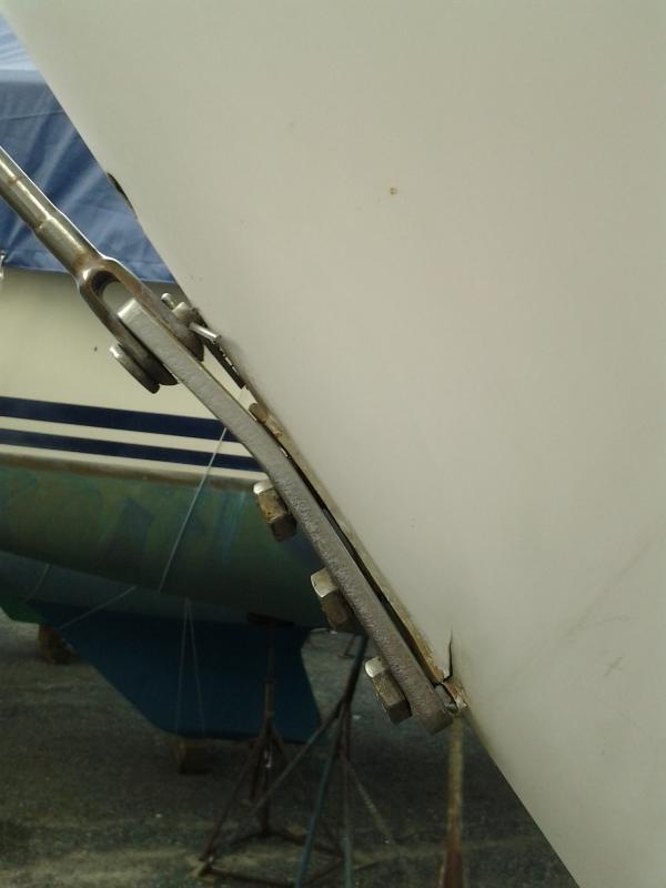

Here's a view from either side of the chainplate. You'll notice there's also some repair work that I'm in the middle of doing, as well as removing the previous silicone from the area.
I reached out to Maine Sail about using the butyl tape - that would be great, since working with it is much easier.
