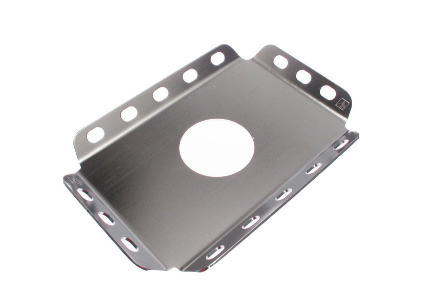

I did this on my O'Day 25. I used a mast step halyard plate with block attached, a block tied to the handrail (deck organizer turning block is more commonly used) and a clutch. I would tie my sail to the boom using a half knot with an extra turn. This allowed me to pull the sail up from the cockpit as these knots release fairly easy. It wasn't 100% perfect but it worked most of the time. Can you post some pics of your mast base and cabin top?

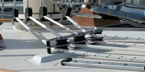

Here's an example setup from a random boat:

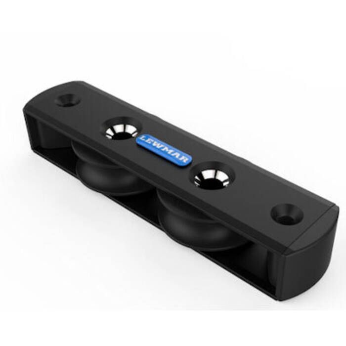

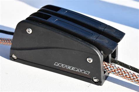

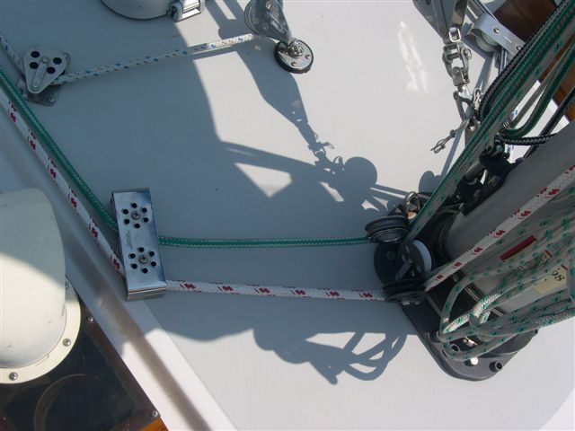

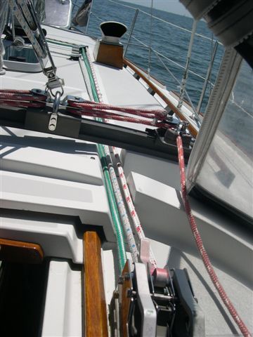

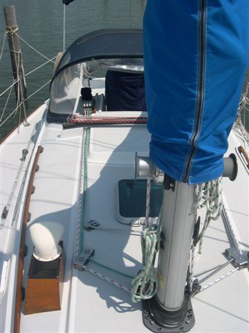

I re-routed the main halyard, out-haul and reefing lines on an O'Day 35. You will need a mast block for each line, an organizer (two if you run them on both sides) and a rope clutch for each line. I got everything from Garhauer Marine, a great source. Here are some pictures:

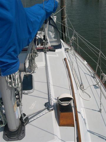

For a keel stepped mast you need a collar.
here is an example.
The collar allows you to attach blocks that are used to turn the lines from coming down the mast towards the cockpit.
You will need to decide where and how you want to run the lines. Once near the cockpit you’ll want to terminate the lines either on cleats, on self-tailing winches or line clutches. What ever you decide be sure you minimize friction. Friction will make it more difficult to trim the halyards or raise/lower the sails.
