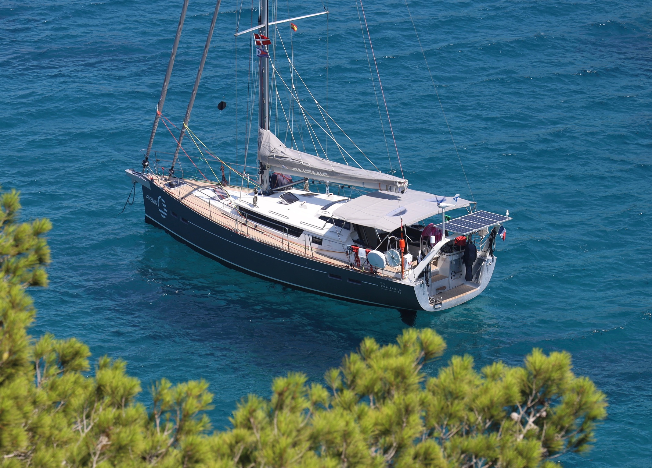

The power in the "auxiliary power" is the motor and batteries, just as a diesel doesn't provide any power until you add fuel. The world of DC power is moving past 12v, 24v, and is now landing in the 48v range. Higher voltages off some advantages and increased efficiency. The Torqeedo Deep Blue line of 100KW electric motors run on 360v. The one advantage AC has over DC is less current loss over long transmission lines necessary for the power grid.
LiFePo batteries offer a lot of power in a small lightweight package. On a long distance cruising boat LiFePo is the only way to go. Batteries are recharged with solar and regeneration, the motor serves as a hydrogenerator, when sailing the prop turns and the motor becomes a generator. Oceanvolt has a sail drive unit that can do this.
Solana Yachts now produces an all electric 46' yacht.
While Jimmy Cornell tried a zero emission boat to circumnavigate, he found the solution did not work, for the reasons you suggest, it is difficult to fully restore the power used with solar and regeneration. He abandoned his journey.
The schooner refit I"m involved with is considering repowering with electric. For its intended use, 100% electric is not an option, however, combined with a generator it may be a cleaner and more economical solution than a new diesel. One significant advantage of electric with a generator is the generator can be much smaller and more efficient than using the diesel auxiliary for charging. A 200 amp alternator needs about 6 hp to run at full power. The schooner has a 100 hp diesel. Using the auxiliary to charge the battery wastes about 90 hp. Where as a diesel powered generator could produce about 10 kw with 30 hp and in the process run more efficiently
At this point, I think we've moved off the bleeding edge of electric auxiliary, but we're still on the cutting edge. ;)
