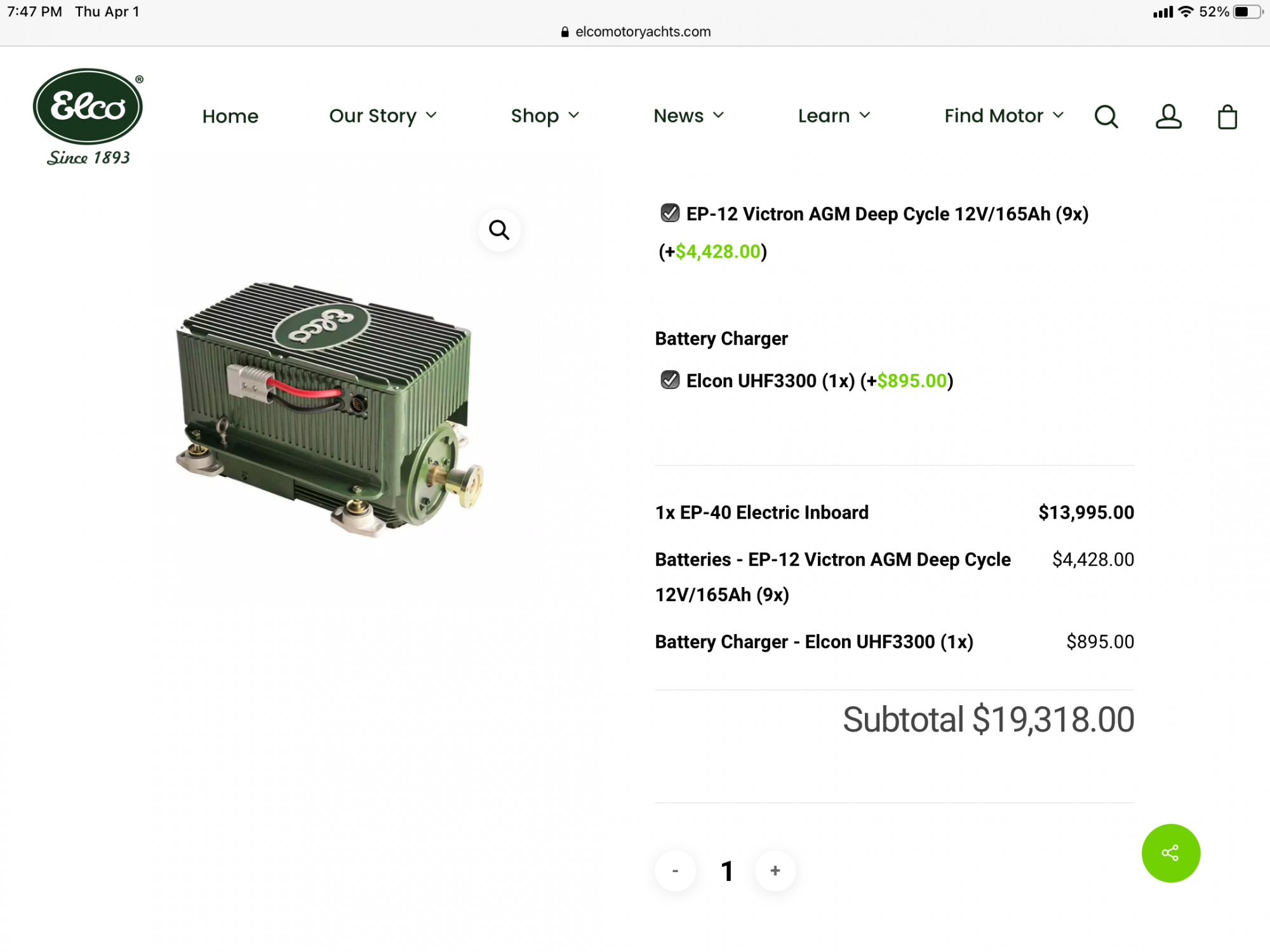

Wow....
A 40-HP equivalent motor, plus batteries is almost $20,000.
If you can get by with a 20-HP equivalent, it only costs you about $11,000.
But I bet is pretty quiet...especially after the 30 - 35 NM cruising range :huh:

cheaper than a new 40HP diesel replacement.
Batteries don't come free and 9x $4,300 is quite dear. Lots of ways to compasre, but that's not what, I think, he asked. I agree, would love to see before & after.
