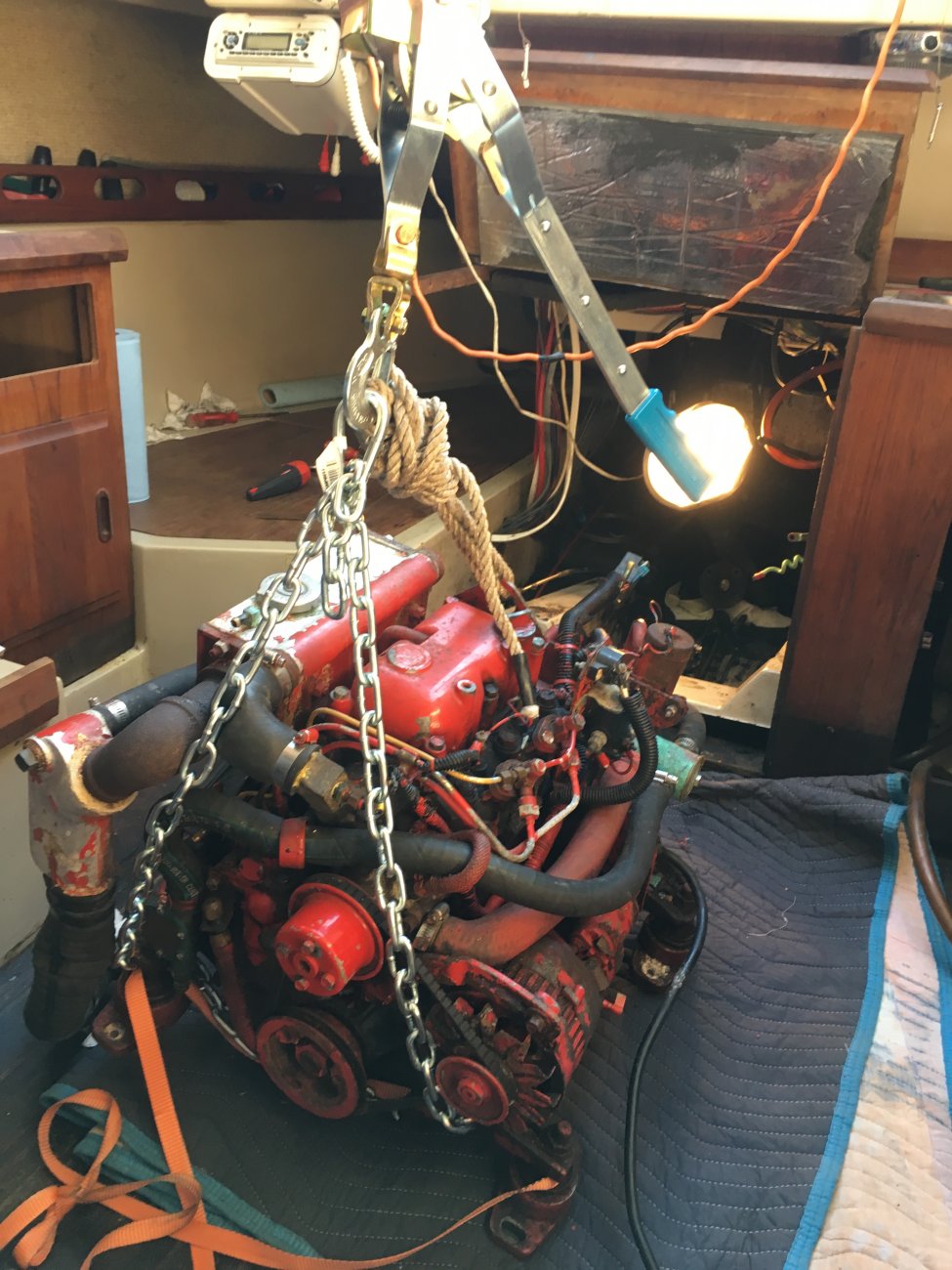

Joyfully purchased an ODay28, but it has been in dry dock for three years.
According to boatyard legend, the Westerbeke 13 (hp) had been running but not well (clank, clank, clank), which prompts thoughts about a top-end rebuild. I've pulled the engine from the boat and await a start-up test in the shop.
In the meantime, I'm wondering, if the rebuild is too expensive, can I re-power with a Yanmar 2YM15? Its dimensions seem compatible, with engine mount centers matching almost exactly. Having taken the Westerbeke out, I can attest to the tight quarters, so this engine seems like a good choice in terms of dimensions. Is there anything else I should be thinking about? I mean, do the drives turn in the same direction? Is there an issue with shaft angles? What other issues should I be aware of?
As a new owner, I'm trying my best to educate my self, so anything anyone can add here would be gratefully entertained.
