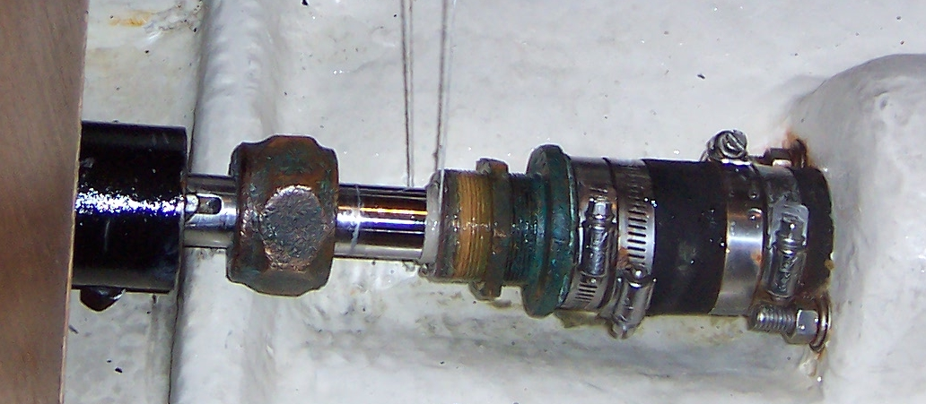

There are several other things you can do to ensure the shaft comes right off for that first bellows replacement : first is the liberal use of Fluid Film as previously mentioned by @American_Mainsail. This shows mine after a packing job when the boat was about 15 years old.
I give it a cleaning every other year if I'm bored. A good soaking of FF where the hub meets the shaft ensures no water gets between the shaft and hub. The packing at that time was seven years old and it didn't require a re-pack as it was still soft and pliable. Shooting for a life span of ten years this time. And that brings up the packing material. It's Western Pacific Trading teflon impregnated flax packing. You will likely have a new shaft with a mirror polished surface so you will be able to run your gland dry. But only if you start with a mirror polish.

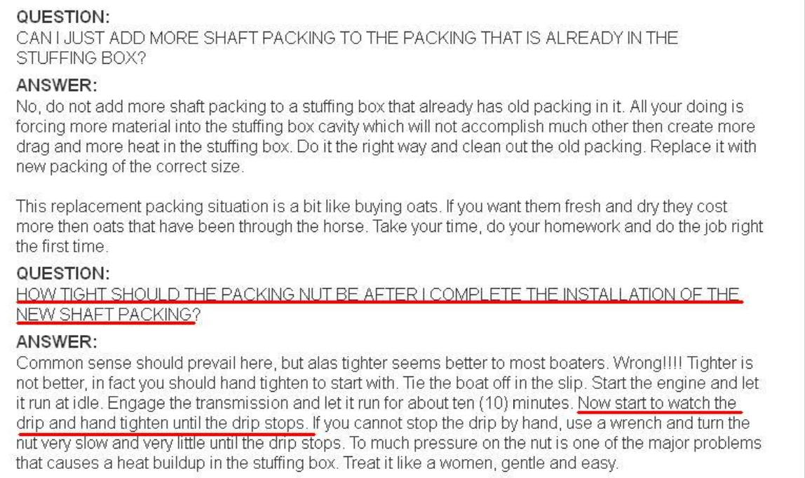

I can heat the naysayers choking on their libations right now, here's the instructions from the manufacturer .................
They convinced me and I never looked back. I wrote this a number of years ago to piss off all of the purists :
Unfortunately I see the posting is now cut short. It ran for pages with pro's, cons, and even a few comments containing promises of disfigurement (on me). The packing keeps everything pretty dry and dusty back there.

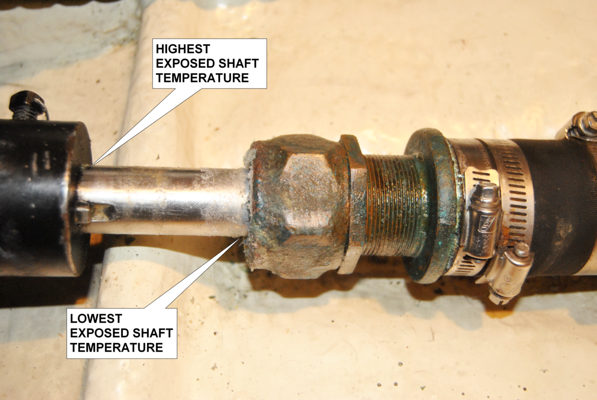

You can put it on tight enough to barely drip,
Ah, but do you ever run it with "no drips?" Keep checking it with your hand for temperature as you tighten it 1/2 of a flat every hour or so.
That SS shaft is a fairly good conductor of heat (the Cr interferes with conduction) into the cold, cold ocean. The heat is being created on the SS surface so not too much distance to travel before it sees that relatively large shaft cross section to conduct the heat away. Using an IR gun, I always see the highest temperature on the hub and then it drops as it hits the gland nut :
