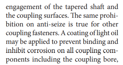

Honestly, straight couplings are not a great system IMO. That's why they're used on low horsepower applications. From an engineering perspective, I totally agree with you; but that's not really how a straight coupling works. I upgraded to a Sigmadrive reason for this reason. I found the "engineering" of a straight coupling lacking.
In a straight coupling, the coupling is precision machined for a slight interference fit with the shaft. When you buy a coupling, it is machined to be mated with the individual shaft it will be paired with. The problem is that when you throw life (wear, corrosion, stress, taking the coupling on and off etc.) into the equation, that interference fit can loosen up quickly and you end up with the fit being too loose. The key and the set screw end up taking the torque load instead of the interference fit as intended. The slotted key and the set screw are not designed for this,. They are supposed to be a safety measure. Again, in my opinion, the engineering on this kind of coupling really isn't great. It's kind of a cheap "belt and suspenders" way to do a shaft coupling for a low horsepower application. It's not a system that's conducive to maintenance. Once the coupling siezes to the shaft, it can go years and years and work great. When you start talking about removing the coupling for maintenance, problems can start.
You can make the argument that some kind of lubricant, anti-seize, whatever will help the corrosion issue, but ultimately you're taking away from the capacity of the coupling to transfer torque to the shaft.
I did a lot of research on this subject. I'll try to find the write up that I found on how these coupling are intended to work to post (I found it, it's attached). Ultimately, I wasn't satisfied with the robustness of straight coupling systems, so I upgraded to a Brunton's Sigmadrive. The Sigmadrive uses a precision taper system to clamp down on the shaft. The design was inspired by work that the inventor did on ice breaking vessel shafts (they use a hydraulic clamping system). It's much more robust. Even so, the instructions from Brunton's recommend nothing more than a light lubricant on the tapered area within the Sigmadrive (to aid the clamping process) and no lubricant on the area that mates directly onto the shaft.
Regardless, if the coupling is fit to the prop shaft correctly, you'll never be able to pull it off easily without a coupling/flange puller. If you want to stay with the straight coupling system, I definitely suggest picking one up to allow you to safely remove the coupling when it's seized on the shaft.

The OP's question dealt with anti-seize on a straight coupling. FULL STOP. Nothing about coupling construction.
Statements like this from your linked article do nothing to clarify the situation :
No thought about how an interference fitting does in fact go together with anti-seize between the surfaces if the same anti-seize is supposed to keep these same surfaces even further apart. Something wrong with the thought process here.
That statement is going to take one hell of a pile of analysis to convince me how the shear strength of a shaft key is going to be reduced by introducing a contact surface of anti-sieze.
To use your words, if I may, spending a good portion of my life in refineries looking over the shoulders of people working on these couplings up to 100 HP revealed how the professionals do it. Tight fittings on these couplings DO NOT FAIL.
And looking at typical sailboat shaft couplings, and using your "engineering perspective" I am more than satisfied that a properly fitted straight coupling is more that adequate to absorb the applied torque without coming loose.
And finally, I know you'll want to retract this when you read it again :
Care to calculate the opposing torque due to the shaft key in shear compared to the frictional shear force of the "seized shaft?"

Interference fits are a very acceptable means to transmit power through shafts. I'm not arguing against that. My main point is, in this particular application (a recreational sailboat), there are better ways to accomplish this, and that if you're going to use the straight-shaft system, it's best to keep anti-seize out of the equation when you're fitting the coupling back on the shaft. I'm also saying that, in my opinion, the system isn't really all that robust for this application, and it's best to leave it alone and let it seize together. Use a flange puller like the one I linked above to get it off again next time around and it will work out.
In an industrial setting where professionals are looking after the maintenance, it's not sitting in humid salty air, professionals are bringing special tools to bear, have better access for maintenance (presumably), and they're not out on an island somewhere, there's nothing wrong with interference-fit torque transfer.
Here's a whole article about interference fit torque transfer. Pretty neat. It can be very, very strong.
https://theengineeringblog.com/shrink-fit-interference-torque-torque
It's not really the strength of the shaft key safety connection that that's the issue. I have no doubt that if you hooked up an oversized coupling loose on the shaft and measured the breaking force of the key/screw connection, it would be plenty strong to transmit the torque you're asking it to take. The problem is more along the lines of the forward-reverse-forward (sometimes rapidly one after the other) that the connection sees, as well as the associated forces with pushing the boat forward and pulling it backwards. The key/set screw can work itself loose over time; the press-fit connection is the connection that can take these forces. It's just not great practice to put anti-seize between the two mating surfaces that you are relying on friction for to get the job done.
If the press-fit/interference-fit isn't on point, the screw/shear key safety situation isn't really designed to take the forces I'm describing above for an extended period of time. I've seen it happen and it's a total PITA to fix because the boat has to be pulled out of the water in order for a new coupling to be custom-machined to the propeller shaft in question. The shaft has to come in to the machine shop with the flange so that it can be precision fit.
The shaft/screw connection is there as a safety so that the propeller shaft doesn't fall out of the boat and you can get yourself home.
If all things are right dimension-wise with the connection, my guess is that putting anti-seize on the shaft won't cause the connection to break free, but it's not really best practice to do so. I don't think I'm going to change your mind that you should or shouldn't use anti-seize to put the connection back together, but that's cool. I'm glad that the system you have works for you.
