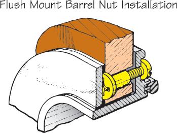

There are two methods of install for Becksons.
#1 Drill and countersink special flush mount barrel nuts (available from Beckson) into the exterior of the cabin then silicone the trim ring in place to hide the fasteners.
#2 Drill regular barrel nuts right through the trim ring. This method tends to look ugly and will also lead to more potential points for leaks.
If you use method #1 you'll need to have solid core behind it or the shoulder nuts could pull through after you countersink the holes.
