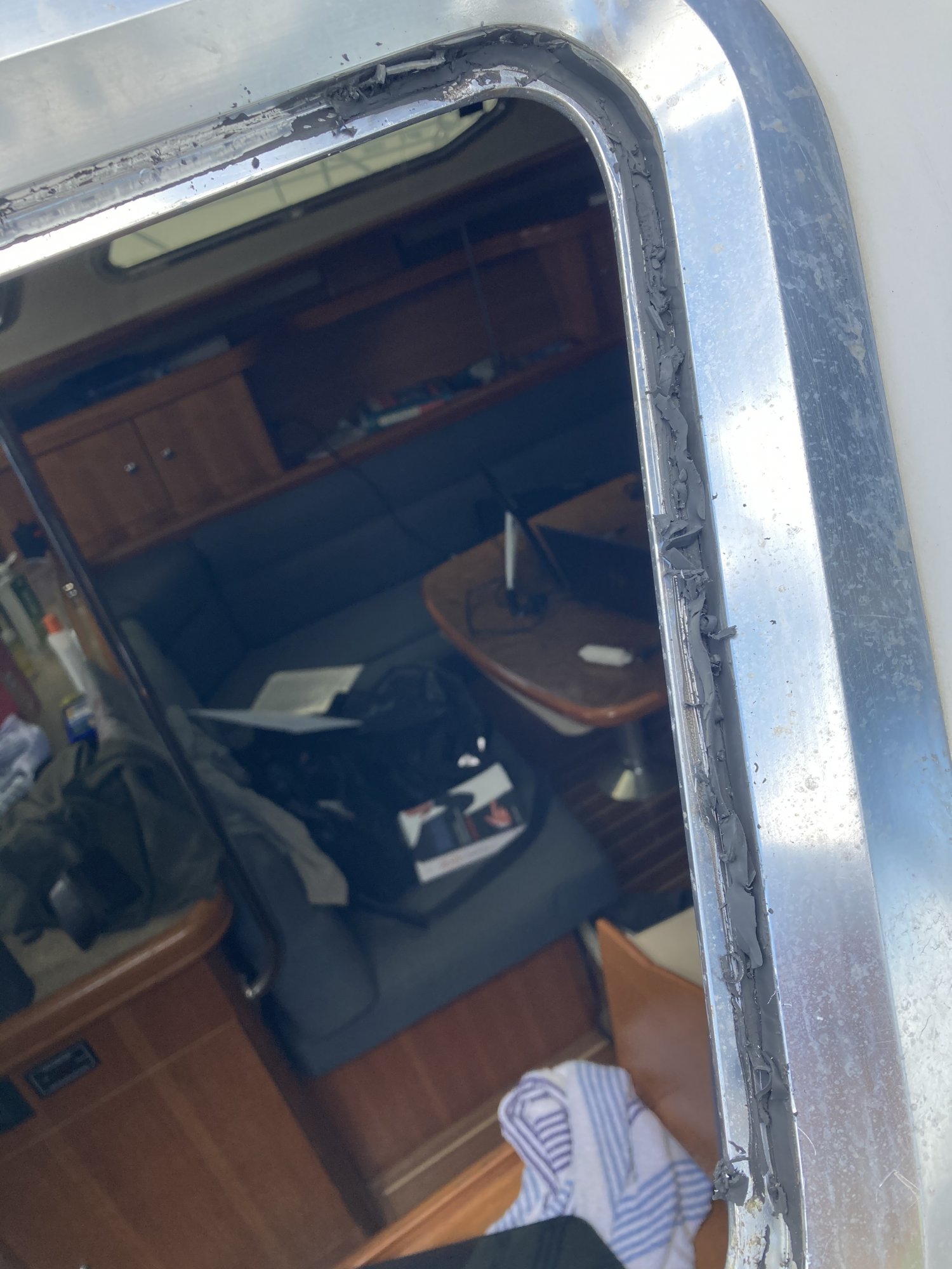

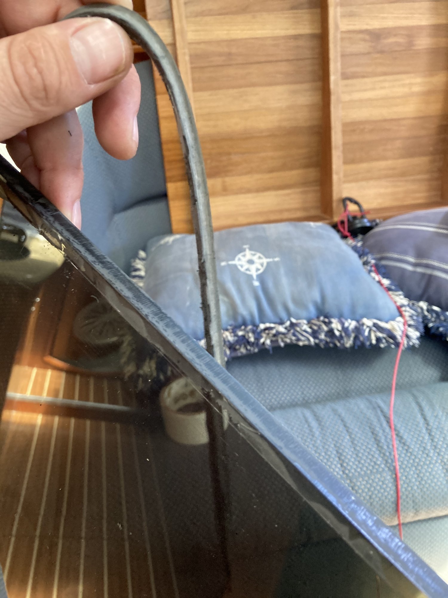

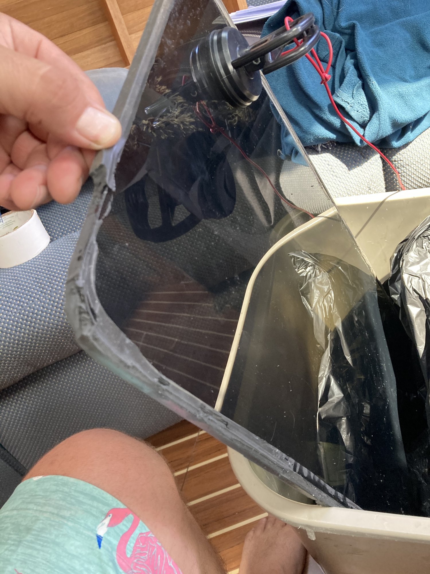

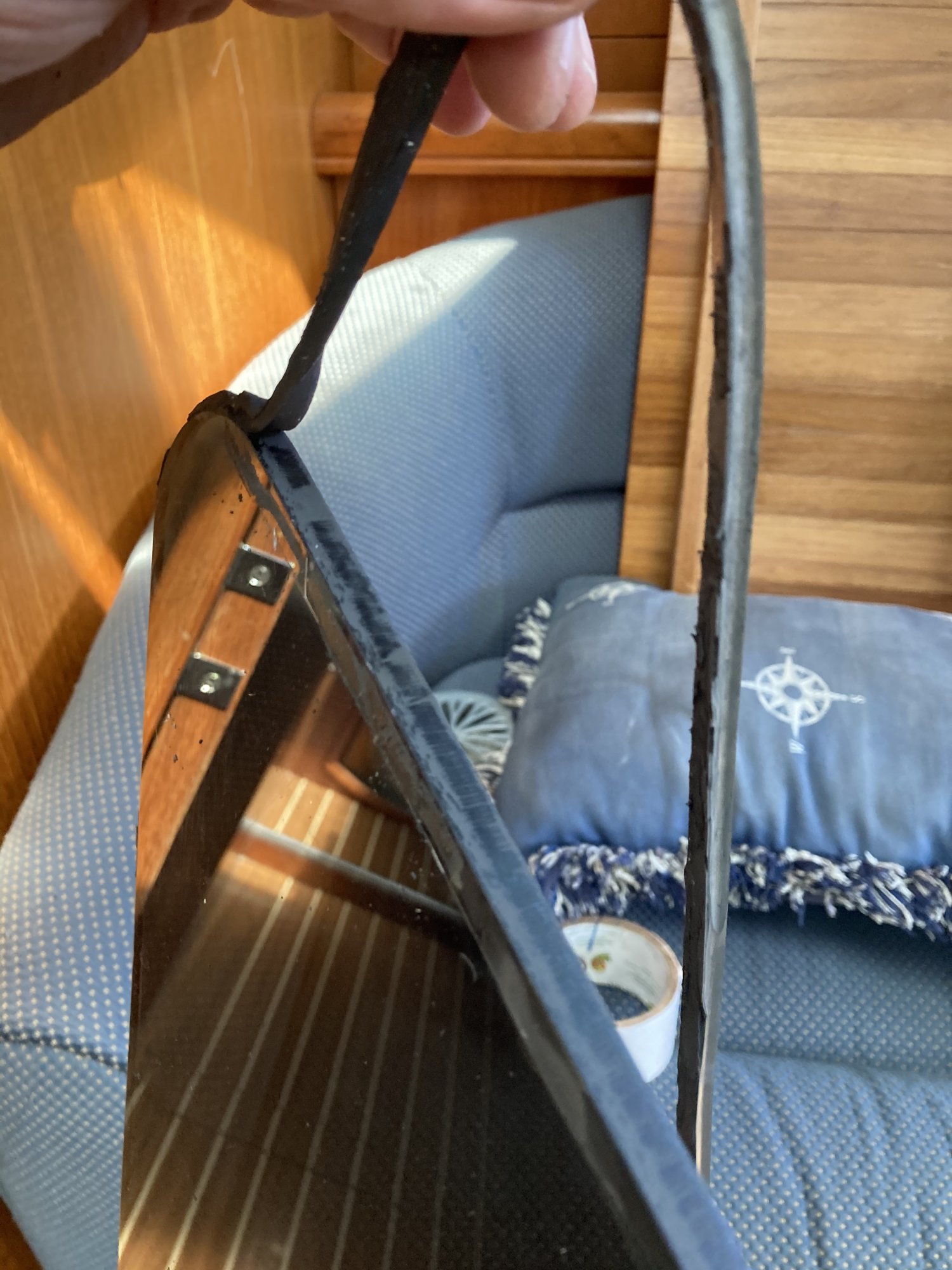

Assume they're similar to the ones on my 356 -- here's my write-up:
I did not use VHB either, just the Dow.
