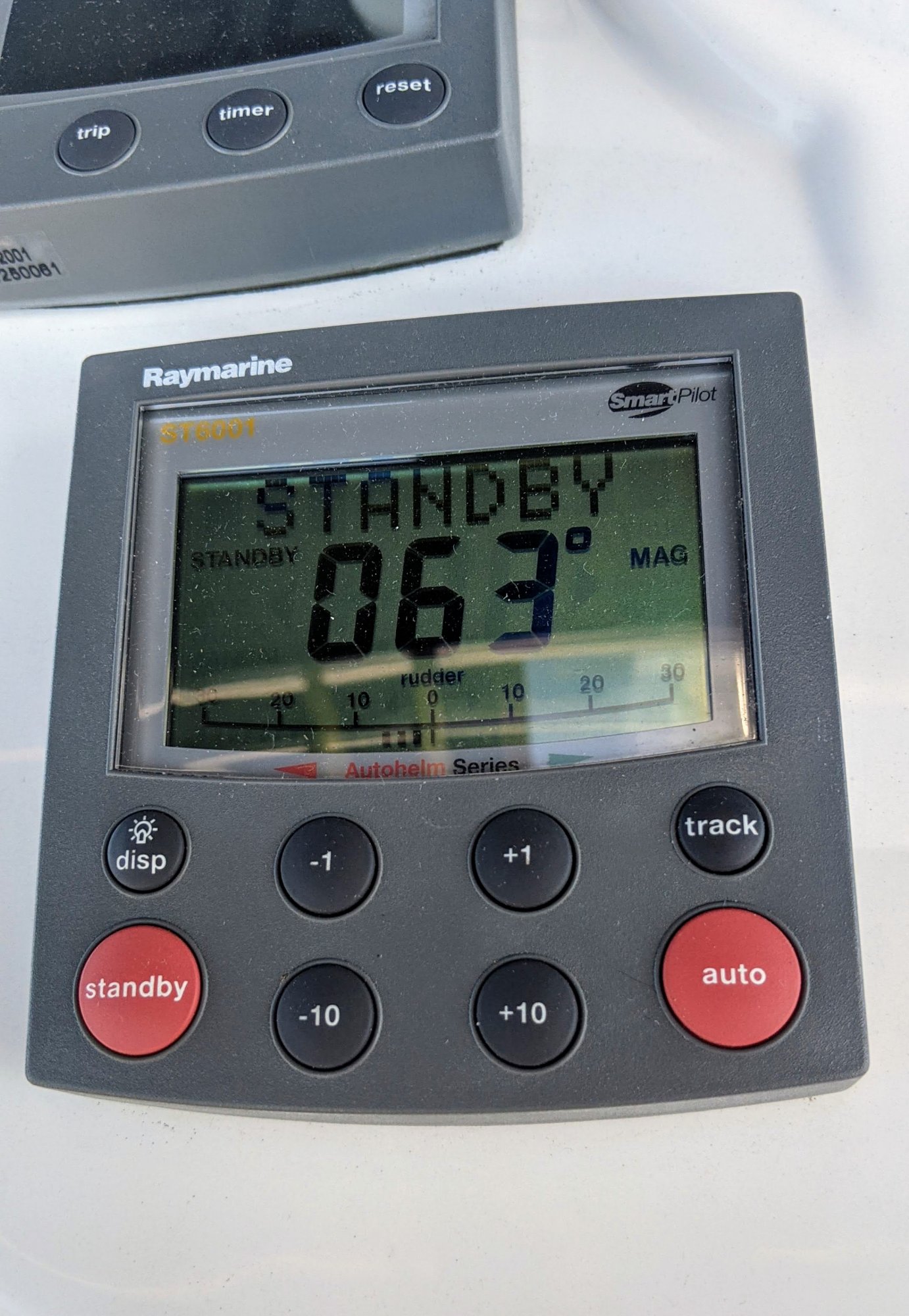

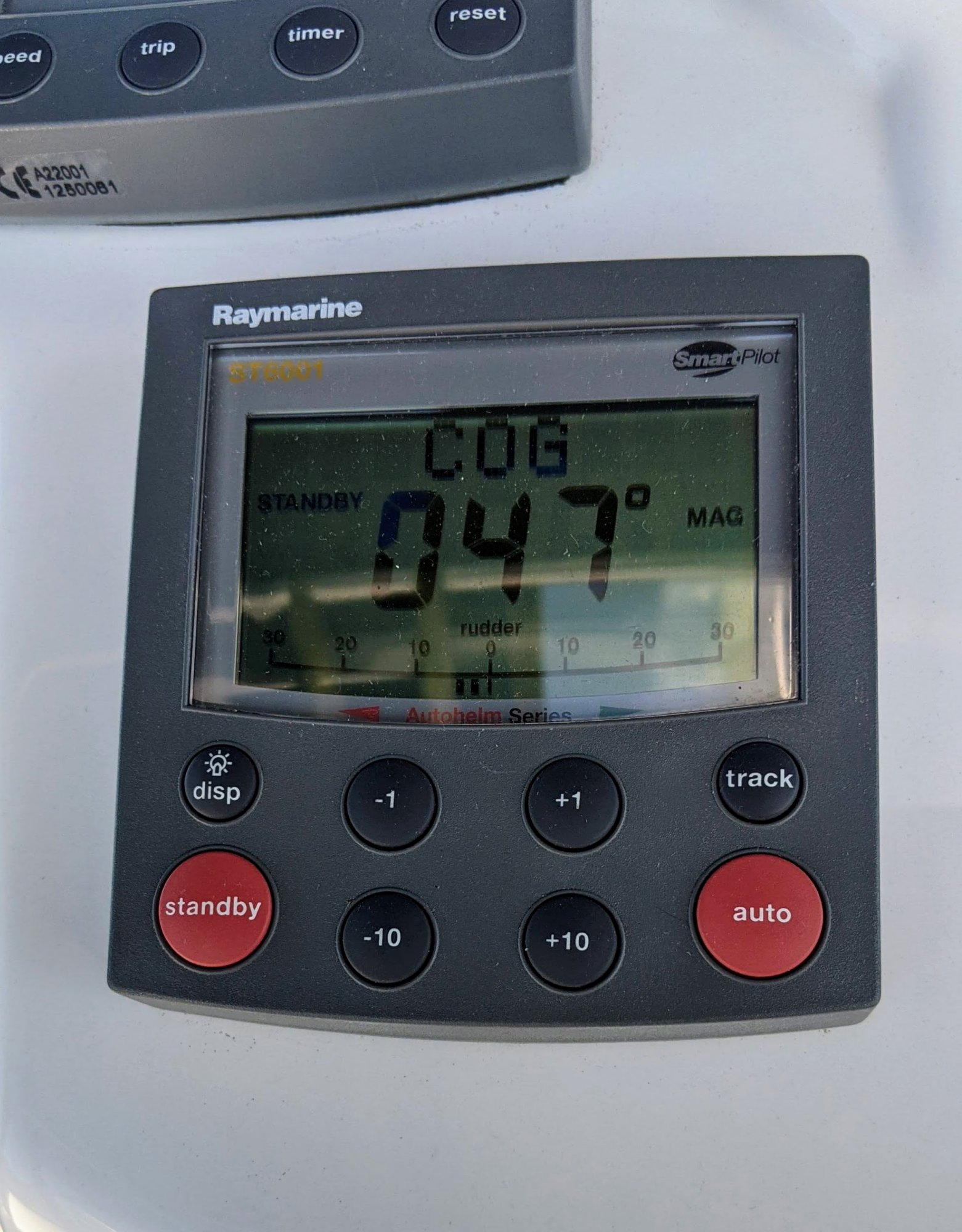

I have a 2006 Raymarine C80 Display and ST6001 Smartpilot Controller. I have had an intermittent problem that shows up randomly. The C80 Display, boat compass, and the COG reading via the ST6001 all show the correct heading. But, the "Standby" direction on the ST6001 is way off and seems to be stuck in a range from 59 to 63 degrees. Why would the COG and Standby on the ST6001 be showing different directions? Any help would be appreciated.

I'll take a wild guess. The COG is GPS derived on the C80. Could the Standby course be derived from the fluxgate compass which may be malfunctioning?

Any chance you have a metallic object near the flux gate compass? Cog is likely being determined via gps. If the flux gate has a metal object (or energized wire) nearby it will show a relatively fixed direction.

Thanks to shemandr and twalker H260 for the responses. The "standby" worked fine yesterday but after anchoring out last night, it was acting up this morning. I ran the generator this morning but nothing else changed; nothing different around the fluxgate compass. I am not real familiar with the fluxgate compass. Do you know if that is something that could have an intermittent issue or would it typically be fail or no fail?
