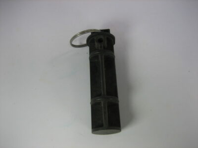

These photos are from spare in the box ST60 speed/temp sensor, blank, monitor and cable. The 2 photos on the left are front and back of the cable tag. Oddly the blank looks exactly size the same as my installed blank.
