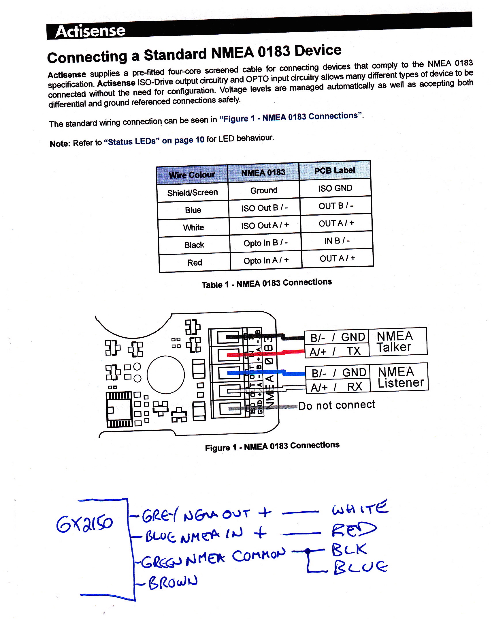

You have to pick your time to call them. I needed an Actisense converter to make the gx2200 talk to the network, gps into the go, and ais out. It seems to work fine, gps for sure but we haven't been near an ais target and for whatever reason they aren't outfitting the Pelicans.

Which actisense converter? Could you educate me - right now I have the gx2200 hooked up to the 0183 port of the MDF and it causes the screen of the MFD to constantly flash. When cable is disconnected flashing stops. I am using the MFD's internal GPS but want AIS from the gx2200. What am I not understanding or doing wrong?

I've plugged the Actisense into the itc5. It converts 0183 to STng. I'll look up the part number when I get to the boat in the next couple of days. The one I got has a pigtail out the GX2200, and a shorty cable ending in a Ray device end that plugs into the itc5 as a device.
This was suggested by Ray support and it worked great out of the box
Here's the page from the manual with the details of how the Actisense is wired. I have the NGW-1 version, and the specific one is NGW-1-STng. Plugged in, and after setting the config in the radio, it worked the first time.
