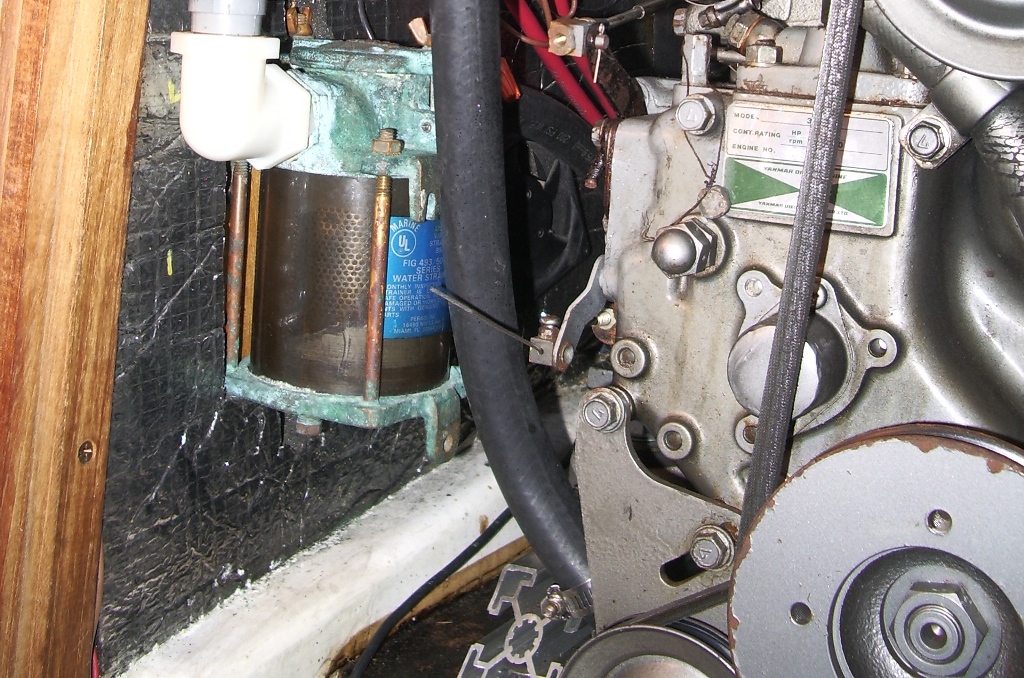

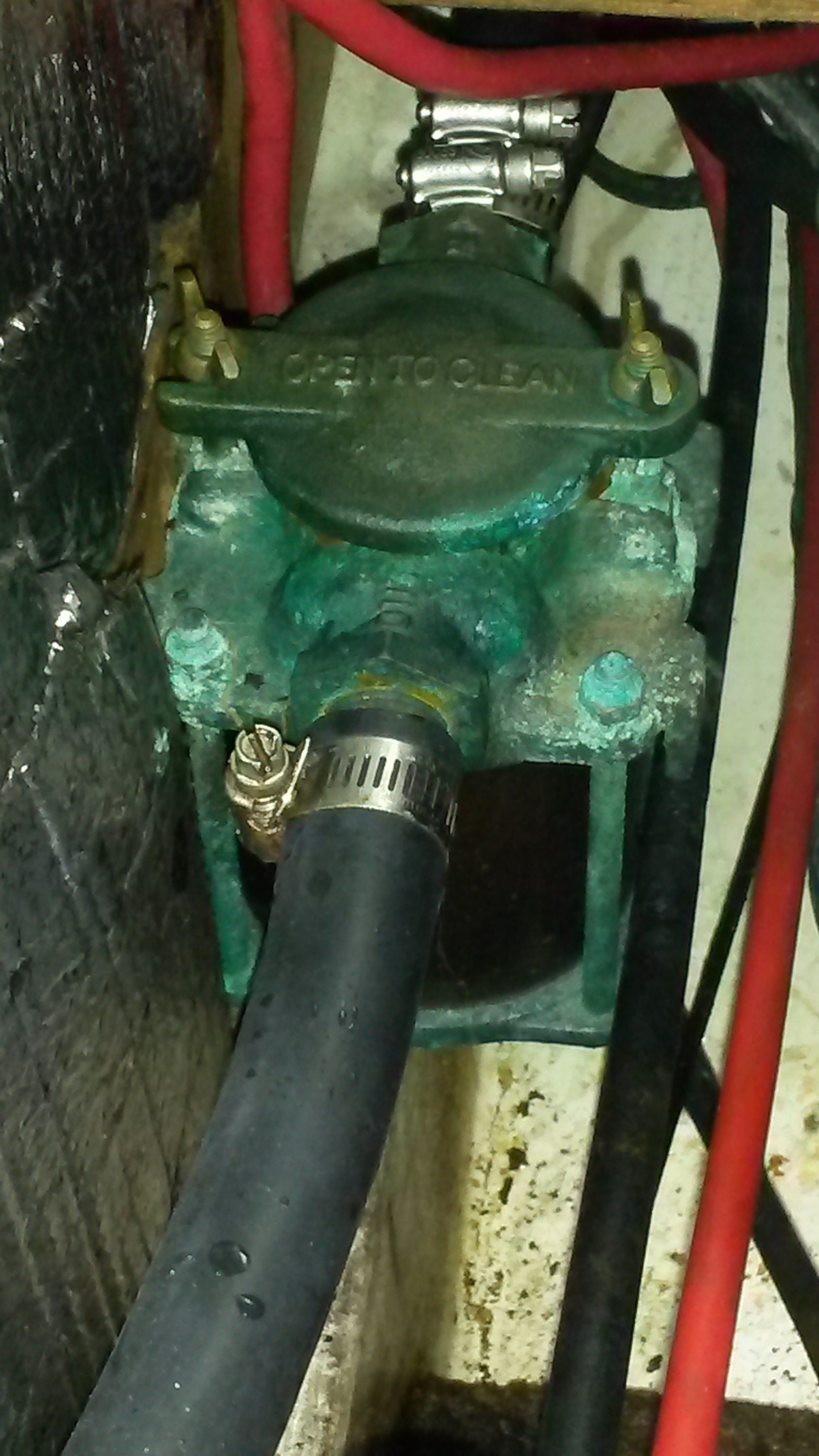

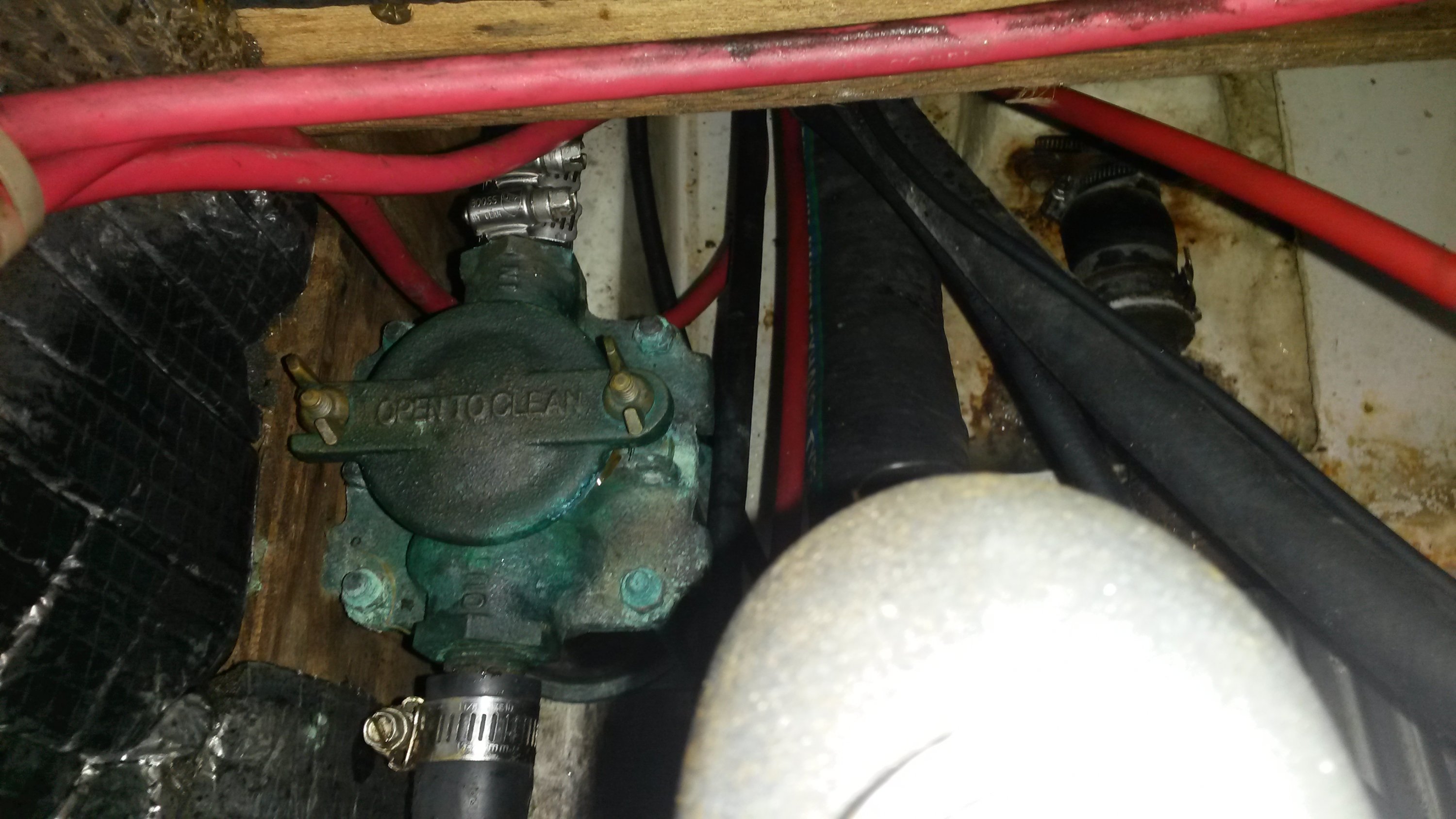

The raw water strainer on my Hunter 34 needs a new gasket for the top cover. It's a special thin plastic gasket shaped to fit the labyrinth seal. The engine is a Yanmar 3GMF, and the local Yanmar guy suggested just making a cork gasket, but looking at it I'm certain that won't work (he hadn't seen the actual strainer). I'll try to get out to the boat this afternoon to take a photo of the actual gasket and inside of the cover.
Can anyone make out from the photos what make this thing is? I can't find a name on it anywhere, looking with a flashlight and a mirror.

It is a PERCO 493 series.. They can use a simple flat neoprene gasket or the original cork gaskets.. all flat rings. ya may have to take a couple of measurements to figure out which size "0493" it is; I think size 5 but I would not trust that.. I rebuilt mine a few years ago and don't remember the size. I am sure Phil and the gang here can get you the parts.. give them a shout.
http://shop.sailboatowners.com/prod.php?12723/493+Series+Intake+Water+Strainers
This is probably what ya need, but try Phil here on site for them:
http://www.defender.com/product3.jsp?path=-1|51|2234255|2234260&id=1313032

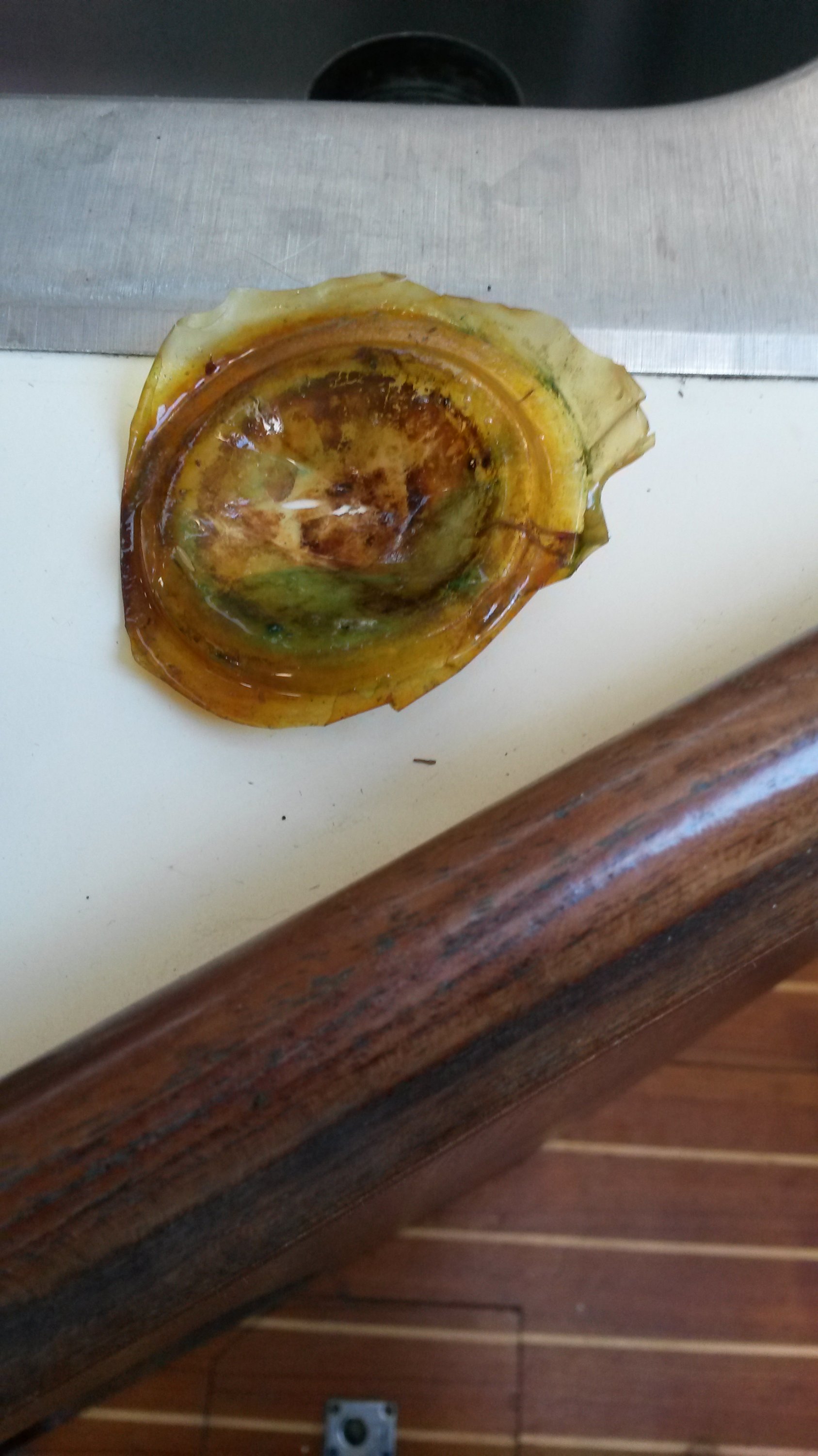

So the thing that I thought was an elaborate formed gasket appears to me now to be some previous owner's bubble gum attempt to seal it. It's a thin piece of plastic maybe 0.020" thick that got formed in the shape it did by being crushed between the cover and the strainer. With time, it took a set in that shape. I'm attaching a picture (apologies for the quality).
I didn't think I could make a gasket because I was thinking of a full disc. I can see now (and from seeing the ones in the links Kloudie posted) that a narrow ring will work fine. Off to the auto parts store this afternoon. I'm going to see if I can buy some neoprene gasket material with a bit of stickum on one side. That way it'll stay with the cover when I open it to clean it. Which needs to be done A LOT in the waters around here.
