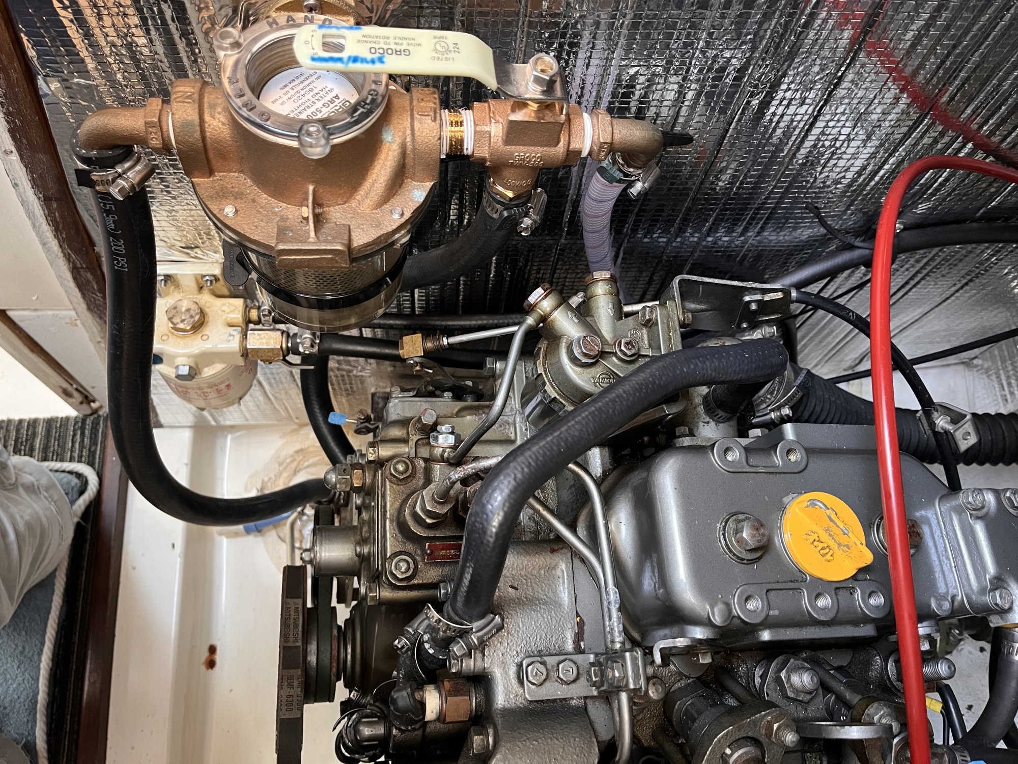

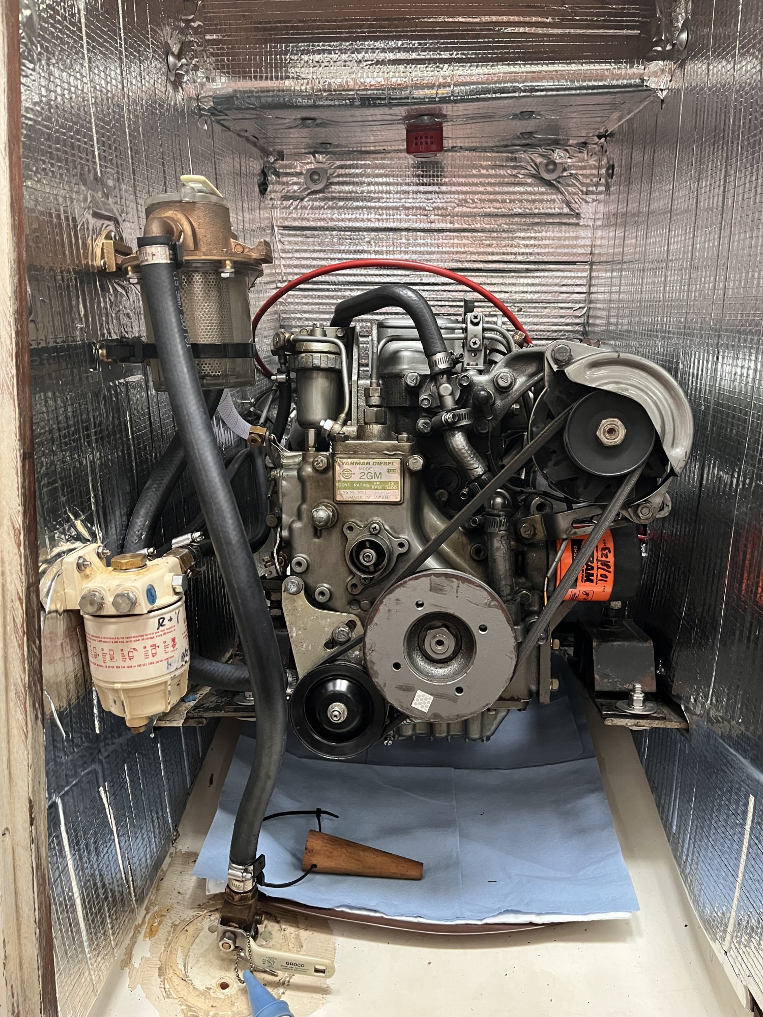

Definitely get the plastic strainer out of the engine compartment.
Here is my set up. A bronze Groco strainer with the top about 2 inches above the at rest waterline. I opted for a stainless steel strainer basket rather than plastic. No priming problems for my Yanmar 2GM engine’s pump.
The 3-way valve on the engine side of the strainer is my winterizing hose. The hose extends into the bilge where it could assist as an emergency bilge pump if ever needed. I just stick the hose directly in my antifreeze jugs.

Great idea! Is that foil lined bubble wrap that you're using for insulation?
It’s engine room acoustic insulation. Surprisingly heavy and very effective. The old foam insulation was crumbling and I had the engine out in 2014 for transmission work, so it was good time to replace it when I had easy access.
