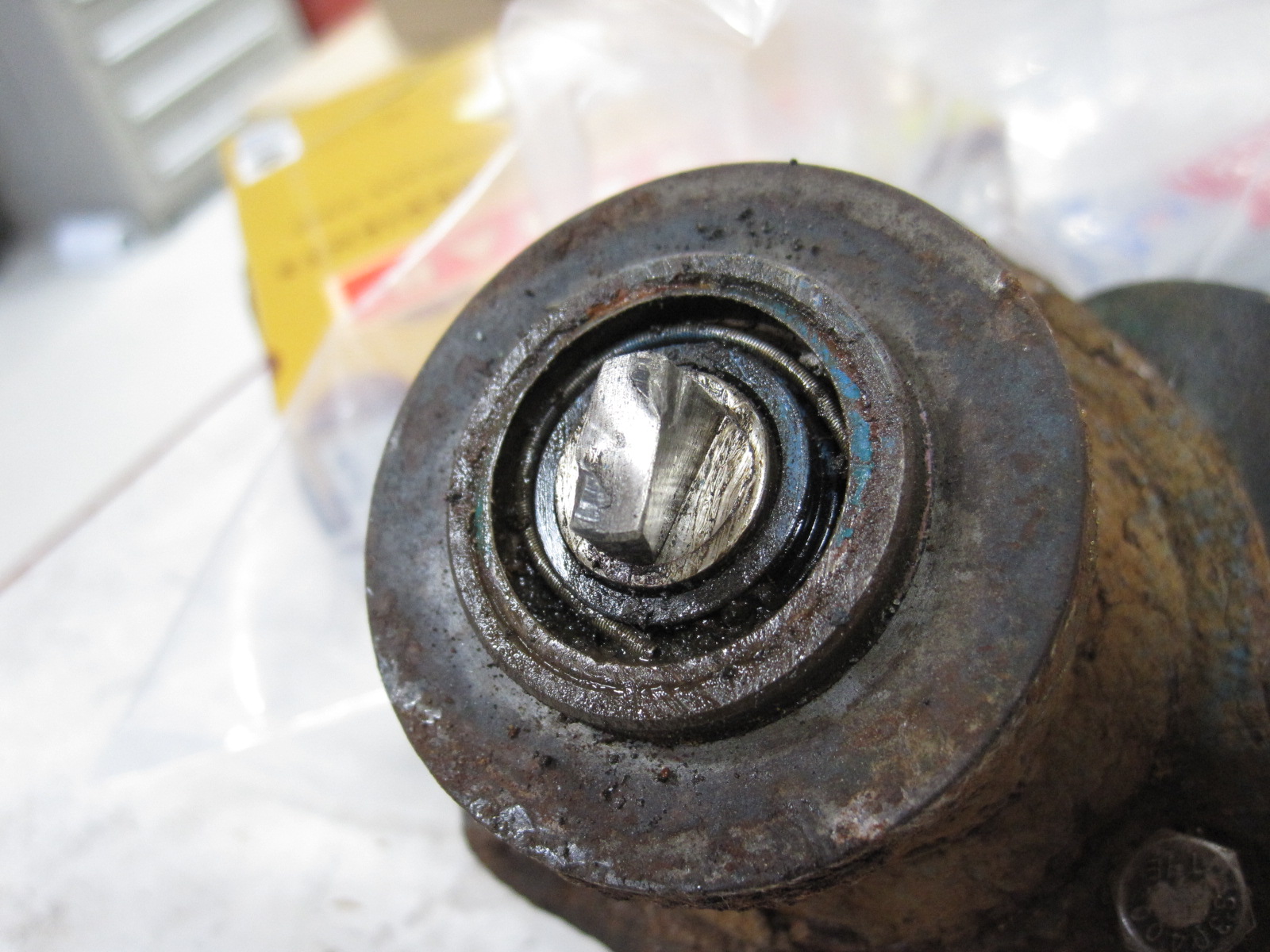

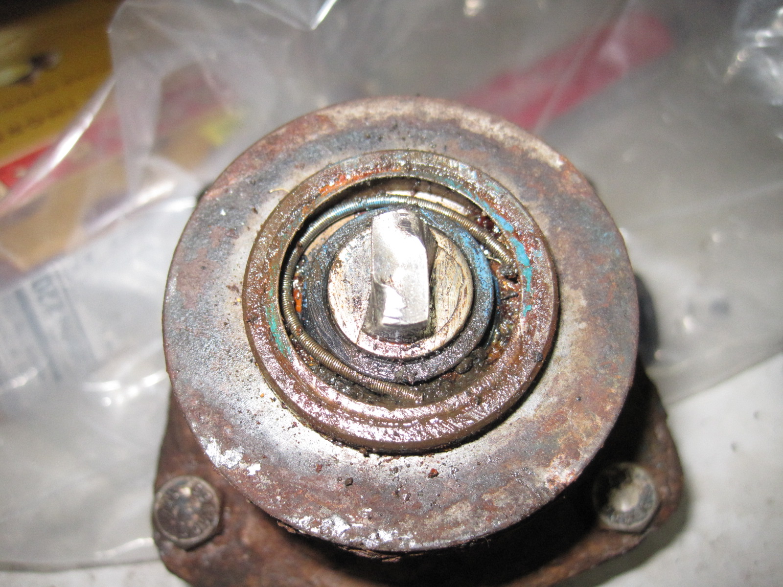

I removed the pump housing complete, to find the drive end twisted, and unable to turn the shaft in the pump even with a wrench on it. Frozen bearings or whatever, time for a complete pump.
The end of the shaft where this engages in the engine looks good and undamaged, luckily.
Lesson for me- don't assume the impeller is the whole problem, make sure the pump is turning!

Yeah. That's had it. Appears to have seized and sheared off the pulley that the belt goes on. So, why do you think that happened? Did you make some kind of mistake installing it?

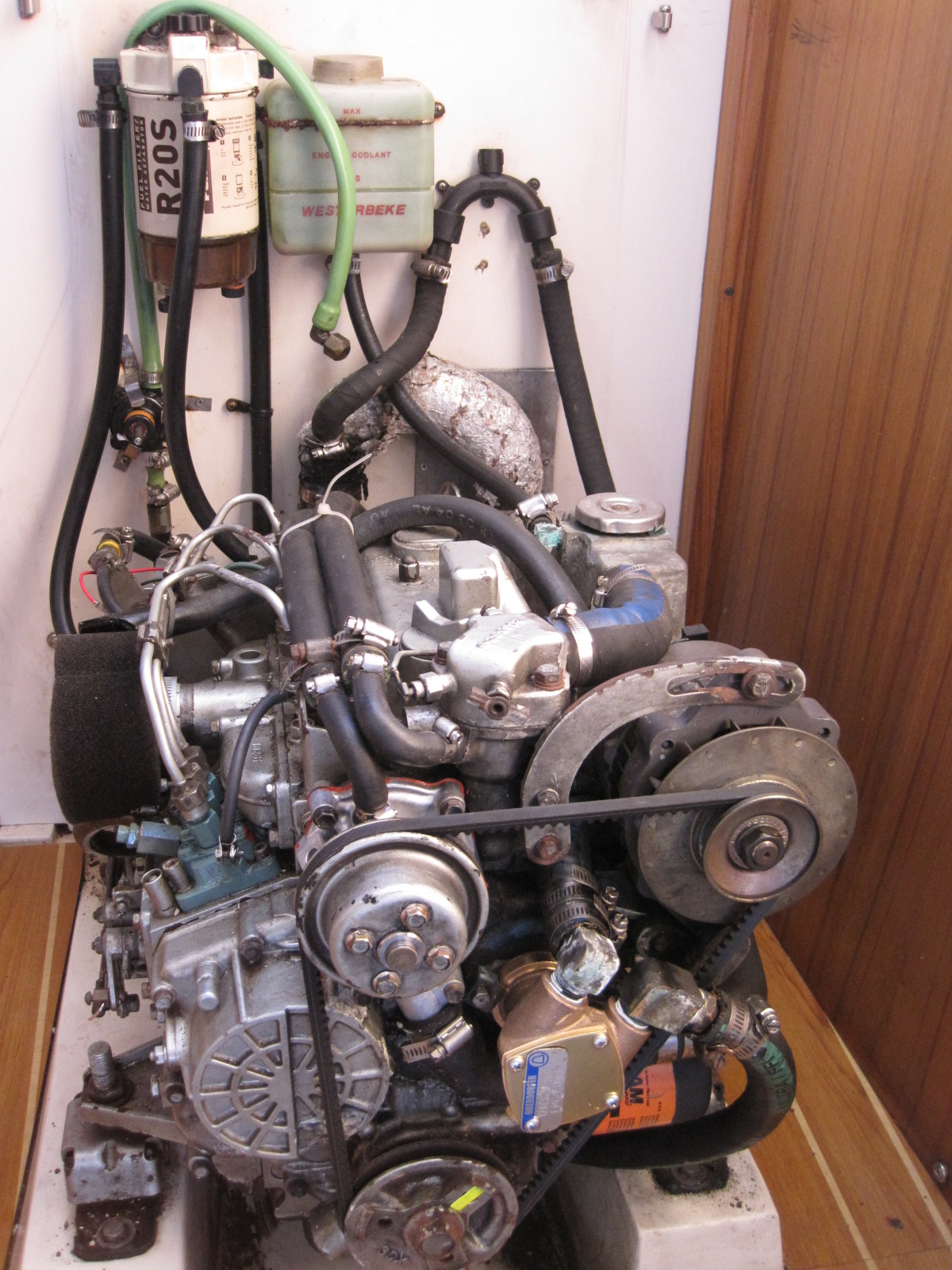

That is the drive end, it fits into a shaft in the engine, no drive belt on this pump. The fresh water coolant pump is belt driven, this one is the raw water pump.

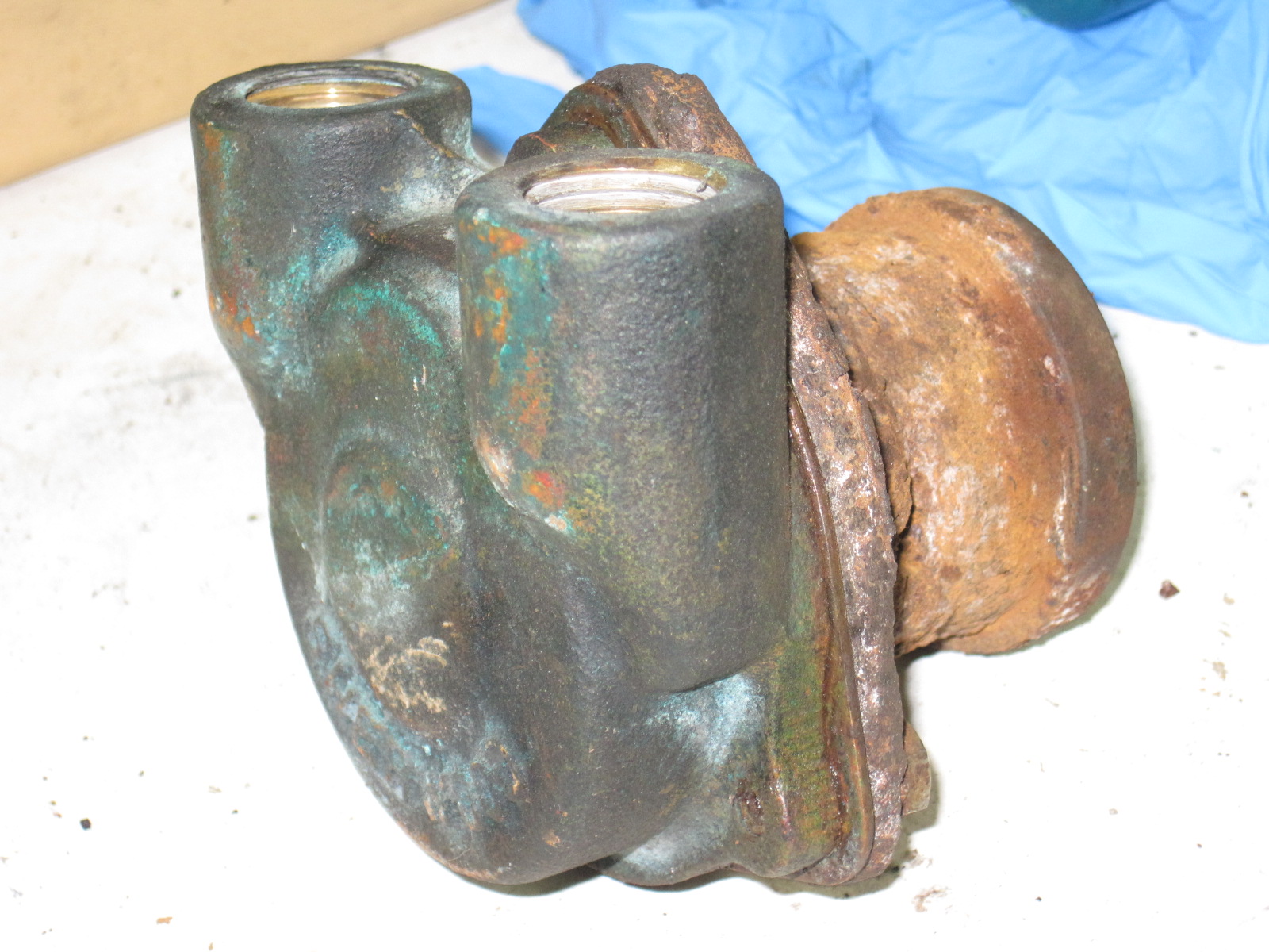

This picture is the other side of the pump, no belt drive.
Based on the corrosion on the rest of the housing, it would not surprise me if it was the original pump, with just impeller changes over it's life. All I have done to it was impeller changes since I've owned the boat from 2014. I never disturbed the drive end, so no installation issues.
Since the engine started life as a Kubota, other parts like the fresh water pump, injector pump, etc, can be acquired from Kubota suppliers. This raw water pump is not part of the Kubota build, so it is a marine part, costing more.
Times like this I REALLY appreciate the easy engine access on the 310! I'll probably take another 10 minutes and change the engine oil while I'm there.

Having that drive tang twist far enough to slip does protect the shaft in the engine to some extent. If the pump seized and the drive end didn't slip go it could damage the engine internals. On the airplanes I work on, many if not most of the accessories ( starter, generator, hydraulic pump, etc) driven by the gearbox use frangible drive connections to protect engine internals
The old one is too far gone for a reasonable rebuild, the shaft won't turn even with considerable force. Really seized up.
Pretty much all the internals would need replacing, and that's if the housing was reusable after forcing everything apart, it's not going to give up easily.
Maybe I'll soak it in rust remover for a long while and then experiment, but a new pump is on the way.

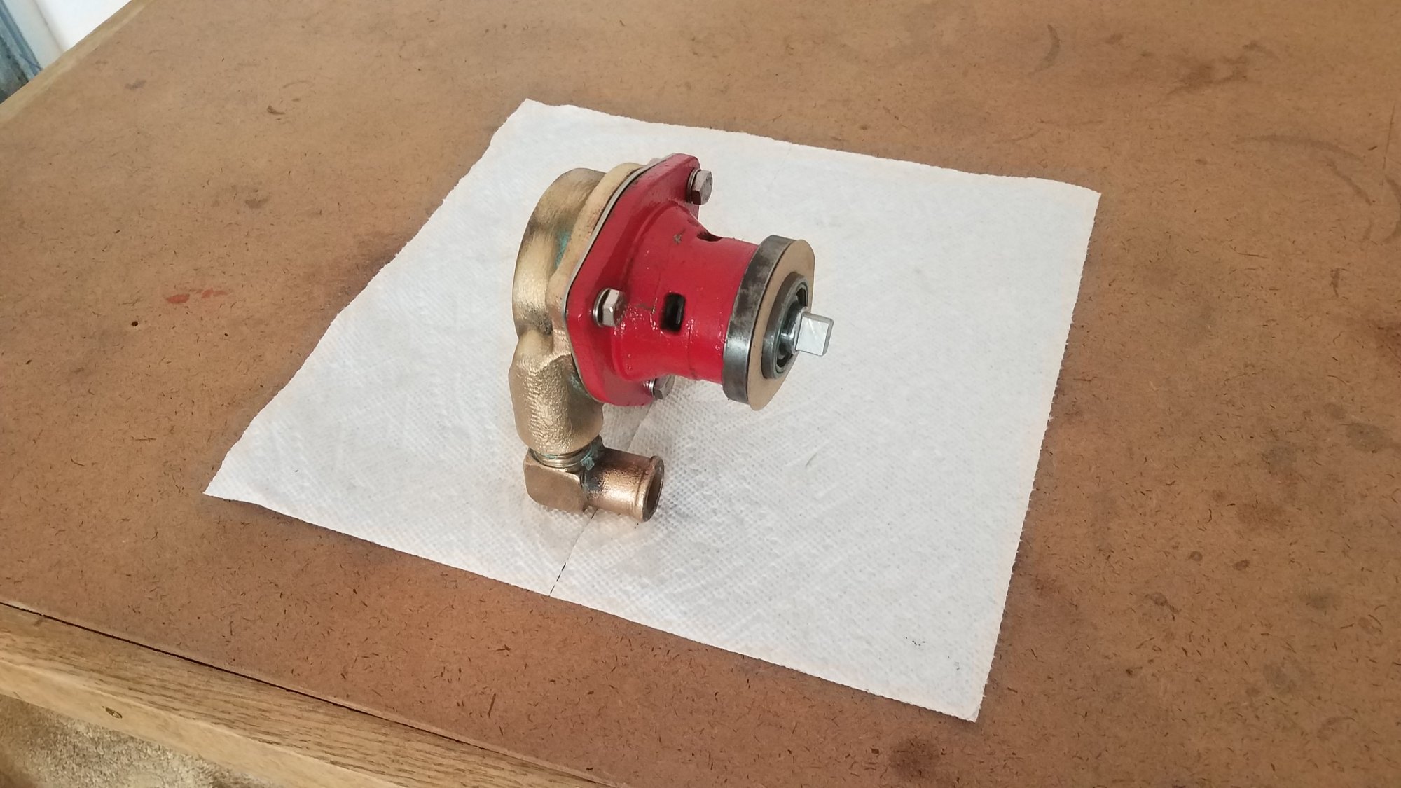

New Oberdorfer raw water pump arrived and installed. I had to fuss with the inlet fitting, it's pretty long and the spacing on the ports is closer than on the Sherwood. A small delay, the old inlet fitting is in two parts, just needed to be persuaded to separate then reassemble.
You may notice that the injector pump is a different color. It failed about 3 years ago, and a local industrial diesel shop that works on Kubotas had the parts to rebuild it in stock and did it for about 1/3 of what the Universal/Westerbeke supply chain wanted for a rebuilt.
Excellent! You'll really appreciate the Oberdorfer.

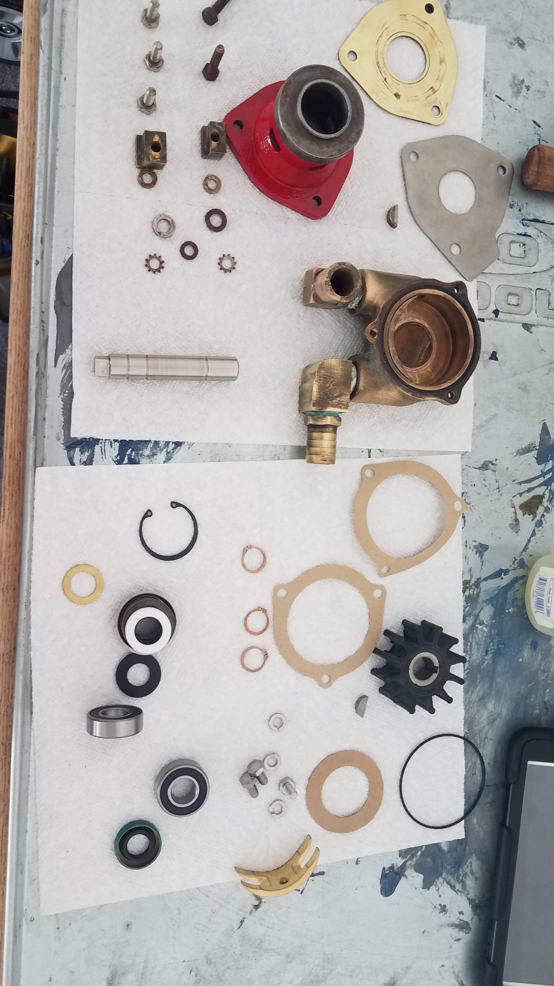

Yes, Oberdorfer. I had a leaky Sherwood and completely rebuilt it. Definitely not fun..many parts, some very hard to remove and replace. Vastly overcomplicated. It worked perfect for about 50 hours then started dripping raw water. I replaced with an Oberdorfer and could not be happier. I did replace seals in the Sherwood and, like you, I keep it onboard as a backup. I also found that the Oberdorfer is not quit a "drop in", but with a little effort you can make work. One of the best things is ease of annual impeller replacement. Sherwood rebuild below.
Likes: Tom J
