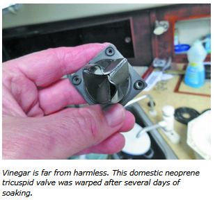

Vinegar should never be left to sit in the bowl because it's destructive to soft rubber --joker valves. A weekly cupful--MAYBE 2, but no more--flushed all the way to the tank, then flushed out with clean fresh water after 45-60 minutes will PREVENT mineral buildup in hoses. It CAN clean out a buildup, but it's too labor intensive--must be replaced hourly (the instruction that all the people who insist it won't work always miss),making muriatic acid a much better choice. Muriatic acid should also be rinsed out with clean fresh water after 45-60 minutes.
